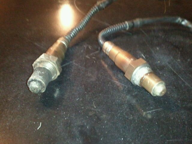

After doing some MAFComp adjustments this new sensor is working awesome.A little delay due to the fact it is in the rear o2 location, I will be moving it before the flex section in spring. On a side note, I was looking at the new Bosch sensor I got and I noticed that the new one had some kind of numbers on the sensor itself and the senor that came with my wideband from Innovate did not. Does Innovate use the real Bosch's or are they knock offs? It almost looked like a cheaper version of the sensor. Hopefully this one will last longer than a month.

Pic of the old sensor and new one.

The number is the correction factor needed to get a perfect reading. Your WBO2 sensor is too far back and it will make the heater run more and burn it out prematurely. 12-18" is the most common number out there, I like to get closer to the 18".

That makes sense. I will now be moving the sensor closer hopefully this week.
