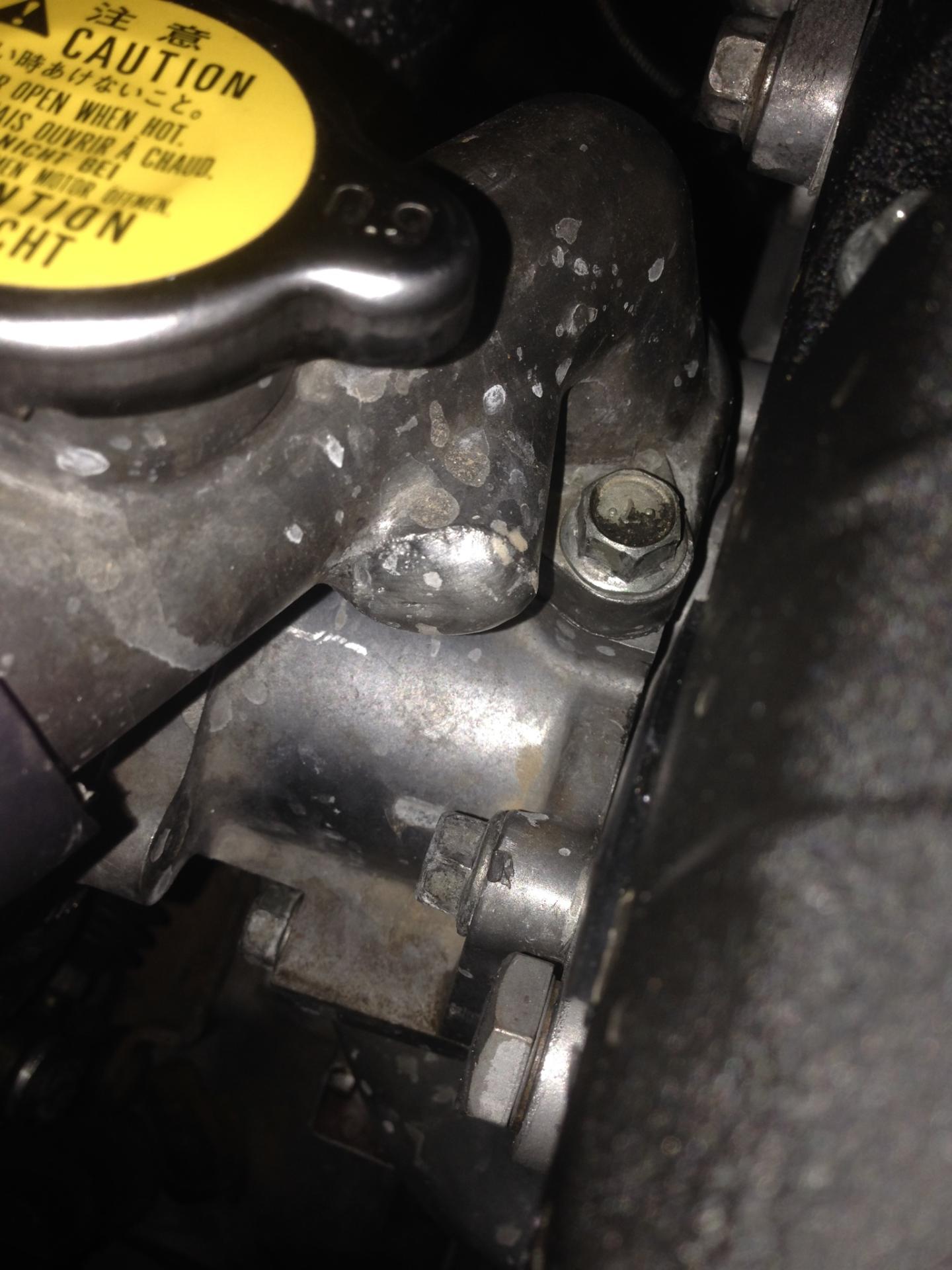

Here are the picts of what im talking about. And I haven't asked Shane Phillips personally but previous owner said shane did this to the car.

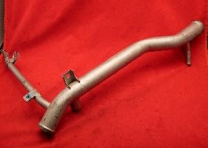

The end of the water pipe (red picture) is welded shut. The other picture is the weld of the thermostat housing that is actually on the car.

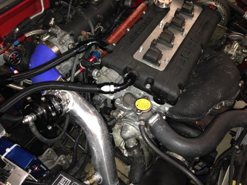

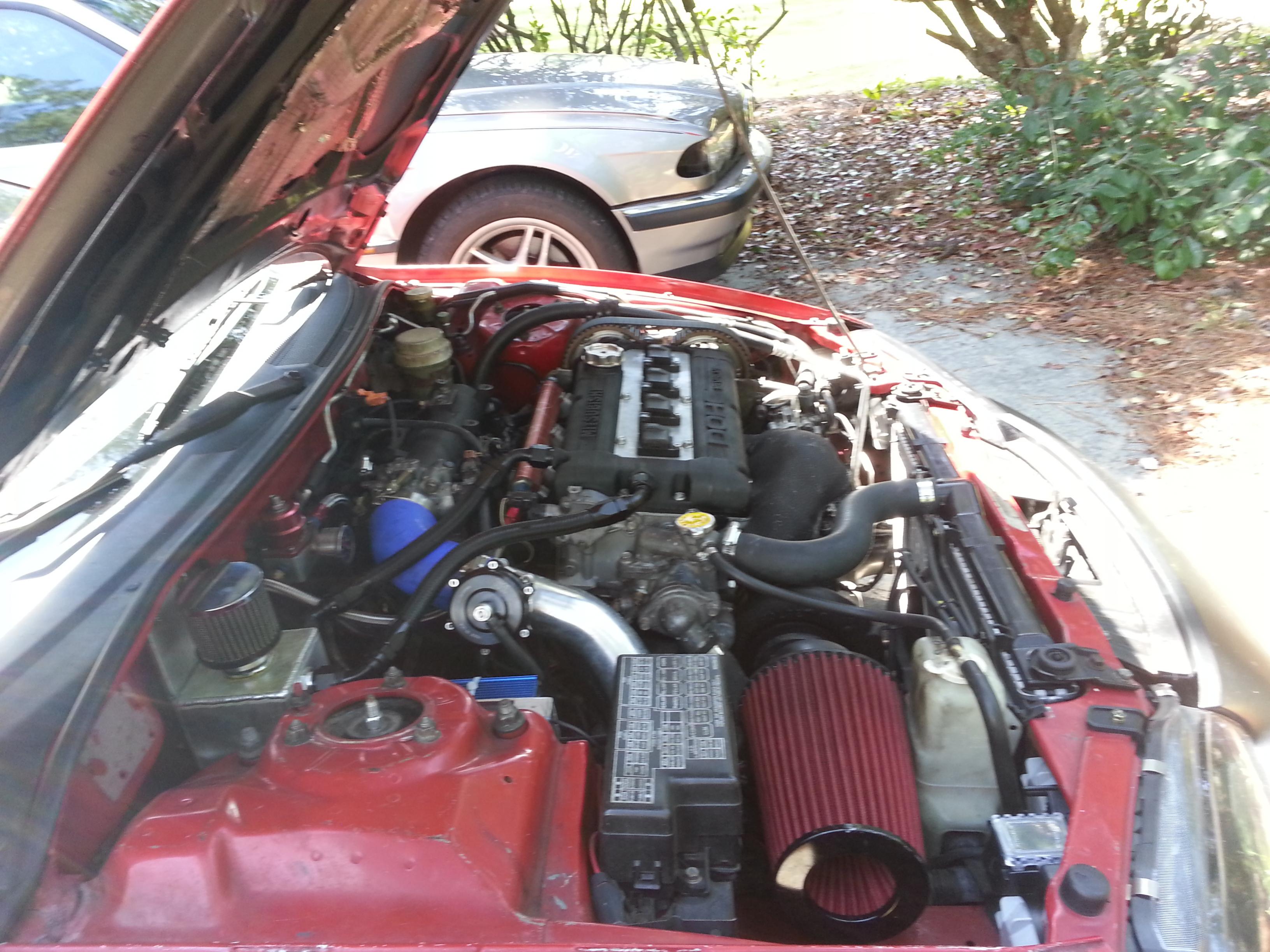

Here is the picture of the lower radiator hose... found a pict I took the day after I got it.

I must have clearly missed something here the thermostat housing in the diagram doesnt look anything like the one in the picture of my car? Or am i just not seeing it?
Is the one on my car from a different year or something?

120 for what the water pipe and t.stat housing. If so that is a total rip off. I have them posted in my clean up sale for 30.00
what youve pictured is that the turbo water feed system is capped off. why? the holsets don't use water jackets.
this will have no bearing on the problems you're having whatsoever.
