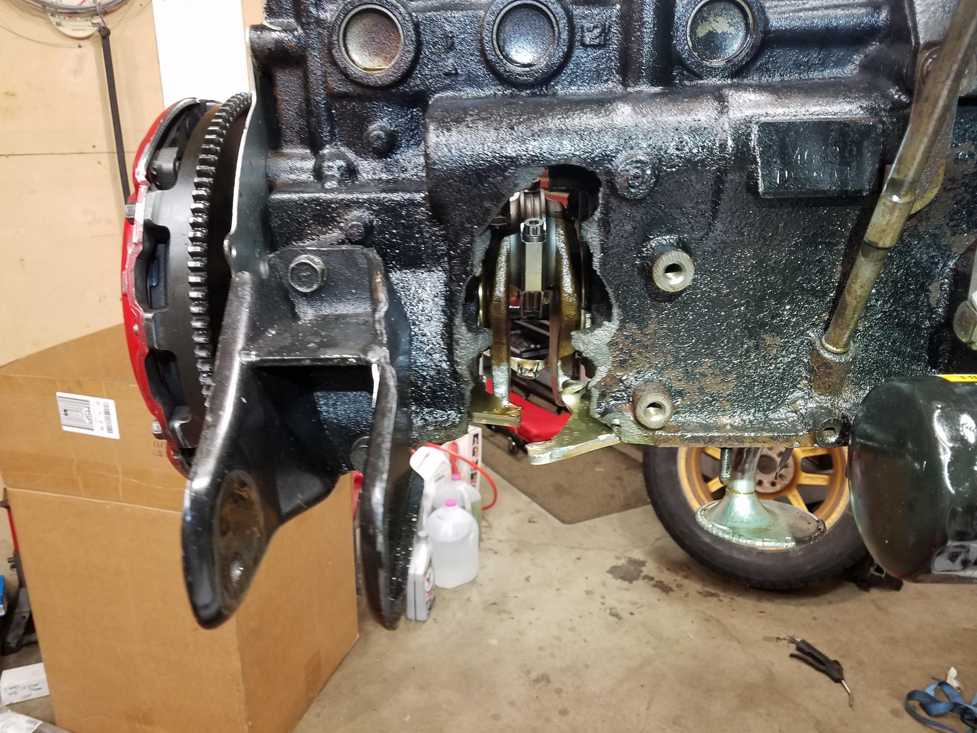

Well this isn't as good as that, but close. Clearly that's too much for the h beam eagles Johnny...

several of us want to know the how the rod failed? RPM/Boost? Time for I beam rods?

Boost/timing is my guess. I was asking alot out of them. 38ish psi, 9.5:1 compression, and still had around 11 deg in it at around 6500 rpm when it blew. Wasn't rpm, happened right as it hit full boost.
