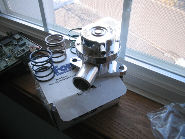

Well I just got her in the mail yesterday. I went with the cheaper one as I was starting to think the RS was overkill for me. It comes with 4 different springs for different boost levels. Red being the stiffest and should handle over 30psi. I think I'll be happy with it!
Old 02-24-2006   #11
Re: Forge BOV
Looks good! Thats nice it comes with different springs.
