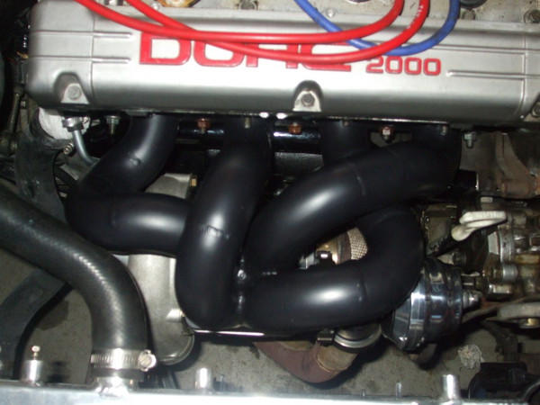

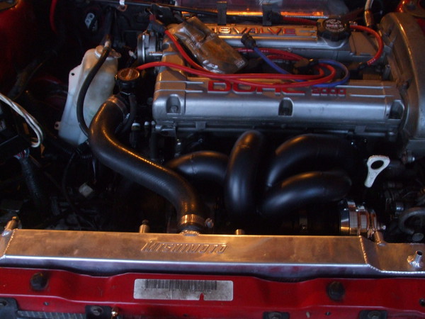

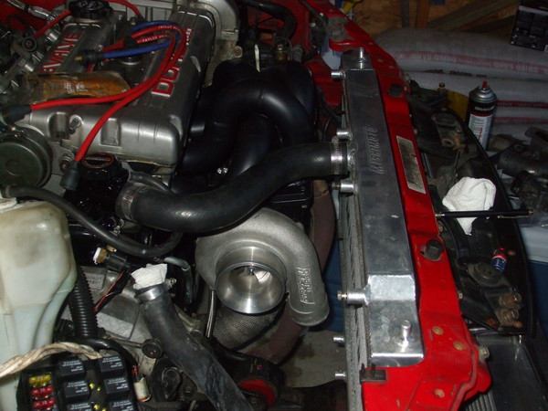

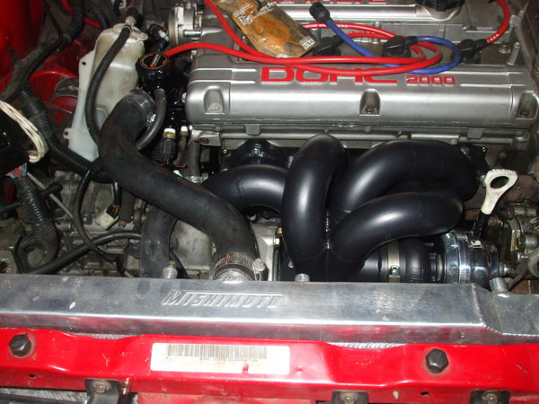

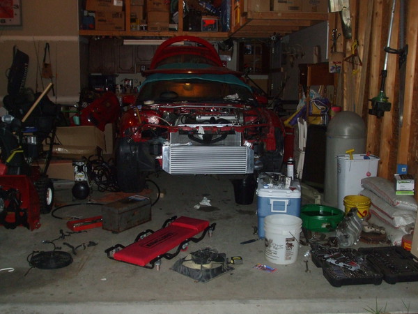

Ran into a problem with my radiator hose hitting the manifold!! Not sure what I'm going to do at this point.... Any ideas would be great!

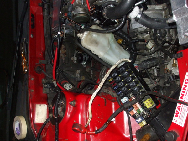

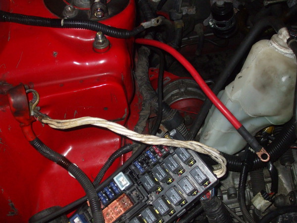

Working on the battery relocation. I HATE WIRES!

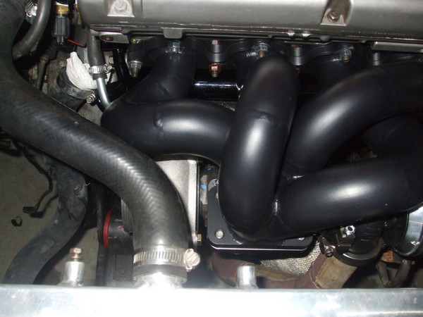

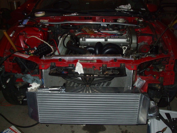

Some shots as the car sits as of tonight when I got frustrated and left it due to the radiator hose..

So you all are aware I am getting that dump tube ceramic coated as well and am just using is for mock up at this moment.

Re: GsXtUrBo98's 2G project thread
Have you homie J-funk, move the outlet on the radiator, its honestly a 10 min job.
Good luck, you gonna run some 11s at 140 this year? lol
Old 04-25-2011   #20
damn sucks about the hose. Wasn't an issue on mine since the hose connects to the radiator in a different spot on 1G's I guess. Might want to look into getting a custom hard hose welded up. Or move the radiator outlet towards the passenger side a little and maybe see if you can run a 1G hose.
