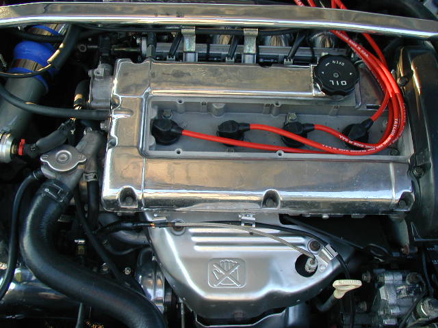

Onefast99gsx
Join Date: Sep 2004
Location: Wisconsin
Posts: 1,411
Re: shoulda done a 6 bolt
Mine is a '99 and it's the original cam sensor that's on the opposite end of the cam gear (passenger side) like a 1g -see pic of my engine
