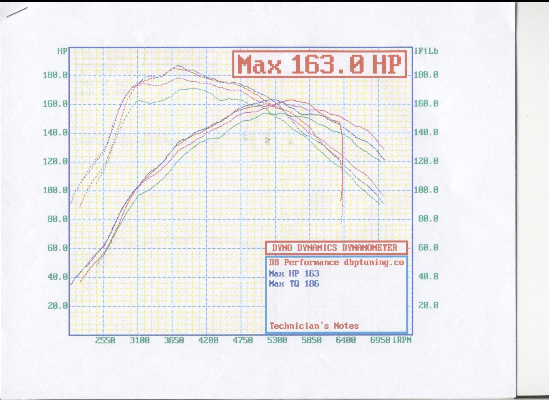

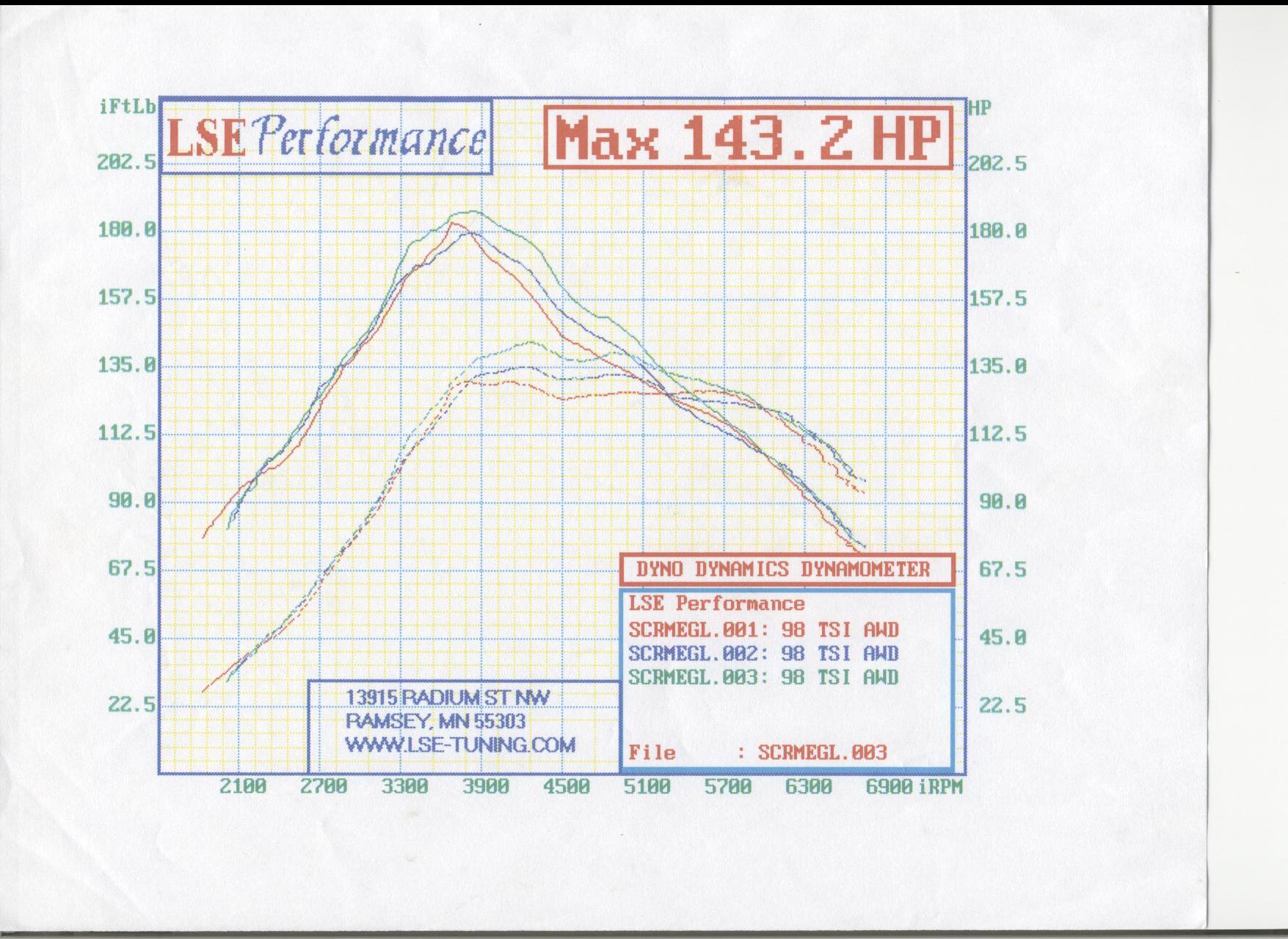

Well after a great event at DB for the Fall '07 Dyno Day I started to look closer at the charts and noticed some interesting numbers
Back in spring at LSE my car made 143.2WHP and about 181WTQ. It was listed wrong in the previous posts. My FPR was not seeing boost reference and a few other little things were not up to par. That was on 93 octane and about 18psi with about 21psi spike. The HP peaked at ~4000RPM and slowly tapers. TQ peaked like a mountain at 3800RPM then drops as quick as it climbed. I do not have the boost and AFR charts to compare.

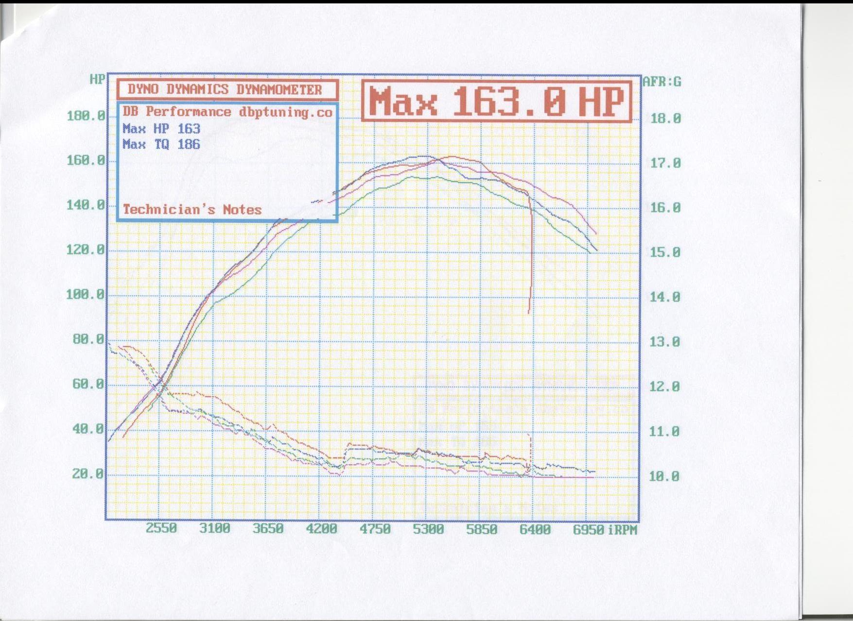

This fall at DB the only changes I made was the installation of a full 3" exhaust. I ran lower octane and lower boost 17 spike and 16psi steady and on not so great plugs. Max WHP was 163.0 and max WTQ was 186 with a slow drop after. Peak HP was ~5100RPM and drops slowly after that. AFR was on the rich side between 10 and 11.
I am new at interpreting these charts so it has been fun to dig into this a bit. I have since set a -5% on my high throttle fuel map on the AFC Neo and am guessing that will bring the AFR to stoich or close on full throttle.
Very low numbers compared to others but this shows a 19.8 WHP gain by doing the exhaust and minor fixes on lower octane and lower boost. Not bad I guess. I am So ready to get rid of the T-25!

Good post man! Glad you leaned it out a little, it was very rich on the dyno! Post up a scan/pic of your dyno charts if you get a chance.
I'd say the next thing would be a turbo upgrade. A simple Evo3 16g (MHI) would do wonders on your car. Just port the crap out of your stock o2 housing and the turbine housing of the 16g and run ~15psi at first. Get a set of Evo 8 or Evo 9 injectors (560cc) for ~$100 and stick them in, and get a tune. Your car will be WAY up on power and you will be LOVING LIFE!

Here are the Dyno Charts...

Re: Project Talon - Screaming Eagle
Stoich on gas is 14.7:1 and you don't want to be anywhere near that.
On the blue run, it looks like it pulled timing past 5300RPMs.
The learned part throttle fuel trims are also affecting the WOT fueling on those runs up to 4500RPMs, that is why there is that jump leaner there.
