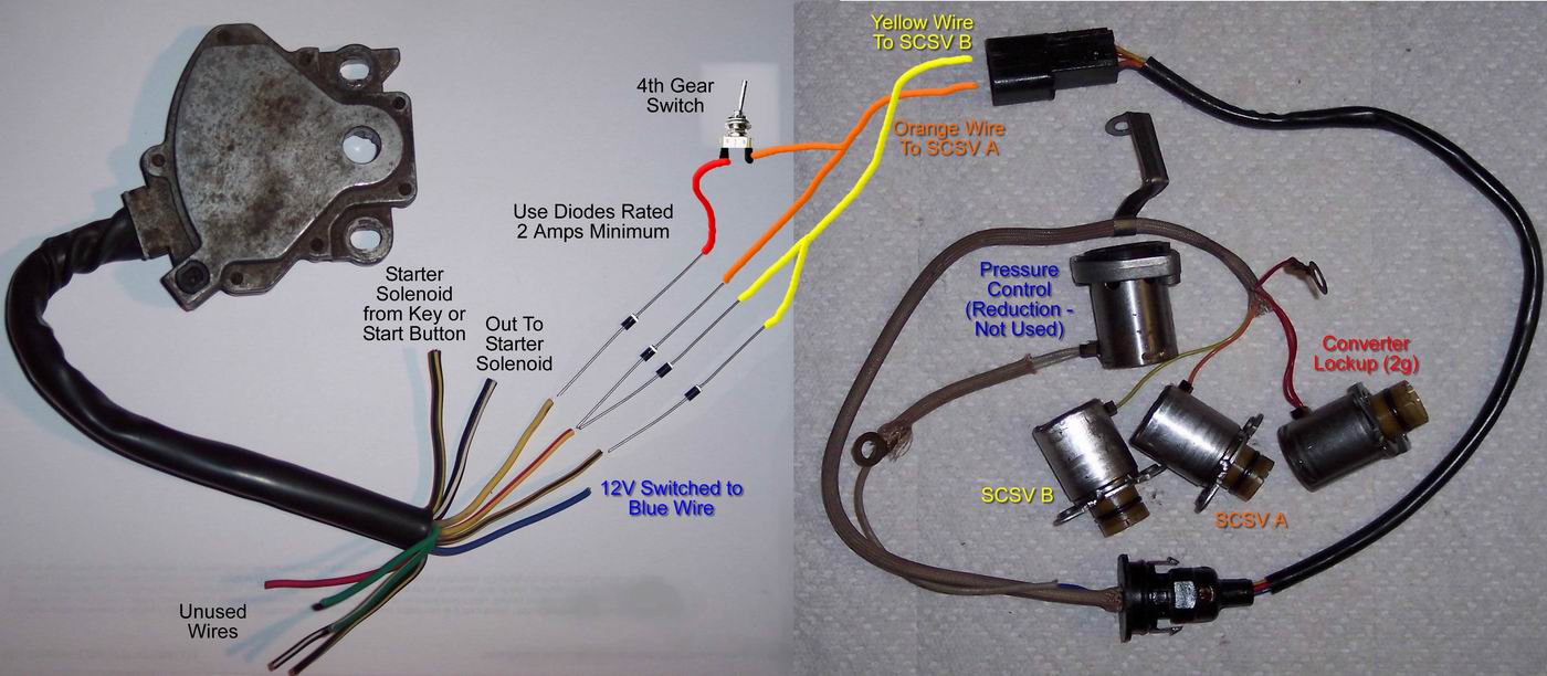

I've made alot of progress since my last update. The auto trans is all bolted up.I just need a few more things to button everything up. I desided to go a little different route then I originaly planned. I bought Goodharts Nitrous kit and will be using it to stall up on the stock converter. I also ditched the idea of using a reprogramed TCU for the Kiggly manumatic mod. The Manumatic mod eliminates the need for a TCU or shift box. You simply put the shifter in the gear you want and the trans shifts a full line pressure . I will probly go with a ratchet shifter whern I havesome extra money.

Pic of kiggly manumatic mod attached.

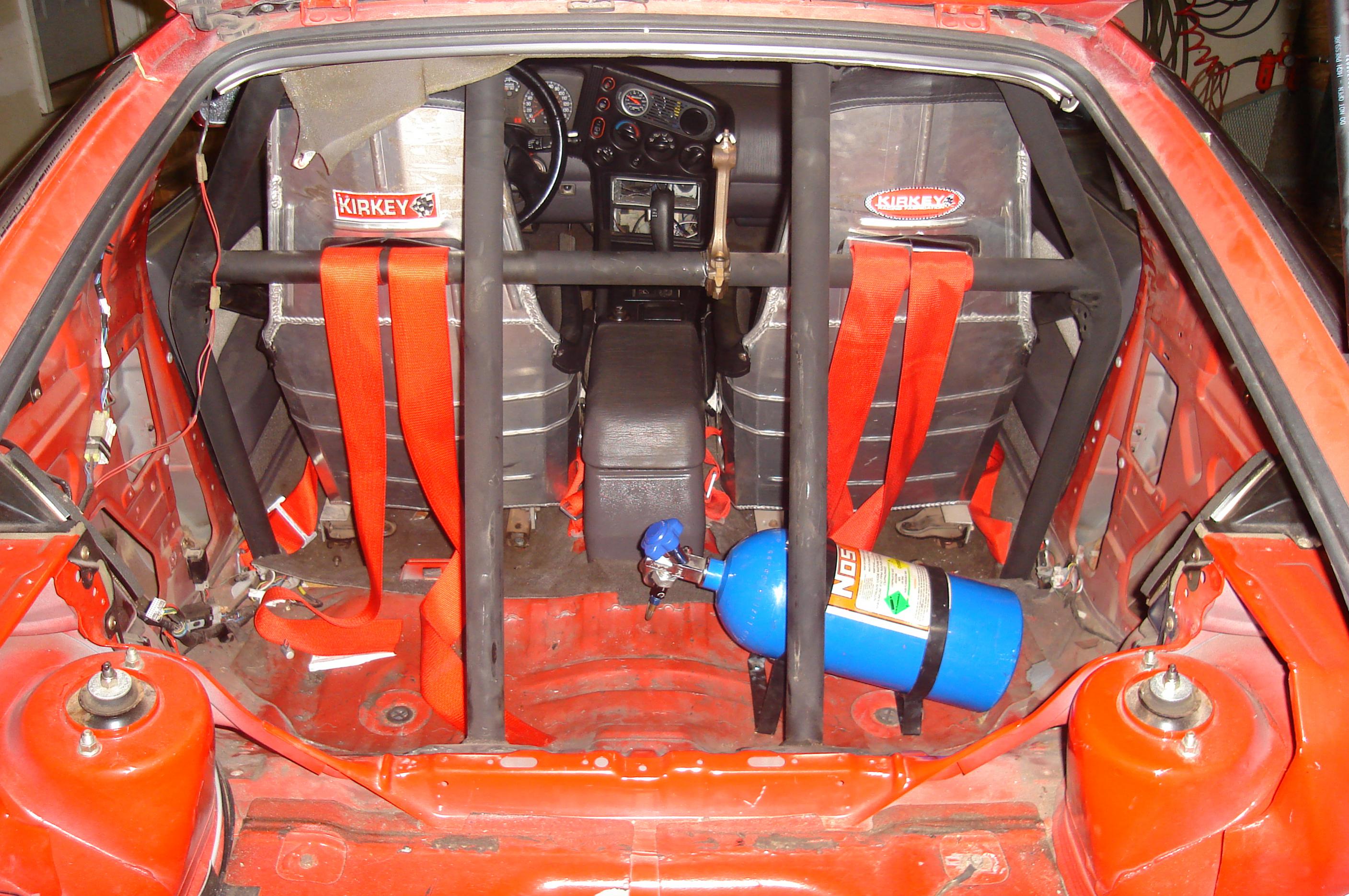

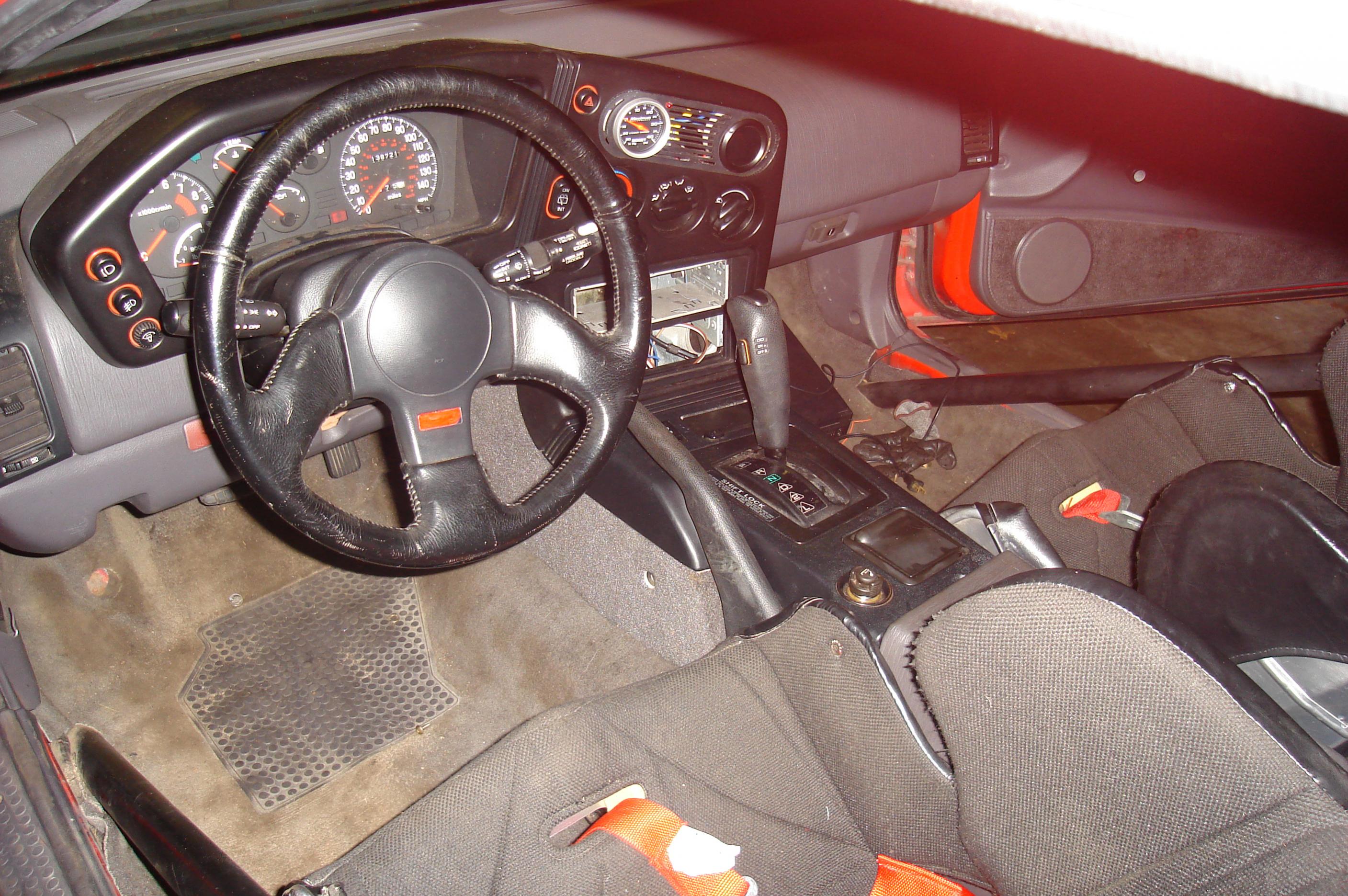

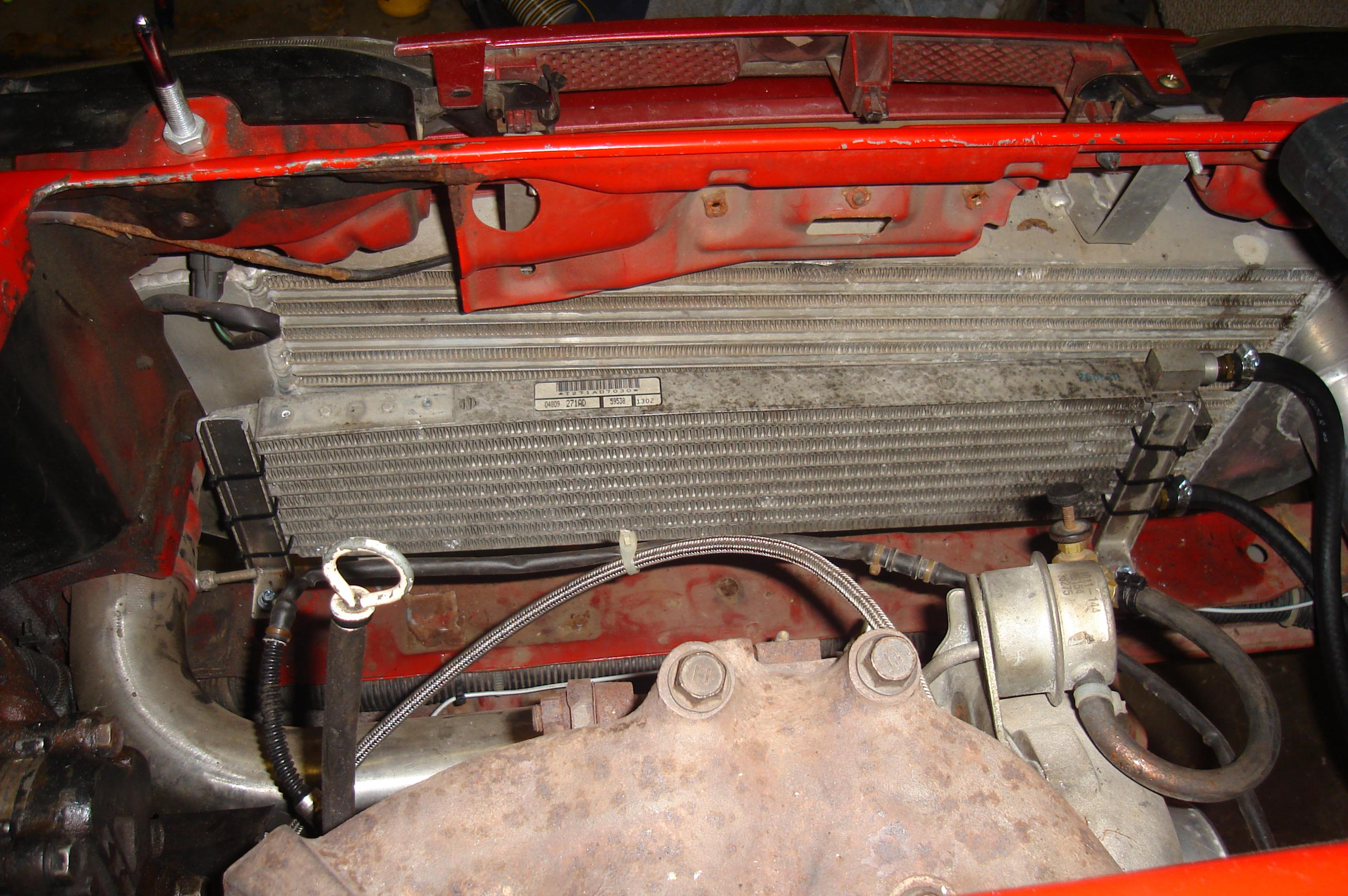

2:00 AM progress update. I got alot done today. I got almost all the wireing except for the nitrous buttoned up. I got the cooler installed and plumbed, and Radiator back in. Got all the interior back in (even got my cigarette lighter working for laptop charging etc.) And I got the nitrous bottle mounted and line run to engine bay. Not mutch left to do till its driveable.

With the pick up tube in the nitrous bottle you are going to want to angle the outlet to the back, not the front. Looking good.

I took the car for a test ride today and by the first impressions I am very happy. it shifts good using the kiggly manual mod. I did a few 20MPH to 100 MPH pulls going through 3 gears. once the turbo spoools the car pulls like crazy. Spins through first shifts into 2nd very fast and hard. Little to no wheel spin in 2nd. 2nd gear feels like it only lasts a second or 2. Shifts hard into 3rd. At this point I finally looked at the speedo as it goes past 80 MPH stayed in it a little in 3rd then let off.
