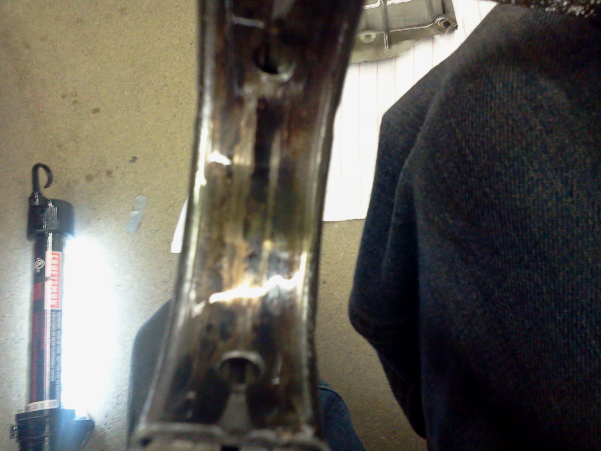

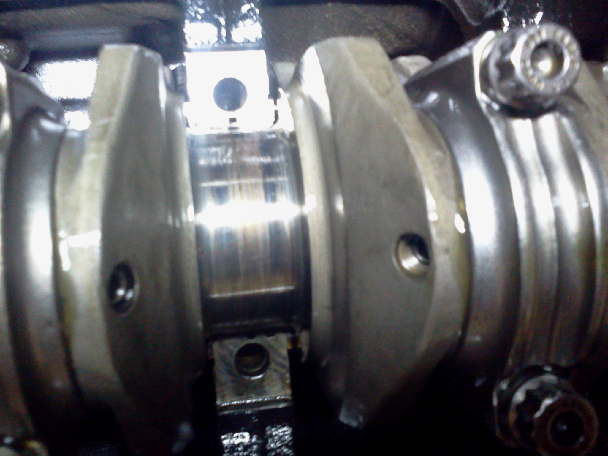

found some sparkle in the oil and heres where im at. got the head off and everything actually looks pretty good so far. i will pull the rest tonight

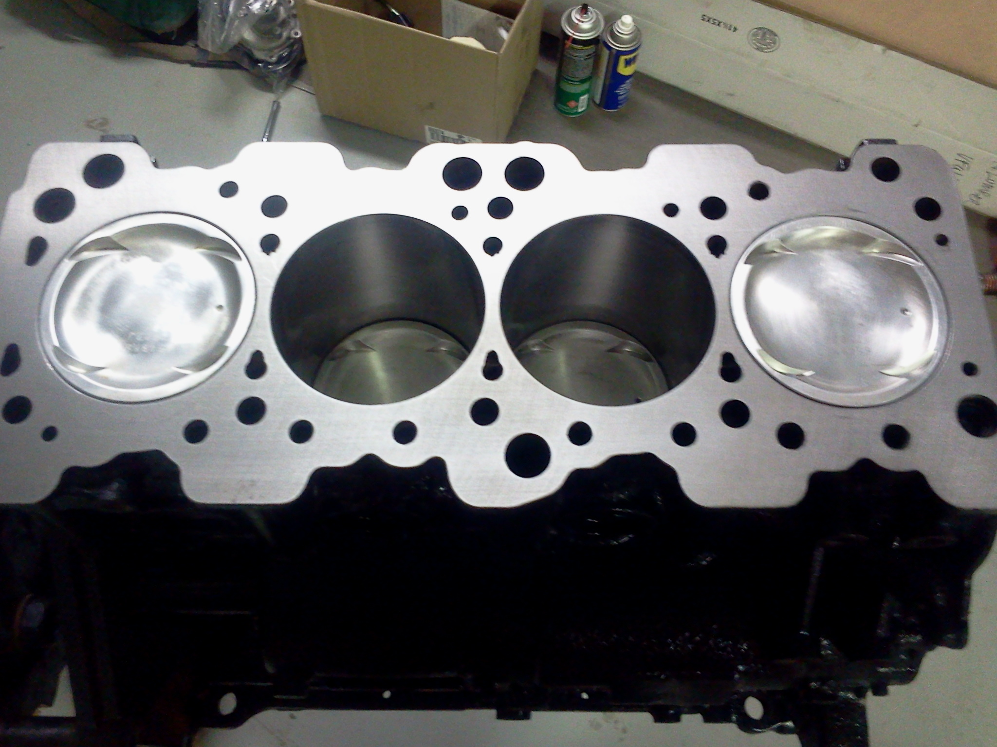

ok 2 days later and everything is out. no matter how hard i tried I still ended up with a bag of bolts. I was happy to see the rods and pistons are absolutely perfect. head and cams looked good. I am getting a good deal on another 2.4 block and crank, but I really wanted to go 6 bolt 2.0. Oh well for now I can build on a budget and still end up with the same engine I had and save some money. If I get this thing going by pg2 I will be very happy...

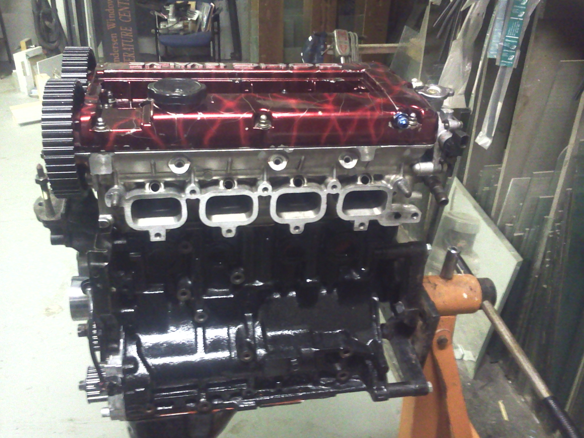

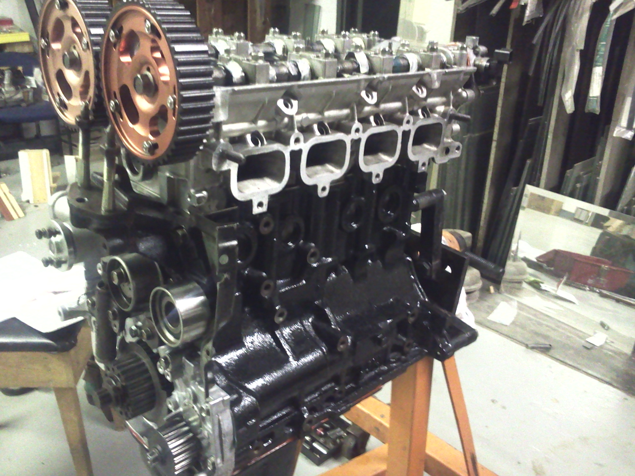

some update pics on the engine

thanks goodhart its looking like i should have it in the car soon.. 2.4 dohc 7bolt stock crank arp mains acl race bearings eagle rods weiseco pistons 87mm bore block and head decked cometic hg all oe gaskets and oil pump bse. 1g ported head ferrea stainless valves. sent my 3582r chra off to fuel systems in wi for the garret exchange 550 for a new chra. so far so good.

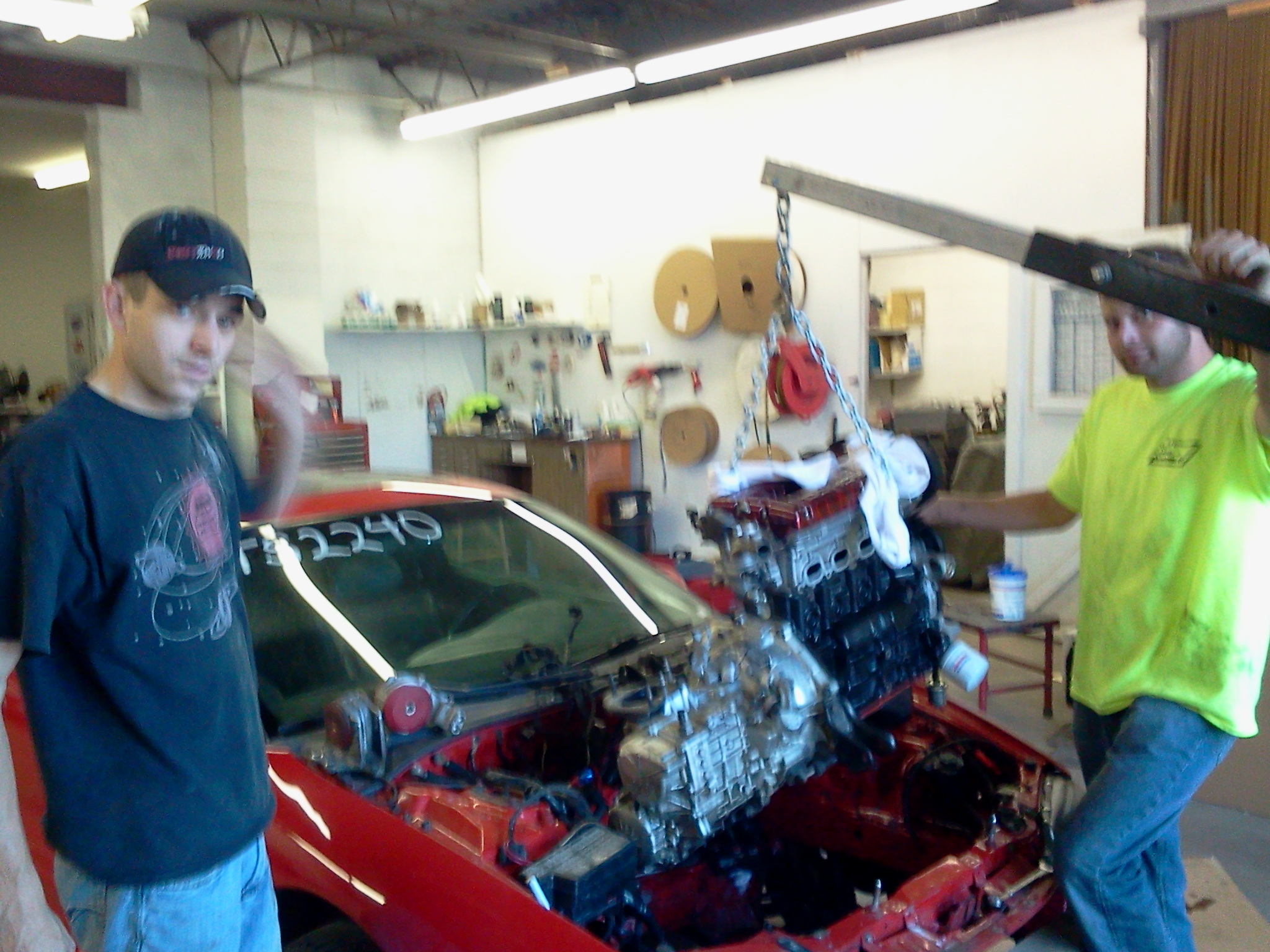

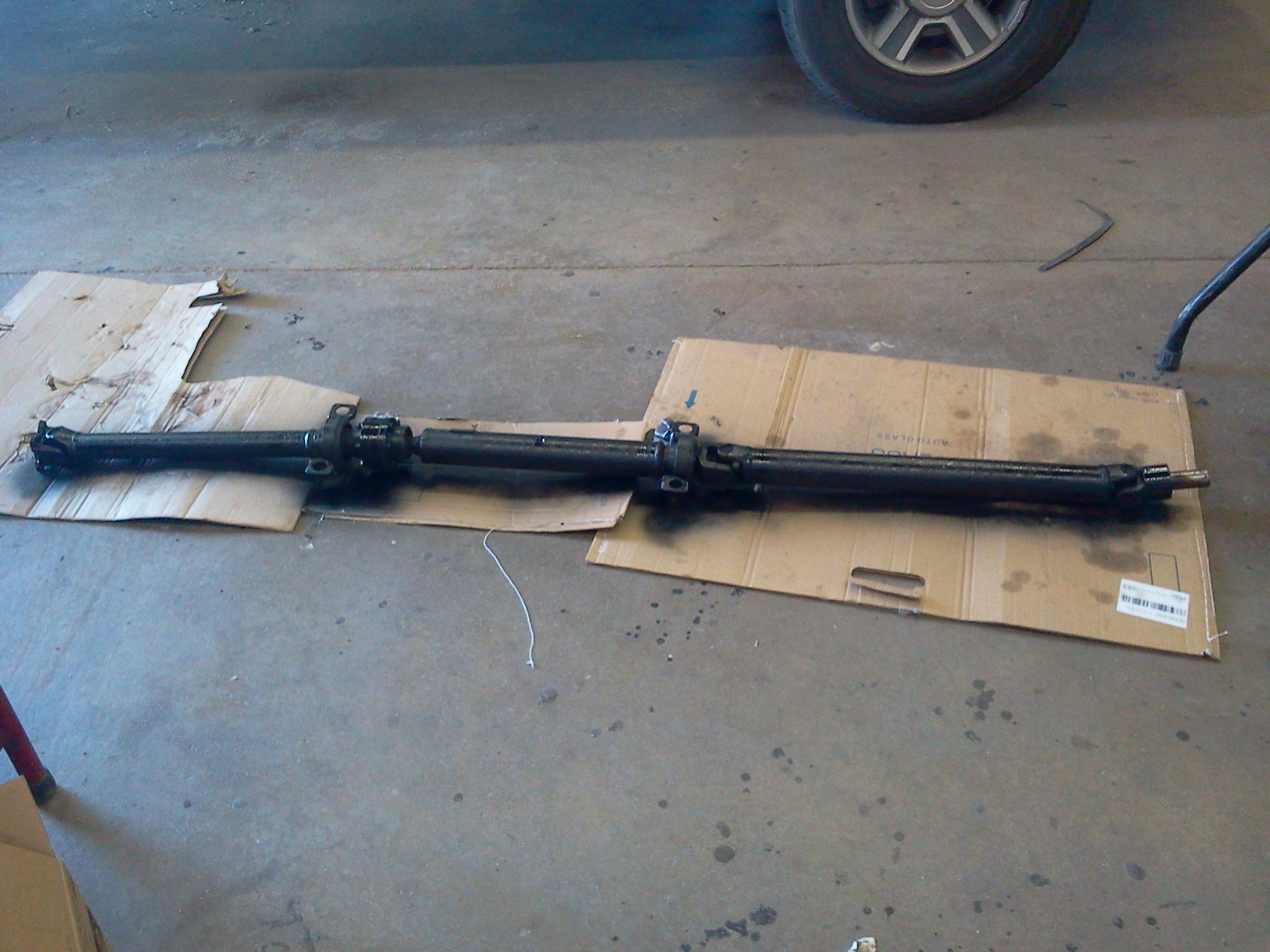

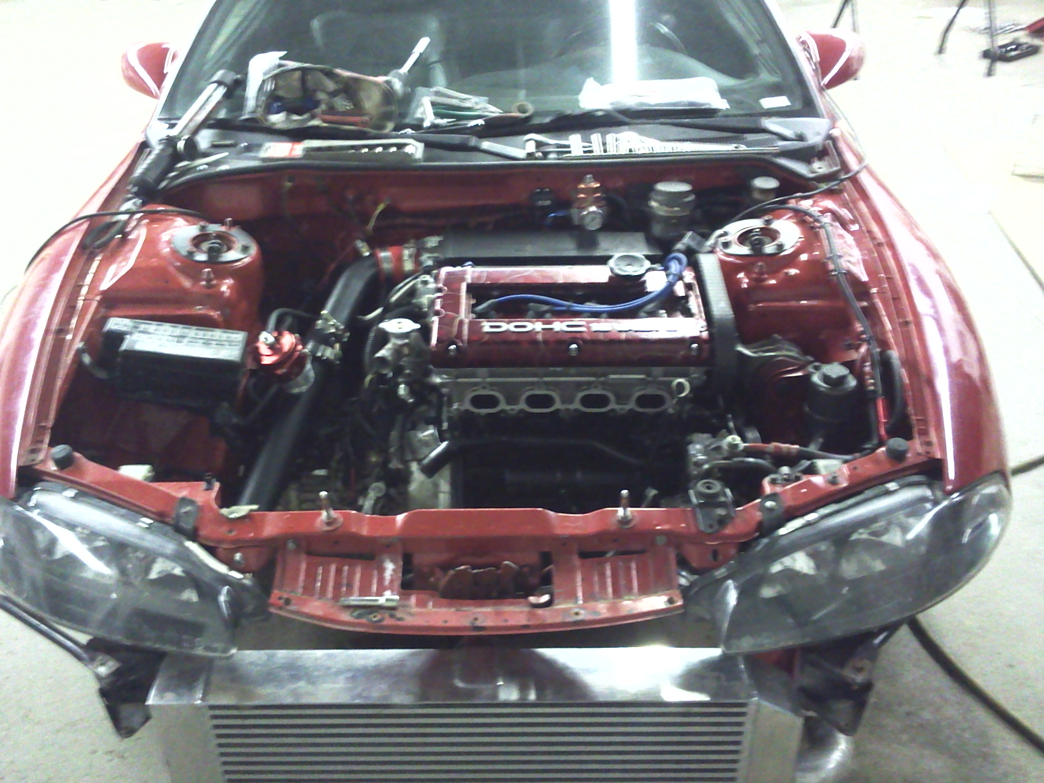

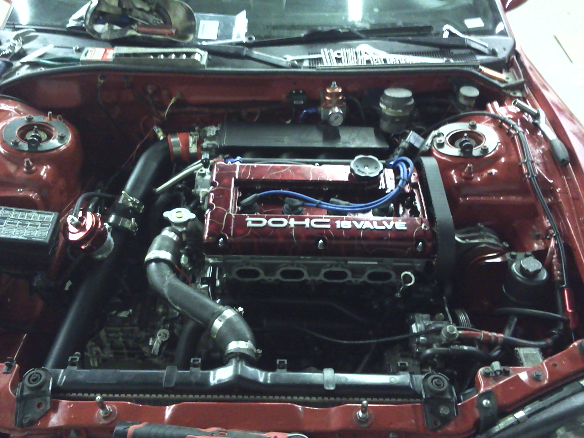

got alot done. got my driveshaft, oem shifter, and 3rd diff mount after finding mine was completely shot...engine, trans, and transfer are now in their home goes toi easy with three guys getting the engine with trans mounted in the bay... need a few bolts that i cant seem to find to keep rockin out. turbo should be here late this week ir early next weej...

Old 08-13-2013   #31
mark4g63t
mark4g63t's Avatar
Join Date: Jun 2012
Location: Twin Cities
Drives: 95 Talon TSI
Posts: 941
Re: broke at pg project thread
lol at that last pic.

Old 08-13-2013   #34
That's your problem right there. A severed human head in the engine bay is known to cause problems on these cars.
Old 08-13-2013   #35
dsmreck
dsmreck's Avatar
Join Date: Jan 2013
Location: Grand Rapids
Drives: 98 gsx
Posts: 813
thought a good tuner like shane would have found that on the dyno lol...figured you guys would like that one...

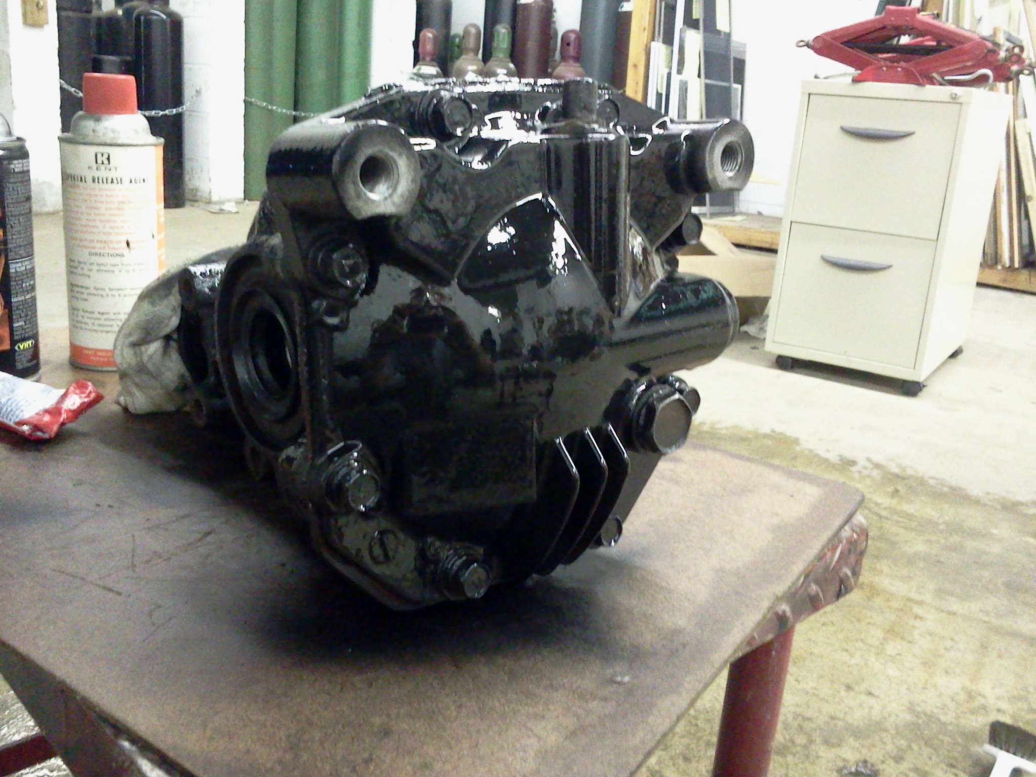

Old 08-15-2013   #36
dsmreck
dsmreck's Avatar
Join Date: Jan 2013
Drives: 98 gsx
Posts: 813

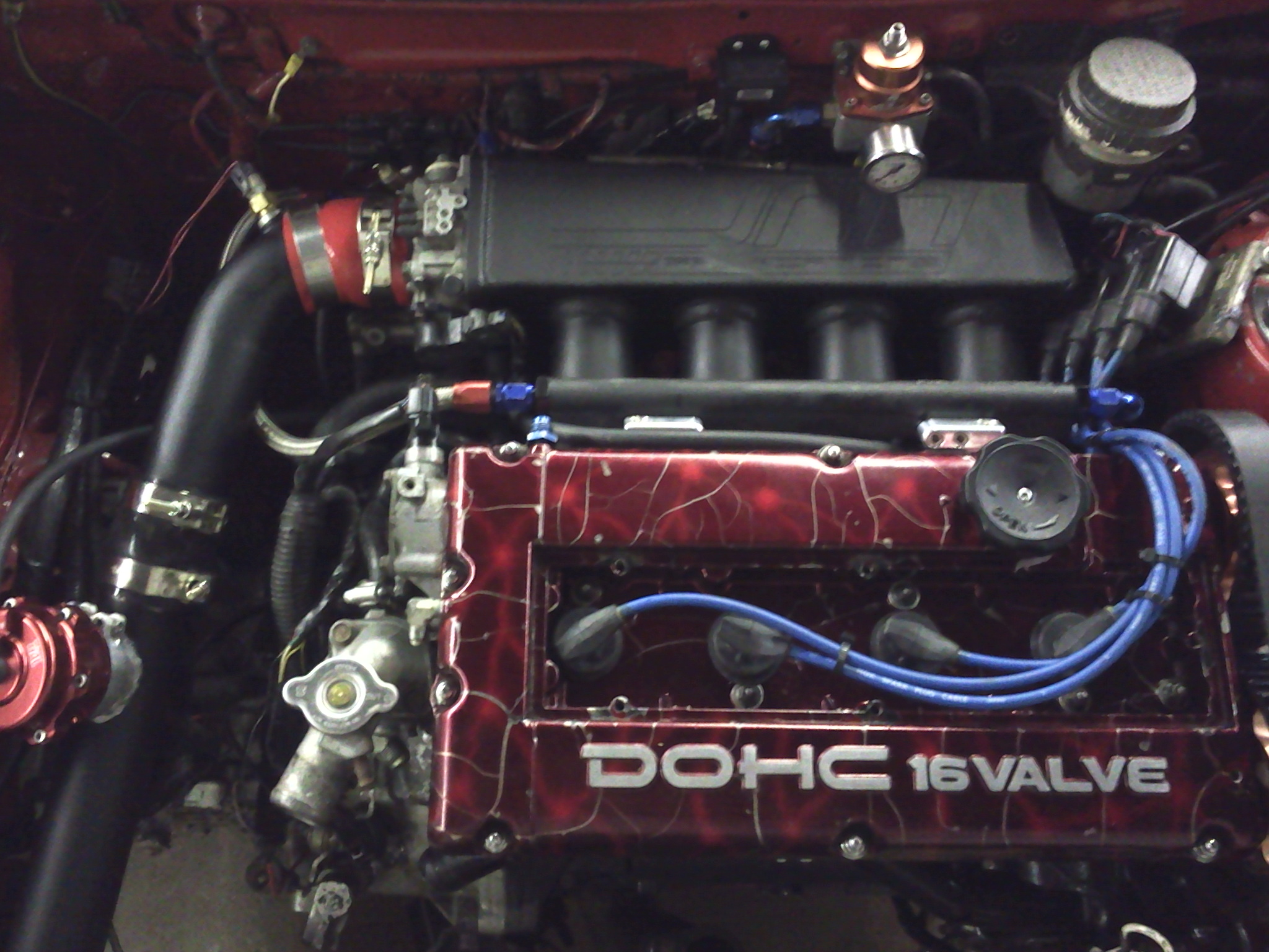

got alot done last night it took me a while to fix and hide wiring a little better but everything is done up to needing my turbo for start up. i should be recieving my redline fluids today so maybe ill get the diff, axles, and driveshaft in tonight and put fuids in...

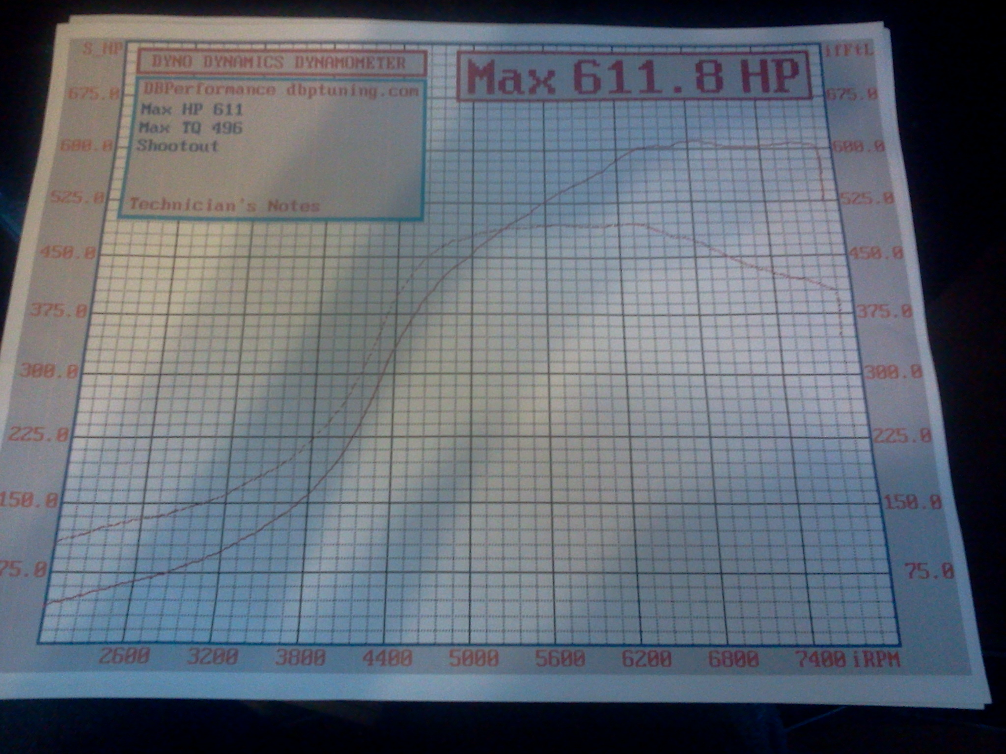

i sent in my garret 3582r in on the exchange program. 550 for a new chra. so i will be running that... seems like a good turbo. with shaft play surge and bad crank and bearings on the block shane made 525hp 425tq uncorrected. it was 611hp 496tq shootout mode...all that at 30lbs. there was also surge around 26/27 lbs.
