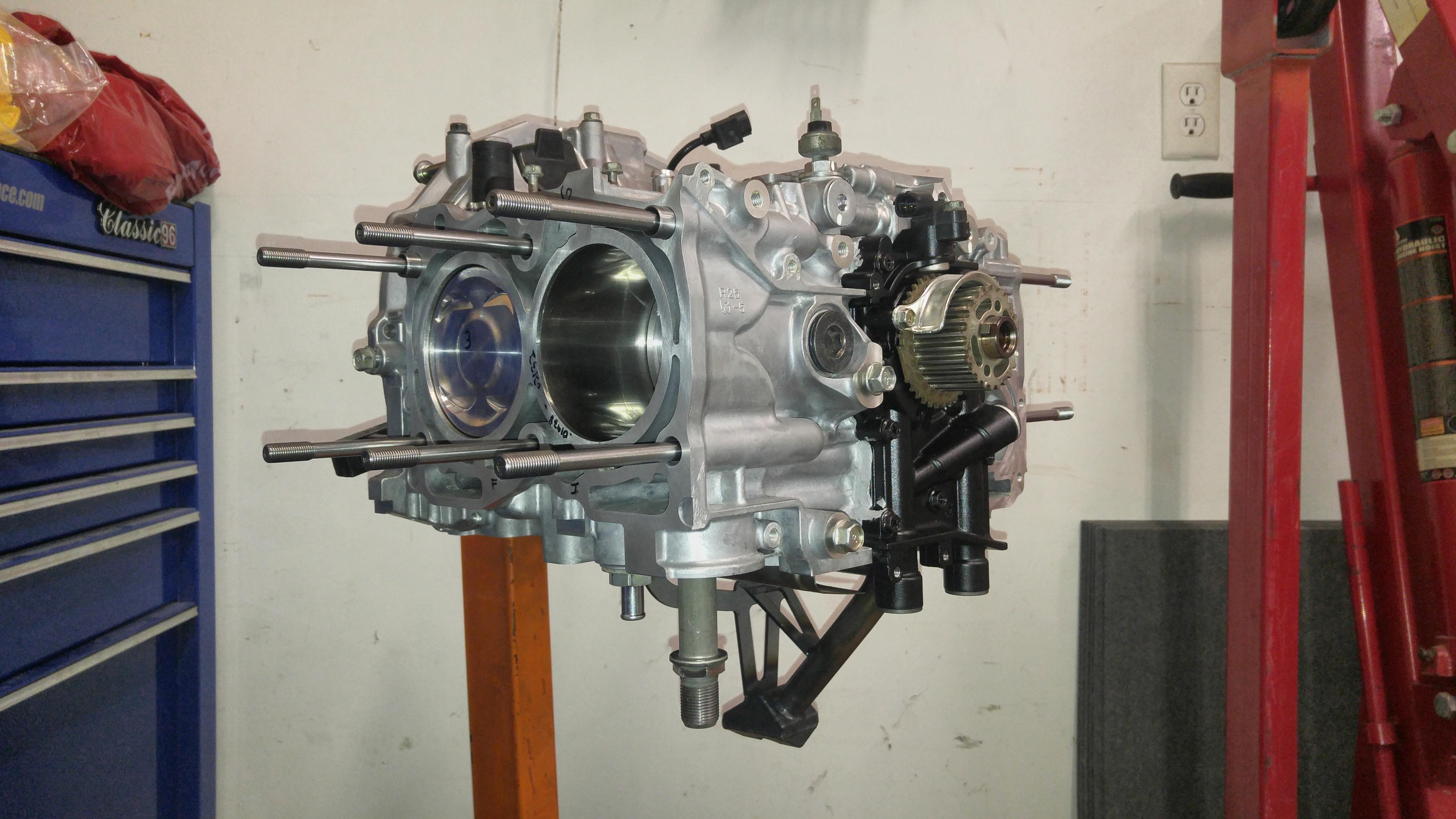

This is were I got to tonight. Headstuds on and also got my oil pickup on. Everything finished getting torqued and now i start the waiting game for the heads to get back to me.

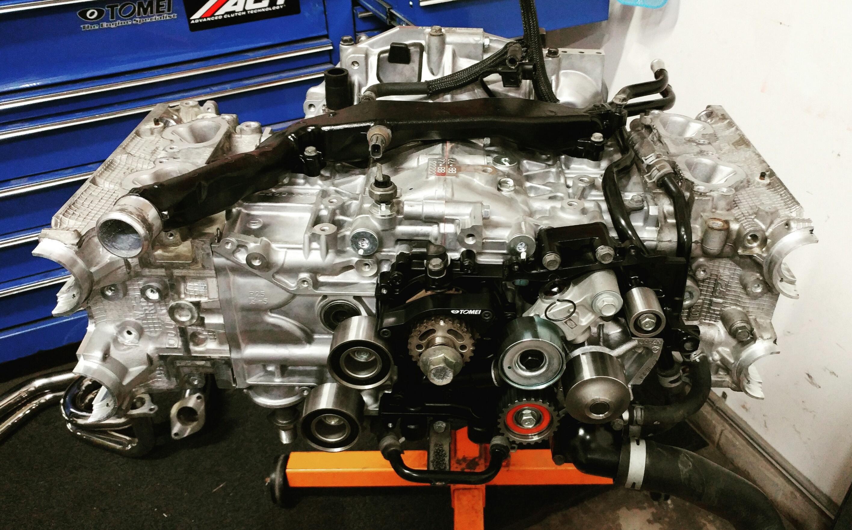

Update on a parts list got my timing kit, oem water pump, tomei timing belt guide, id2000s injectors. Also have on its way my clutch, flywheel and bov. Still waiting on heads but should be done soon. Oh and the pic is of the watr pump and some timing pulleys on.

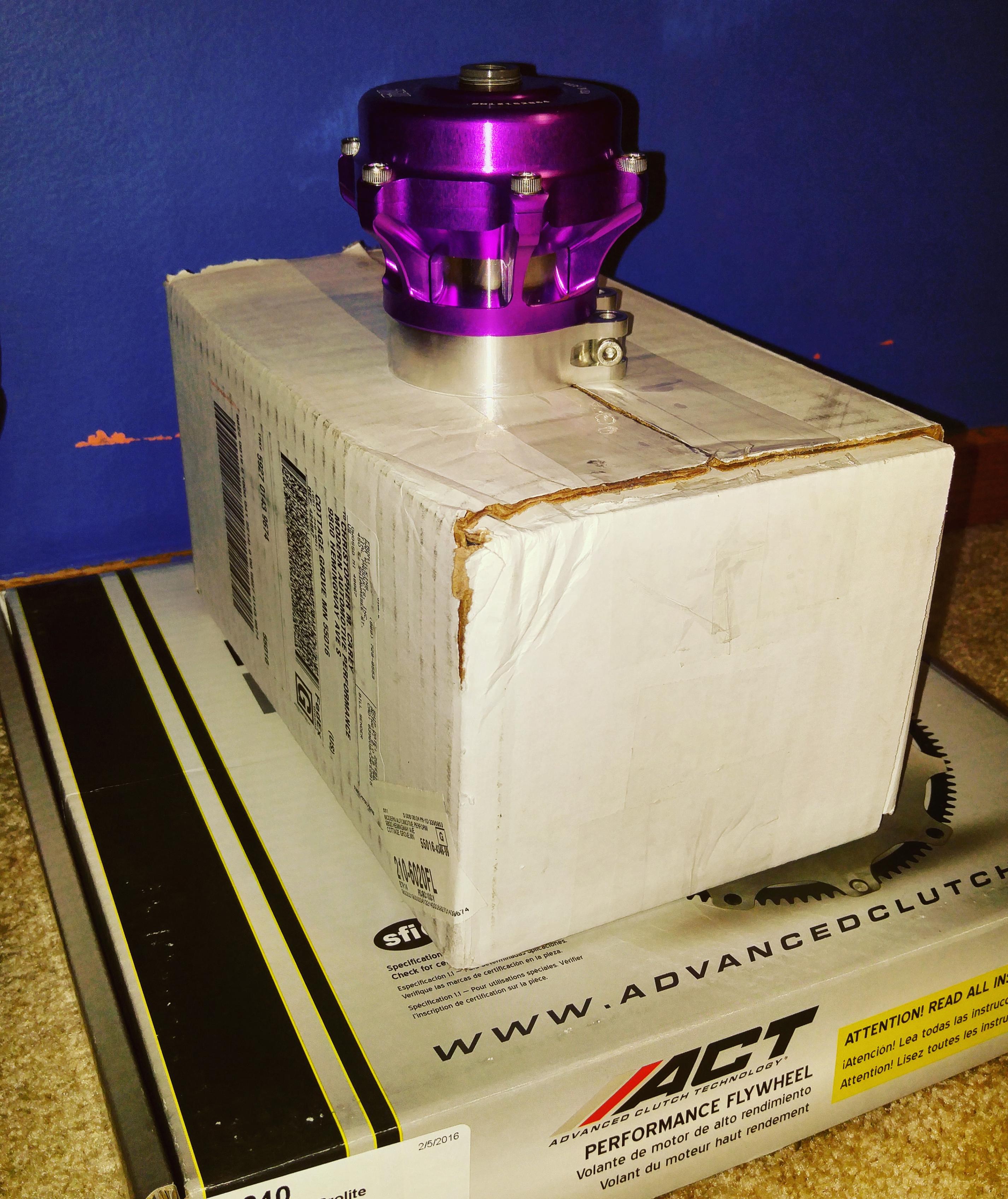

Little update got a couple more goodies. Id2000s, tial bov, act prolight flywheel. My act 6 puck is on its way. Heads should be done on the 26th. Getting closer and closer each week

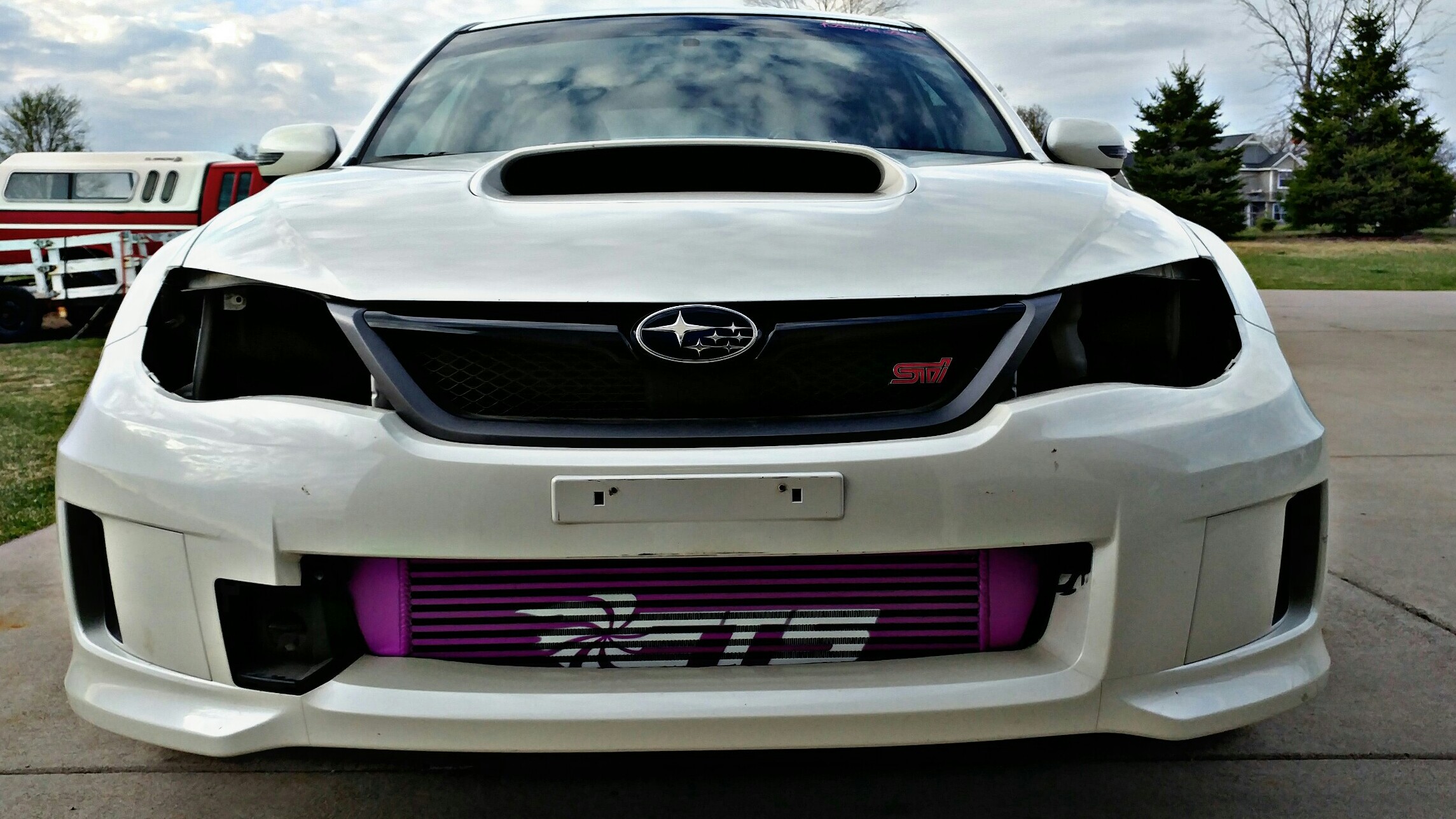

My front mount arrived today and what can i say ets has an amazing product it fits and looks great. And yes its purple now before you start cracking jokes there is a reasoning behind it to being purple.
