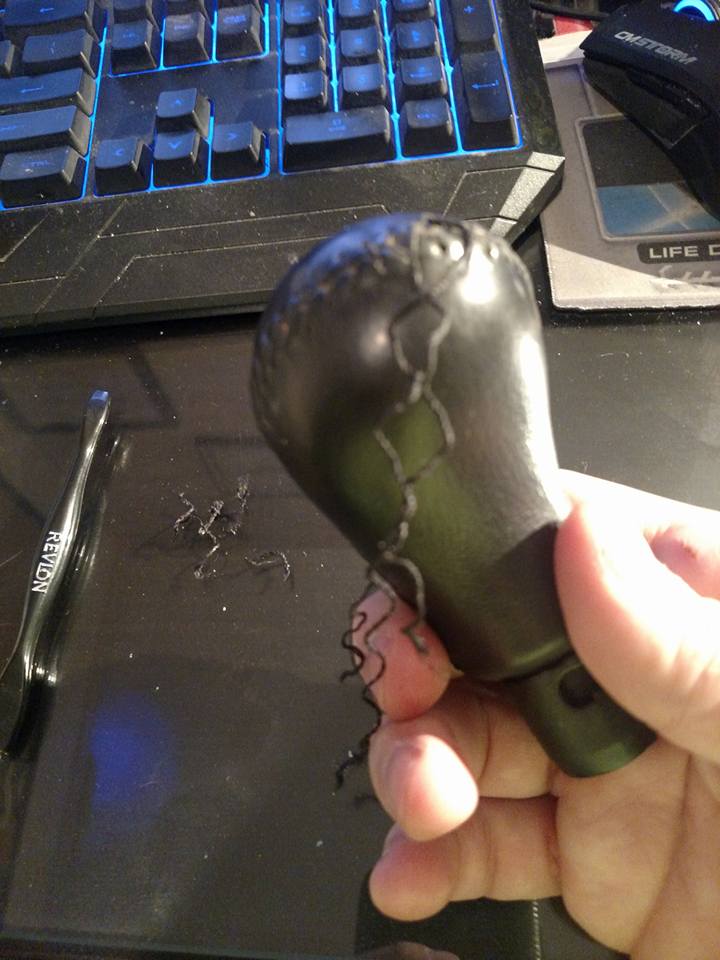

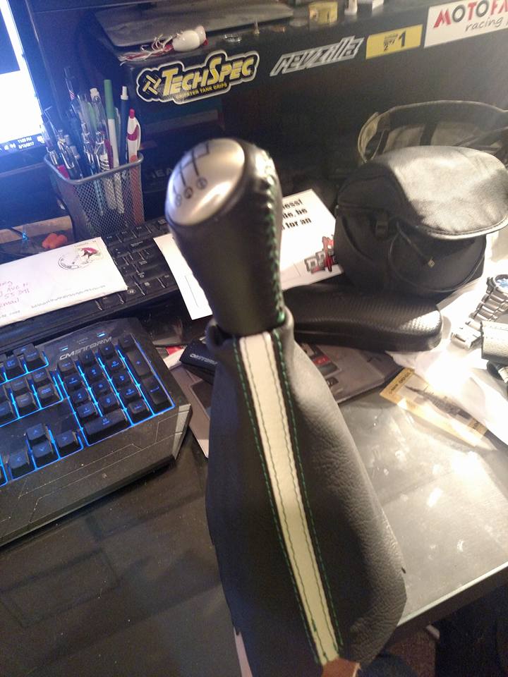

My shift knob finally showed up as well as my custom leather bits from RedlineGoods.
Maybe I can get them in.
2008 C6 Z06 Shift Knob
Redline Goods Custom Shift Boot (as well as e-brake boot and e-brake handle)
MTI Racing six shooter short throw shifter.

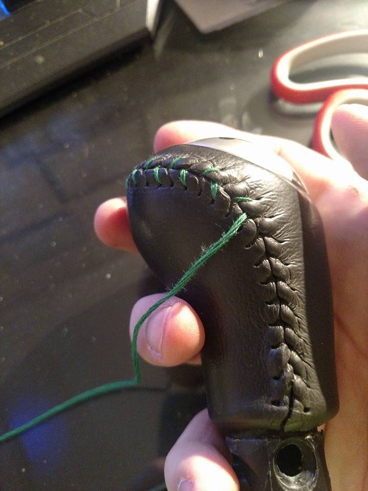

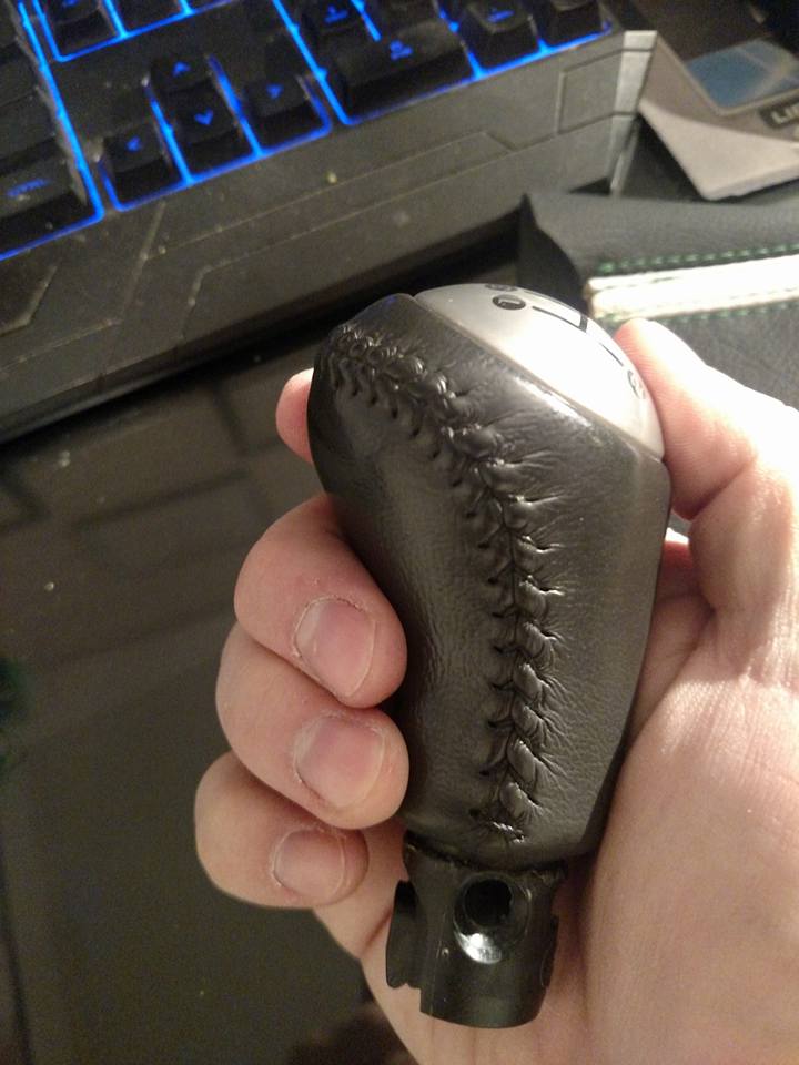

I decided to pull the stock black threads out of the OEM shift knob and color match the boot. $0.39 investment. It's all about the little things.
Oh and my widebands showed up. Trying out some 14point7 widebands. A separate review to come on those.

Name:	dethreading z06 knob.jpg
ID:	16393   Click image for larger version
