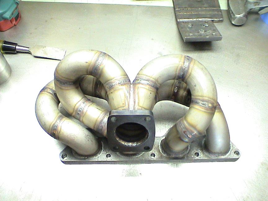

Here's a pic of the AlienAuto manifold. Sorry about the size.

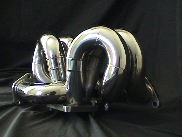

Pic 2 "polished" by AlienAuto

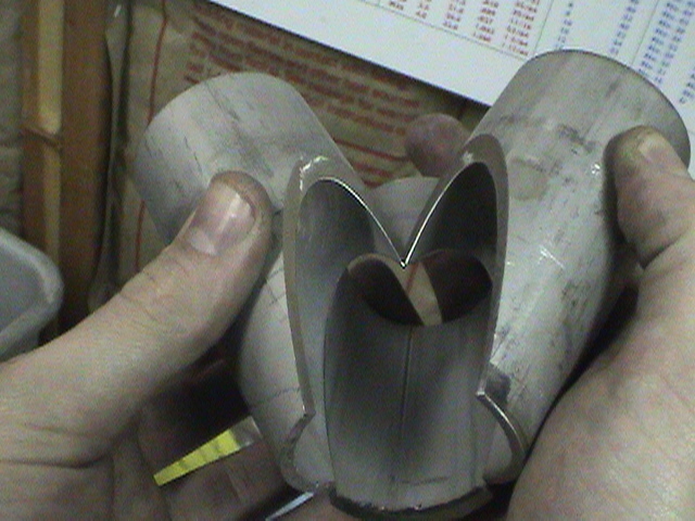

The stainless upper coolant pipe is included in the price.

Are you going for the polished look or the raw finish?

Well polished of course.

What material does Alien use? It looks like the flange is different than the runners. What thickness is it? The #1 runner turns very quickly after it comes out of the head. I don't even think it is straight in the beginning. I like the polished one a little better where the runners come together.

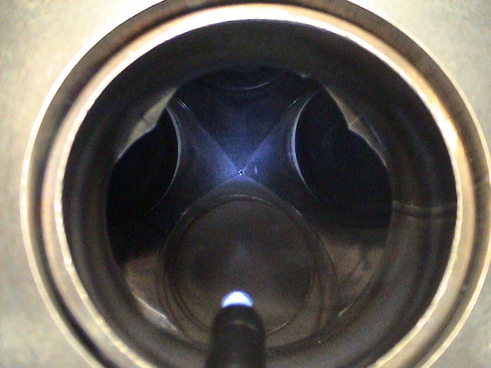

1/2 inch carbon steel flanges, 304 stainless tubing. 321 flanges and tubing are available, but the price goes up. If I remember correctly (and I may be wrong on this) they said it was 8-gauge stainless tubing. I have some more pics below that show the thickness. I also have a pic of how the runners exit the head flange as Jet has a concern about the runner turning too quickly.
Like Shane said, if they go under, the warranty is going with them. I've never really had any reservations about them or my DNP cracking anyway, if it cracks I get it fixed. Wether it's warranty or I pay somebody some $$ to fix it. It's one of the "risk" I'm willing to take to get performance. Just like anything we do to our cars to make them faster, it's a risk we are all willing to take. Do I want it to crack? NO. If it does, I'll get it fixed.

Yeah, #1 looks a lot better from that angle. I would upgrade to the 321. The other one will definately crack. I do like the WG coming out of the collector, that is where it should be at. It looks like one of the better designs that I have seen.
