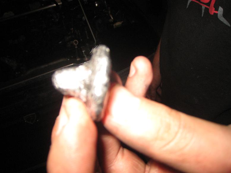

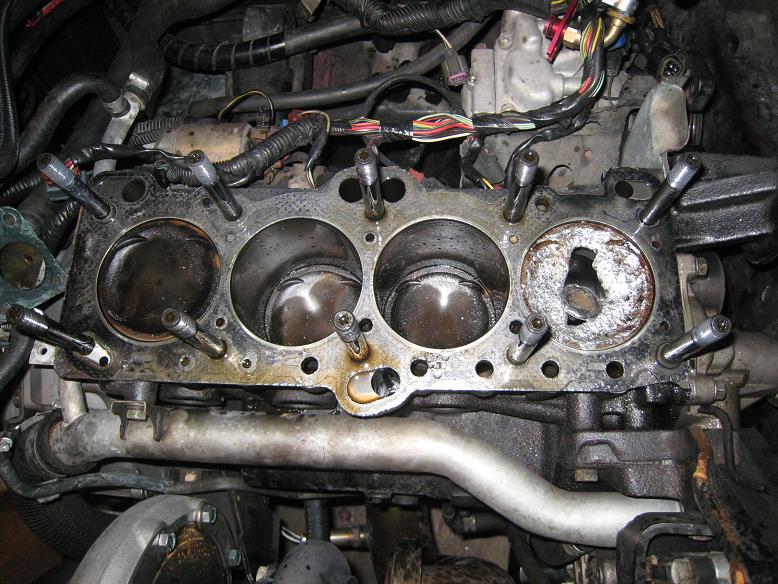

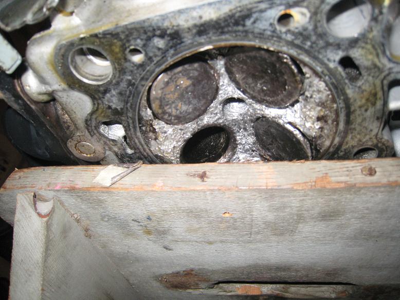

But I just got the head off. Thanks for the quick help Andrew
I think this may be a bigger tragedy then Romeo & Juliet...

Good news is that I don't think the block is trashed. The cylinder walls looked had no large gouges or anything of that sort. I'll be spending some time this week on the car, and removing the oil pan, and the rod/piston from that cylinder. Then I'll try to clean out that cylinder as best as I can, and get a better look at what condition that cylinder is in.
The head is screwed though, so if anyone has one laying around, let me know. I'll be reusing the Crower springs/retainers from this head, the cams, the rockers, and the 3g HLA's. The rest is just worth it's weight in aluminum I think.

holy fucking wow... apparently you had an emo valve that didn't wanna live anymore...

I'd like to get some honest advice here. If they cylinder walls aren't horrible, is this something I could simply rehone, and reinstall new parts into there? Or is this a must that the block be removed, remachined, the whole works?
Steve or anyone on here who is somewhat experienced with this, please help me out as I just paid a nice chunk of money to get this thing built maybe 1 1/2 years ago, the right way, from a shop, who did a great job, and now I'm looking at having to drop a huge chunk of money to get it done all over again because of what appears to be a freak accident that wrecked all this. If there are any ways to redo this nicely, but not having to go through the whole 9 yards, I am all ears.
I remember Scheides (I think it was Scheides) putting up a post awhile back about people rebuilding their motors by just rehoning them. Obviouslly they weren't motors that look like what mine looks like now. But if the walls really aren't that bad, could this be an option?

Right now, nothing. The TB is fine, the cams still look good, everything under the Valve Cover looked good except for the busted rocker (which must have busted due to the valve in the cylinder). No idea what caused the valve to fall into the cylinder. I'm still trying to understand why my tach stopped, and if that has anything to do with anything here. Did maybe that injector die or it's clogged, caused it to run lean, and voila? I will be hooking the injectors up to a battery to test and make sure they all still function, and will clean them with some carb cleaner.

Deffinetly an option man. If the cylinder walls aren't scored You can hone the bitch with a powerdrill and drop in a new piston.
Is it going to be as tight a clearance as the other 3? No, but It'll get you down the road through the summer and then some. Is the rod OK?

If the cylinder walls don't have any major scoring that your fingernail would catch on, you can rehone it and drop a new piston in there. It really depends on the condition of the cylinder wall. Being that the piston has an actual hole in it, metal fragments are most likely in your pan. If that's the case, than you might be able to get away with honing that cylinder, but if any metal got through the pickup screen and filter and into your bearings, a full rebuild might be best because you'd have to pull the motor anyways. I'll try and find a minute to get up there. Keep me informed on what you find.

I sprayed some brake cleaner on the walls real quick and got the walls pretty clean of oil. There are definatly little marks in there. I can feel them with my fingernail. I'm thinking nothing that couldn't get machined out though. But also not sure if a little hone dealy on a drill would get it out though.
