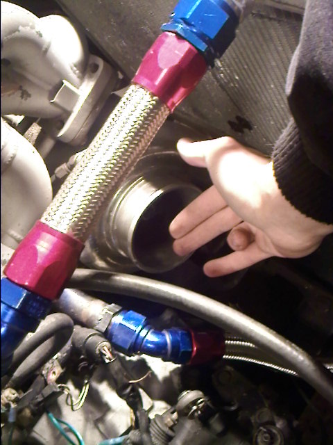

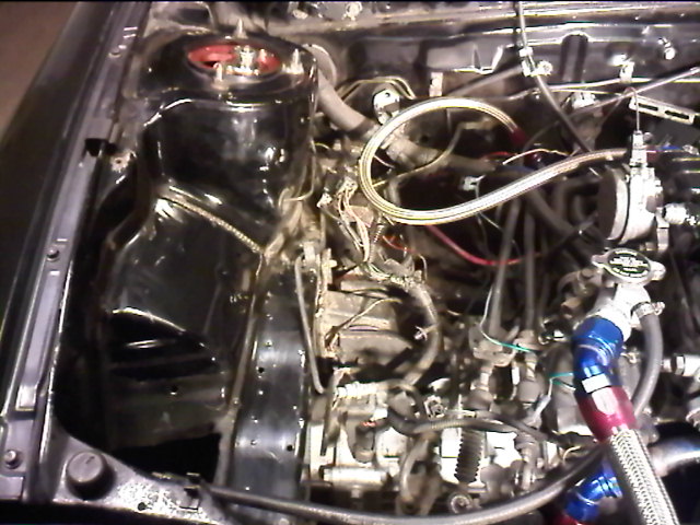

More pics. Upper pipe is done, and made. Got the 90 TPS to mod for the q45 tb (thanks Mark!) lower ic pipe is mocked and getting welded up, fuse box is relocated to the inner fender, and wiring has begun. Tomorrow, we are tackling the firewall and those wires. I'm still looking at maybe filling in unused holes, and spraying black again to make it look a bit better..

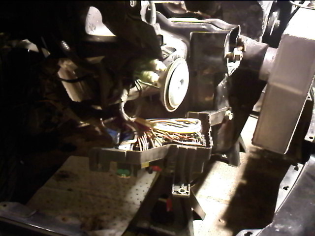

As the title states, we found more shit wrong..something rather major actually. Turns out the revving issue I had, COULD be very well attributed to a BAD GROUND-more-so, one that was NEVER BOLTED DOWN!! I dunno if it was whom I baught the car from, or when I had it apart before( I forget ever even seeing this tab) but this is what it looked like :
In the spare harness we used, and cut it out (relocating the MSD to the inside, and etc) this shows what all that ground is for, amongst other things:
Now that that issue has been sorted out, it will FOR SURE be grounded now. The upper and lower pipes are done, BOV and AIT is on, TB is modified for the 90 dsm TPS (thanks Mark for the sensor!) injectors are in (thanks Andrew!) timing belt is done, FJO is moved over to the back far corner, intake on for mock up, and figuring out vac lines, etc.
Progress pics as of now..

The #3 engine bay ground is an important thing to have hooked up. This is a ground for the CAS, Coils, Transistor, and another ECU ground.
~John

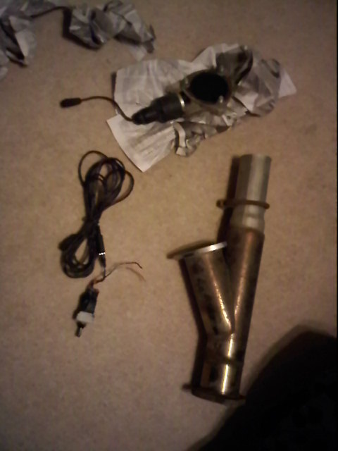

Swifty I'm so glad I made you make this thread; its almost like it's given you motivation to get you shit in gear and get this thing rockin! Good deal that you found that extra ground, hopefully that helps with some of the issues you'd been having. My only complaint is the QTP cutout; I hate those things, maybe you will to after owning one for a while? We'll see

the QTP is not on the car yet, still gotta figure that schtuff out. There isn't much room that it will fit well, and have ground clearance. I won't drive everywhere with it off, but I am gonna test how it effects spool-up. If it's not a HUGE difference I may just take it off and sell it. Afterall, this is still a street car, so I have my ipod, heat, wipers, etc.
