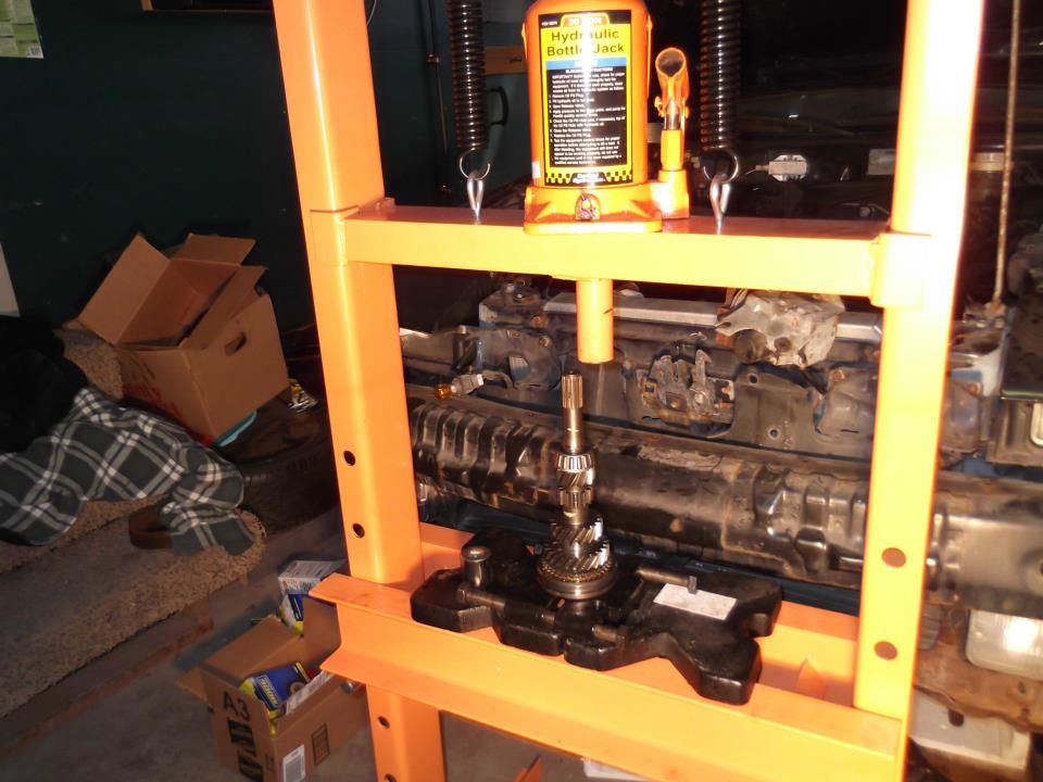

Re: team ab drag race and street builds
I always thought it was a big deal because it requires a press. I bought the one in the pic for around $170 with coupon at Harbor Freight. It worked great.

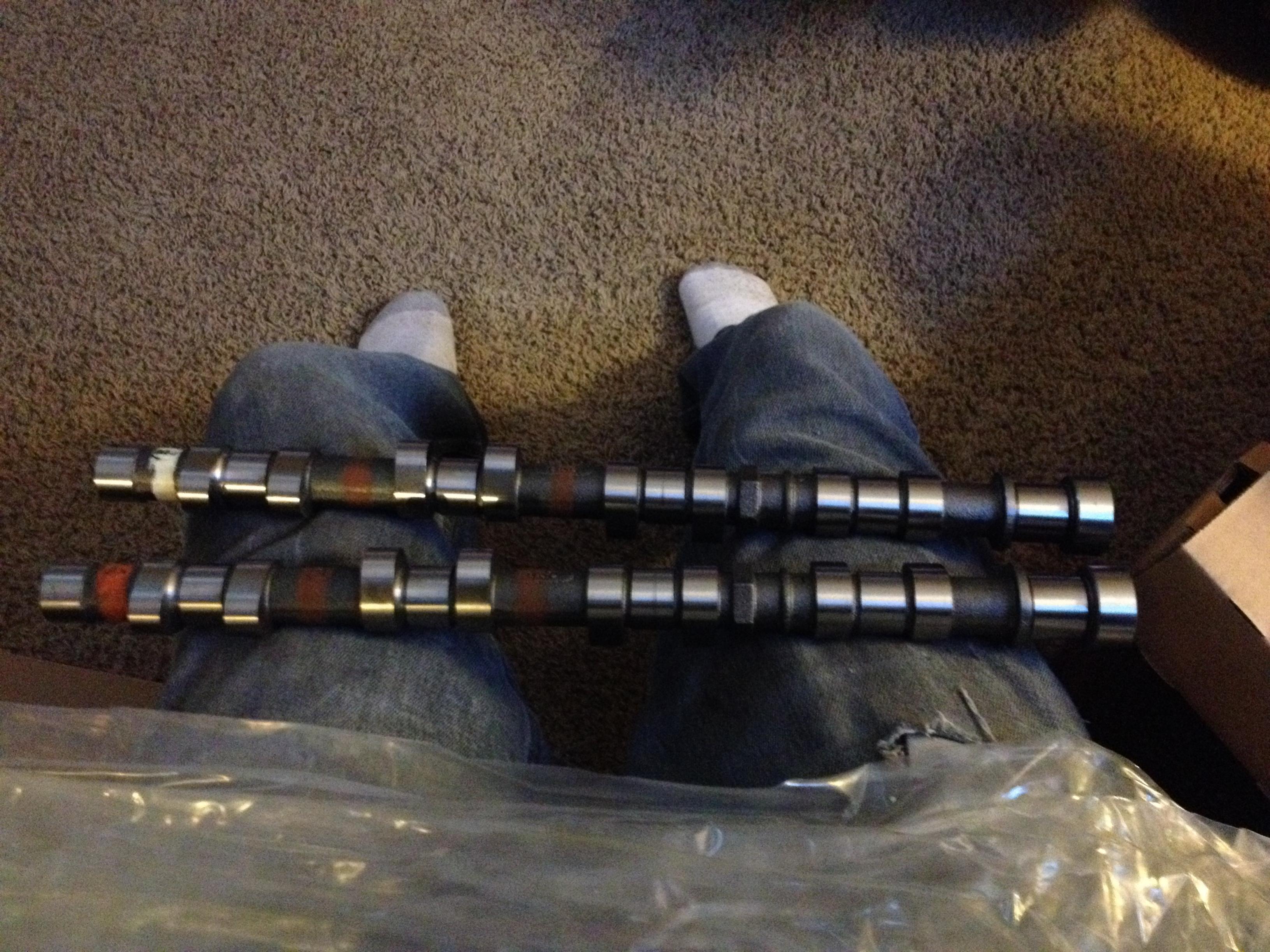

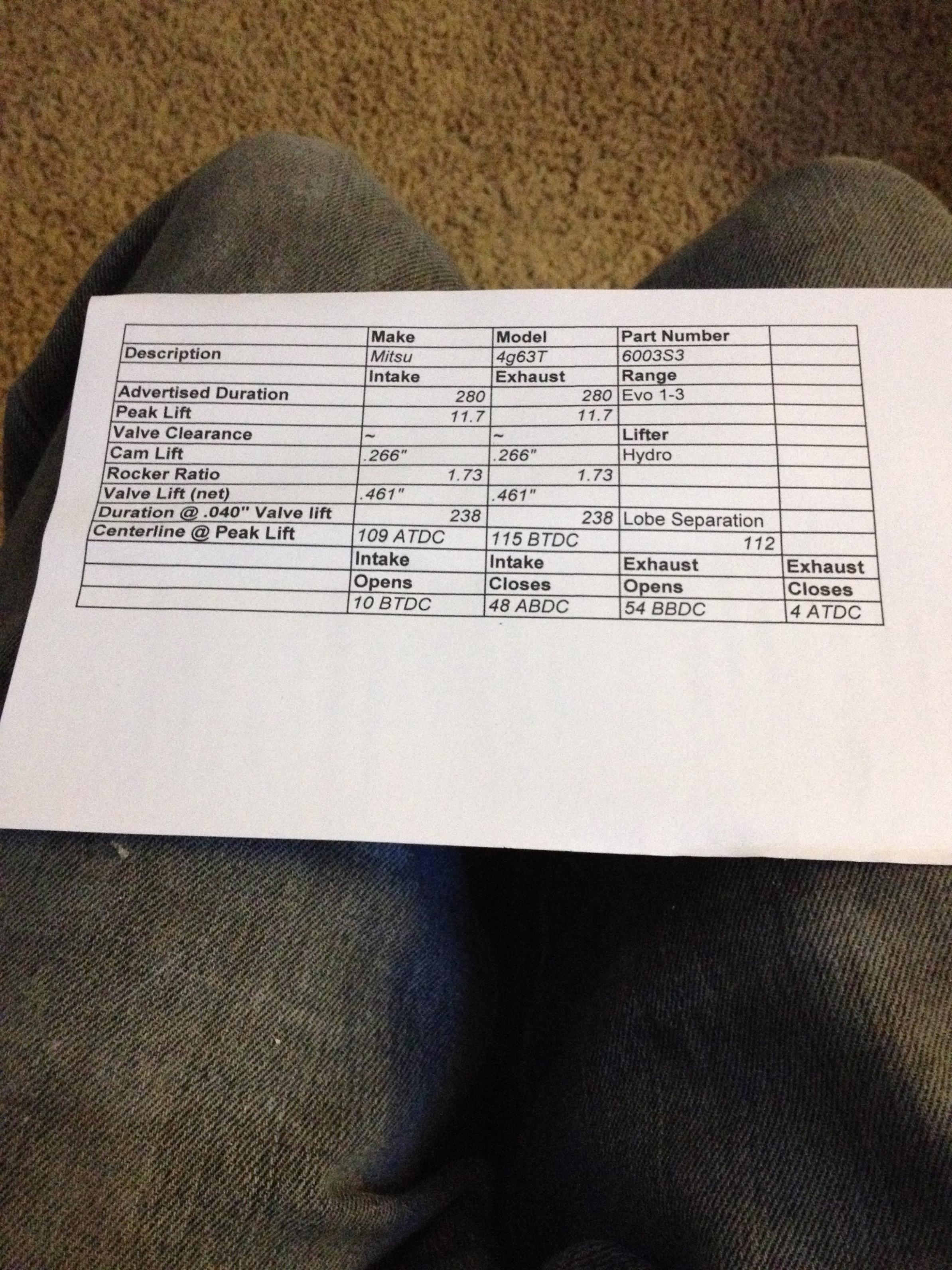

Can't get much better powder coat yesterday, New cams today. I can't wait to try these s3 out
Damn, that's a lot of cam lift on a DSM.

^ gonna be sick high lift, high compression, and boost.

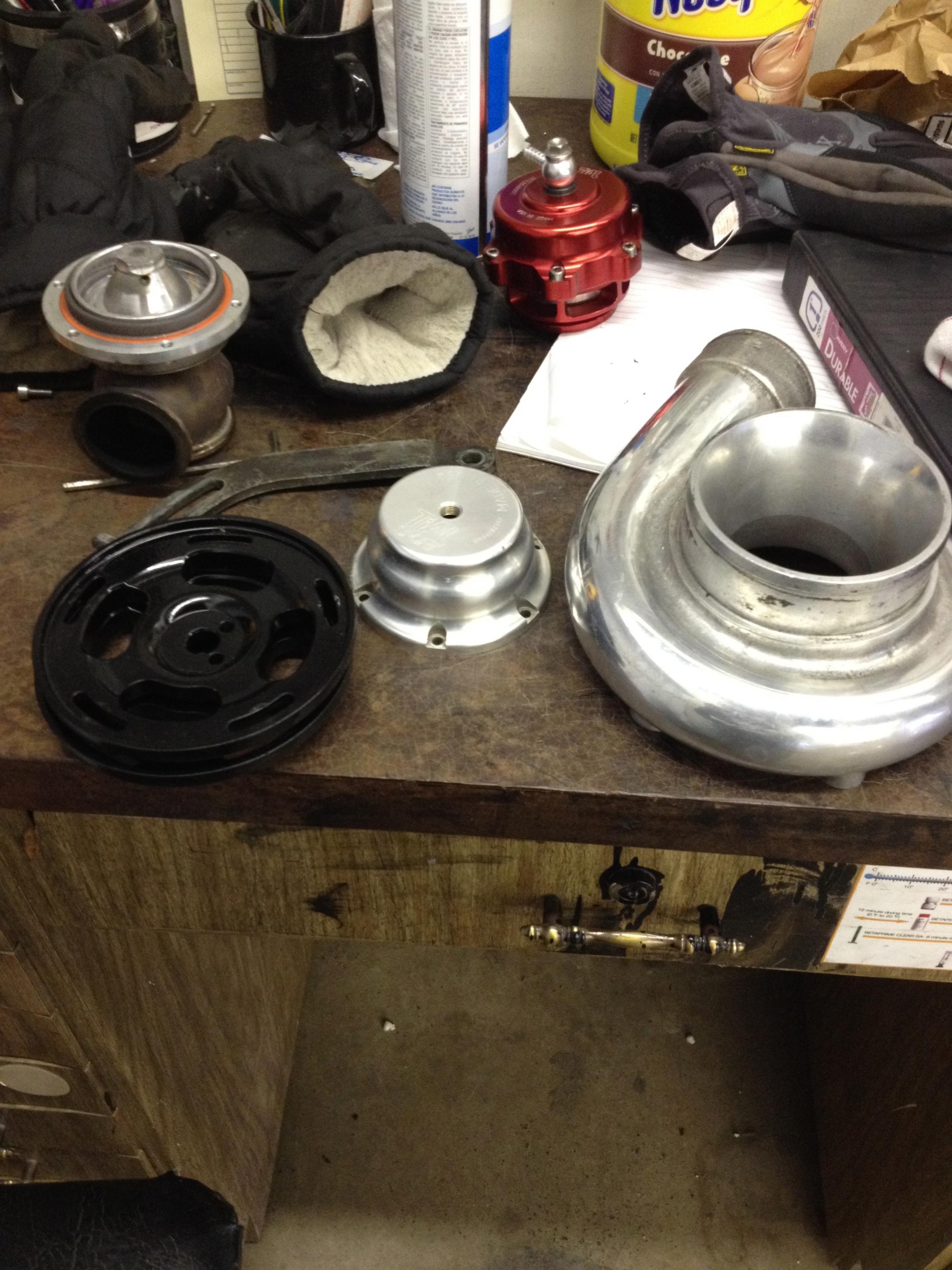

and some more powder coating, you know just incase they don't move they will still look pretty
