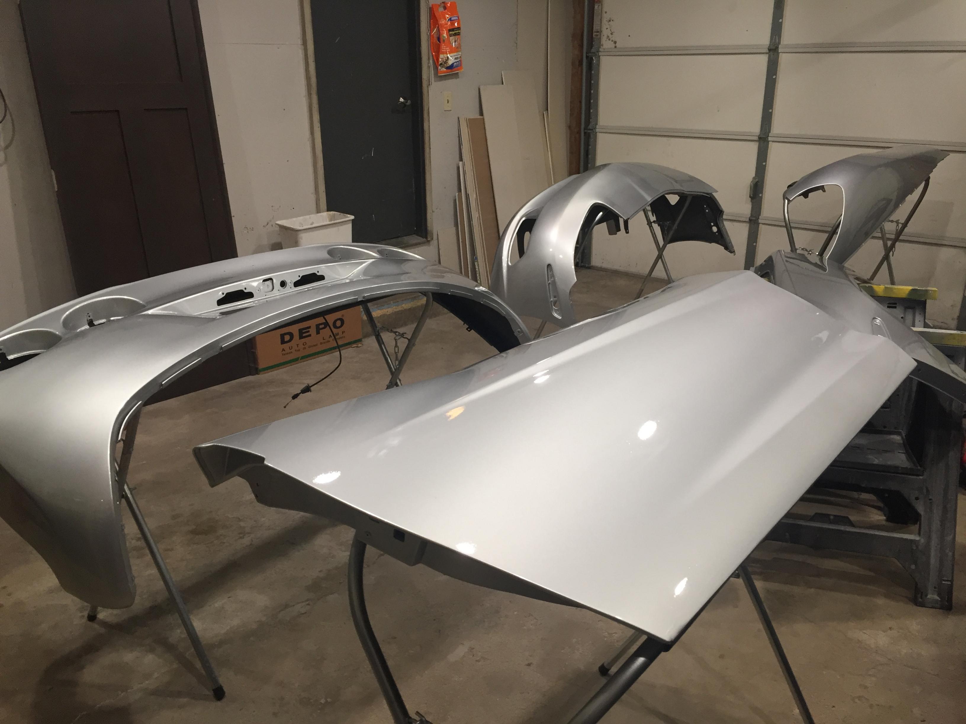

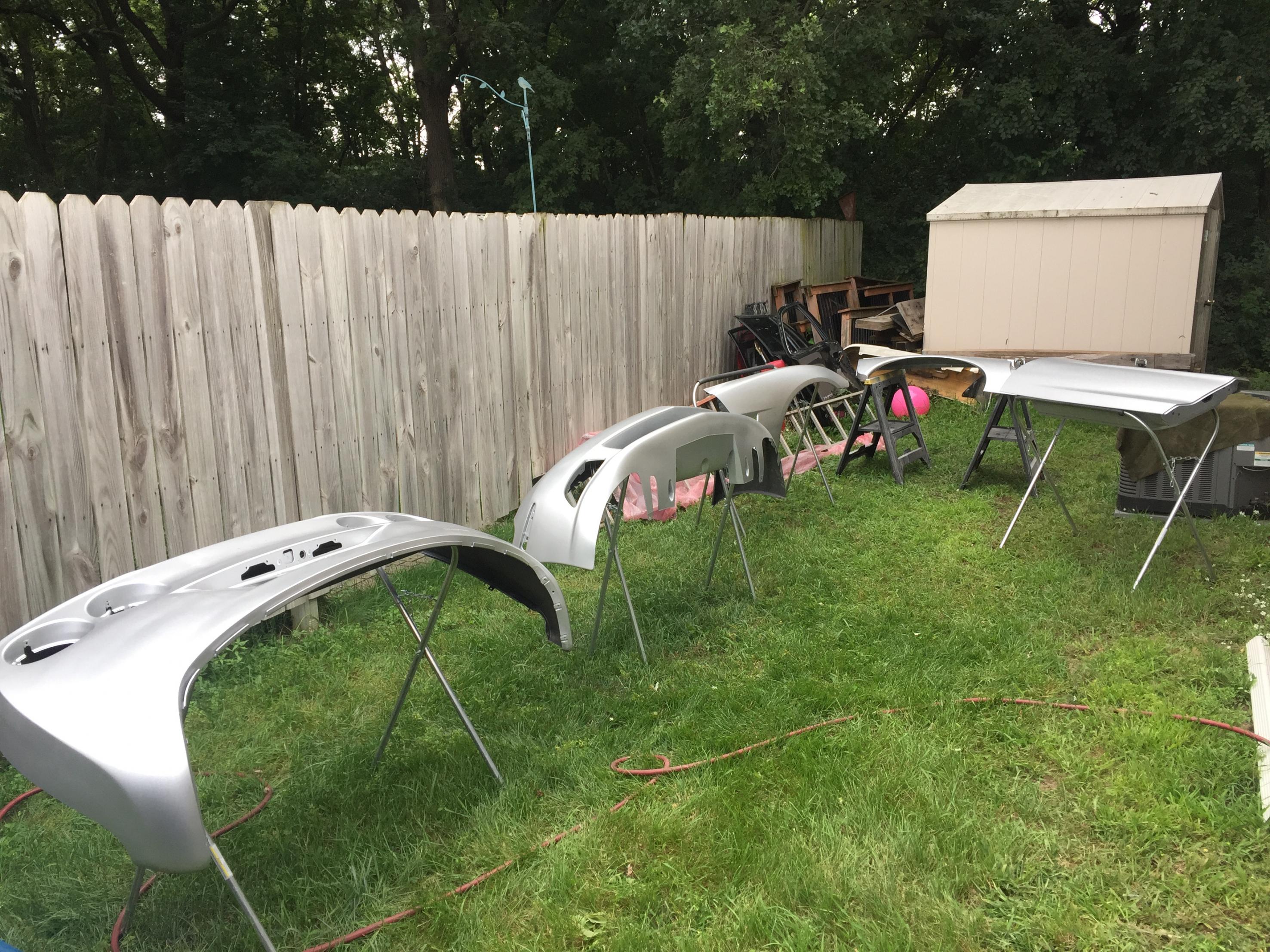

More progress today. Got all the parts painted and clear coated. Had to stop at two coats of clear because the bugs were coming out. I'll put it all together tomorrow and next week scuff it and clear the whole car for a nice even shine. Taking her up to Brainerd for boy's weekend.

Cleared and almost ready for color sanding.
