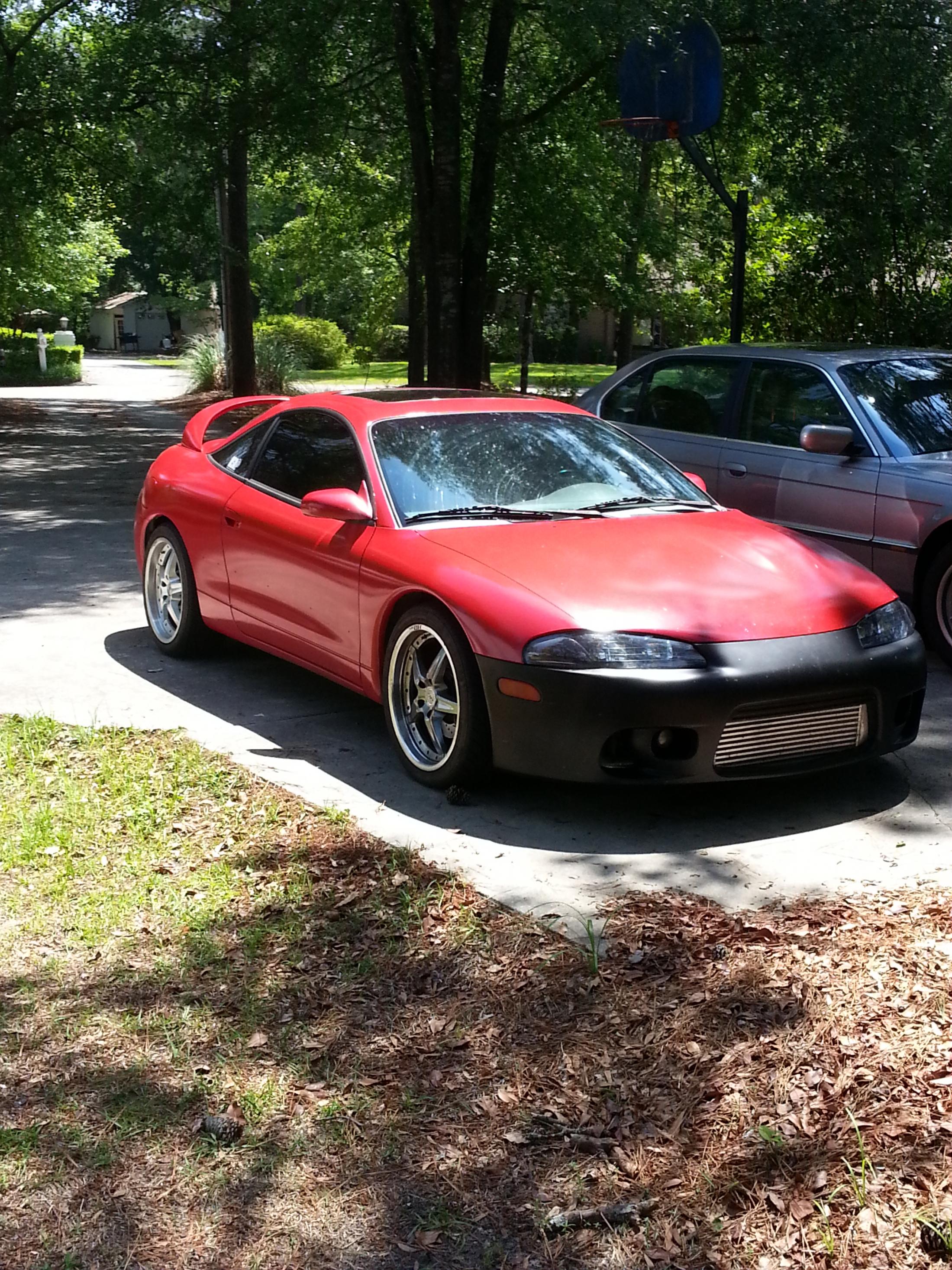

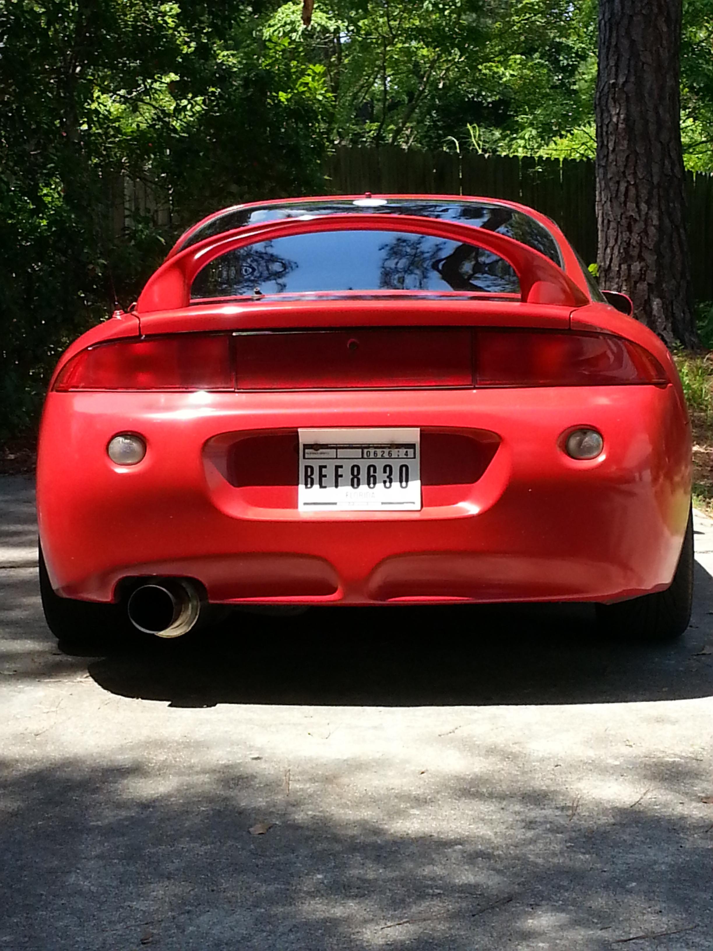

Congrats. Get some pics up of it.

here are some pictures
