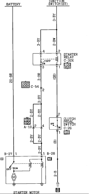

Which wire from the key cylinder is the wire that give's power to the starter? When you turn the key to run, you get electricity to the radio, a/c etc. But, which wire becomes hot when you turn the key to start? btw, this is a 92 talon.

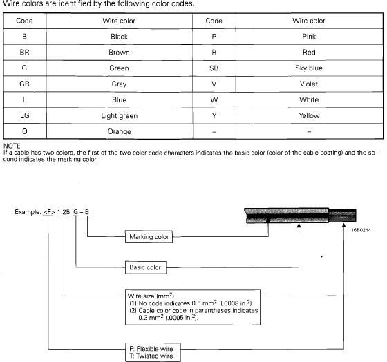

Power from the ignition switch color is ( B - Y ) that wire goes to the starter relay, from the relay is becomes ( B - R ) on its way to the starter.

ALLDATA info

Re: dumb question but..
So, I tap into the black/red wire to place a switch, further under the dash?

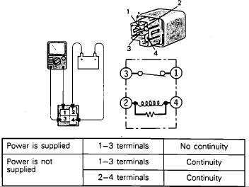

Its up to you , but it looks like you could go to the relay and do the splice.
