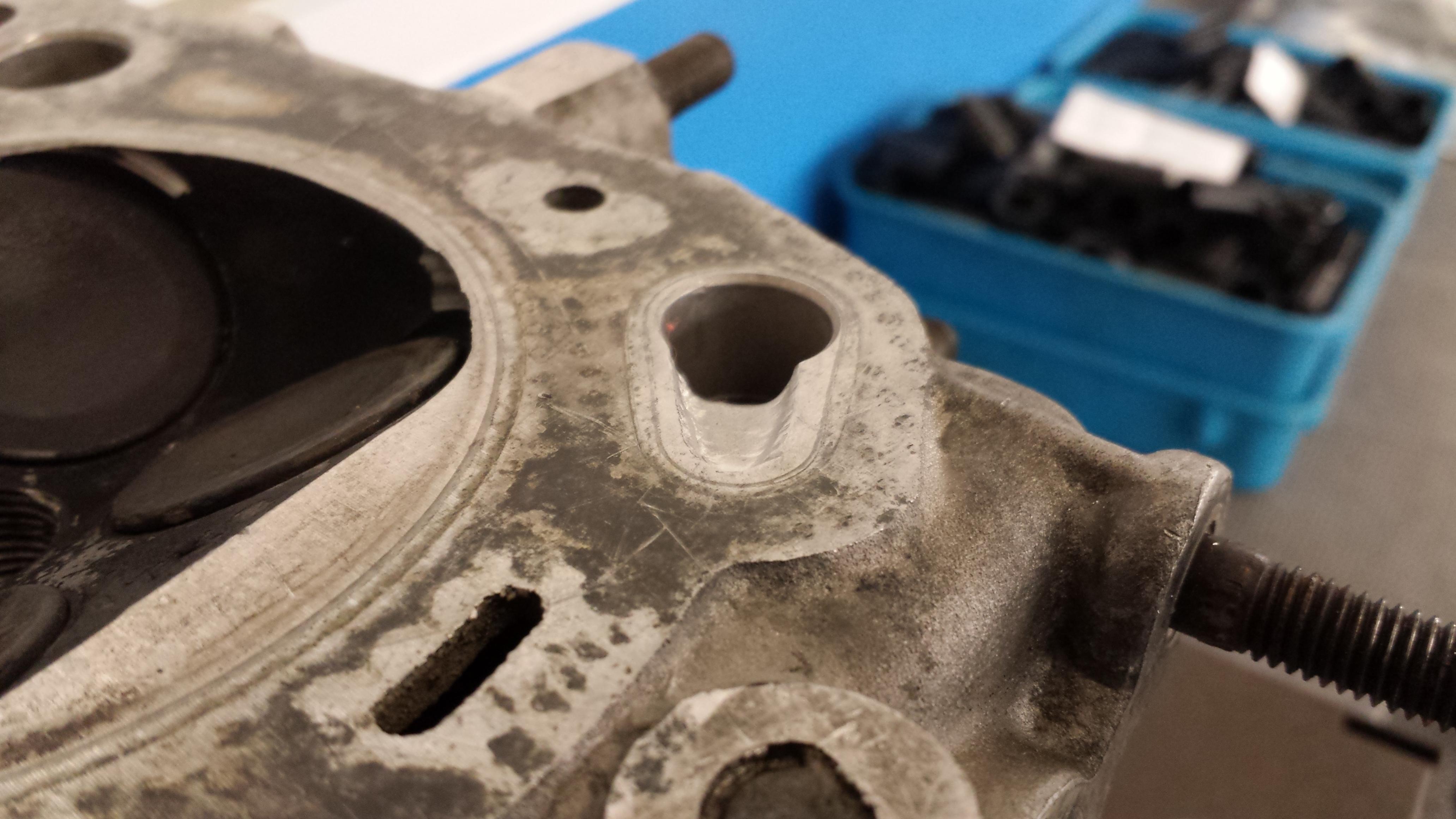

Should I go a little more ?? Not sure

Old 07-12-2013   #20
Re: Oil Port#1 for 4G63T
Looks like you could probably go a little wider if you wanted. Towards the right in the pic. Then smooth it out some.
