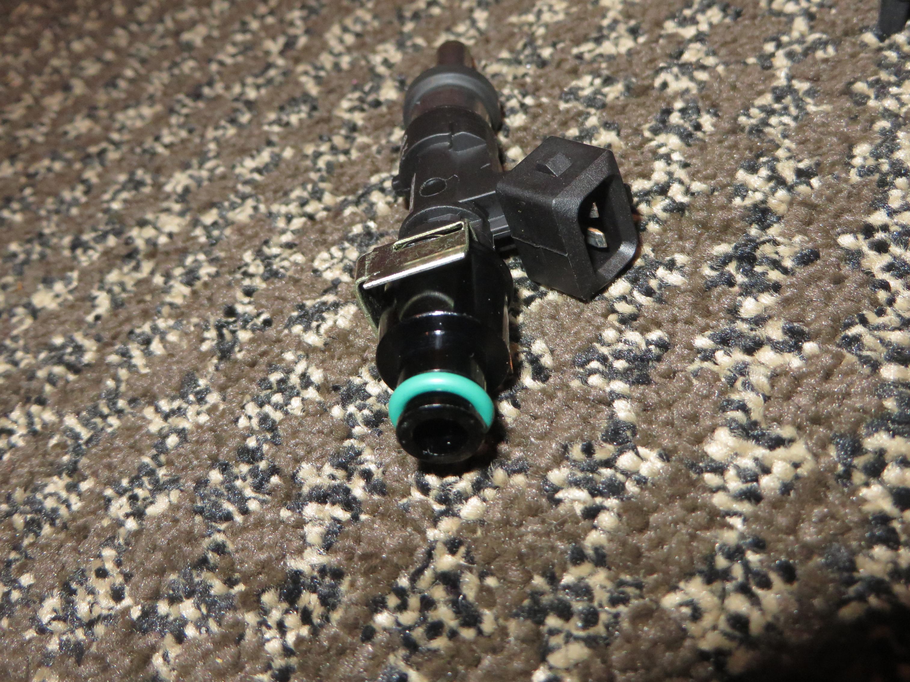

Got a couple pulls in today. So my latest tune we're now up to 25psi. Haven't done a pull with it yet but the car is feeling good. Too good cuz 3rd gear is about useless so I'm having to do my pulls in 4th gear (No Jail Preeze).
Also, got my new injectors today. FID 1600 high-z. Going to wait a little while to install them as I want to keep moving forward with the progress we're making on the logs/tune for now.
