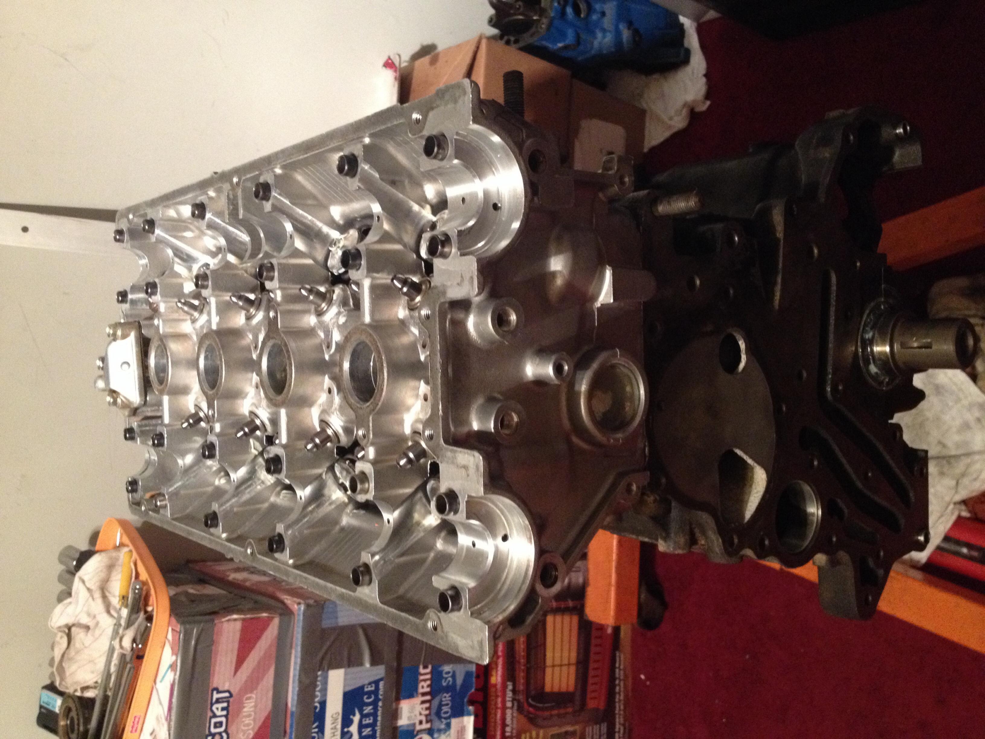

Last but not least I finally got around to finishing up Jessie's motor. Yes it has been on the back burner, but he's a flake lol. He will most likely start to add to the thread now as the ball is rolling. Here is a pic of the head on all fresh rebuilt with A1 headtuds and a compisite gasket. This car was fast as hell last year so we hope to add to that this year.
