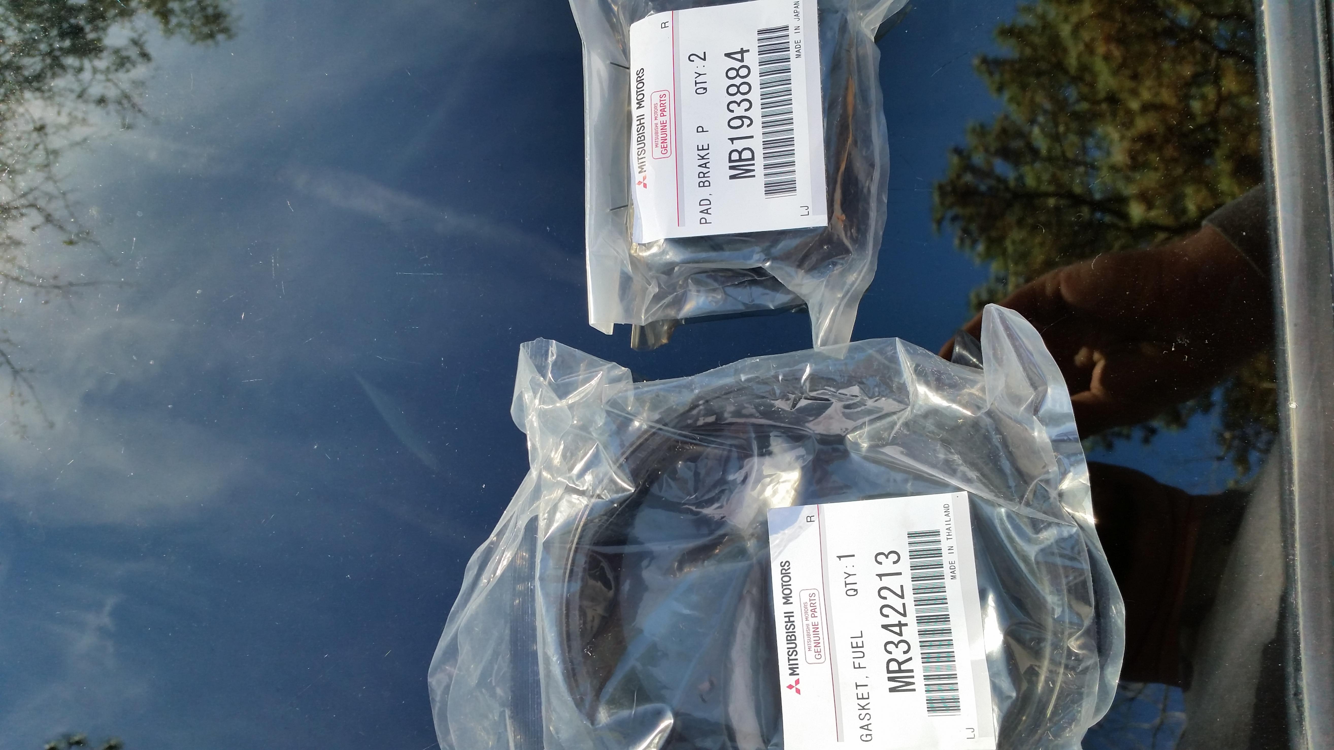

Just a fuel hangar gasket and new clutch and break pedal pads arrived today.
Also Found Rear Black Leather Seats For The Car for $30 I'll Be Picking Up Over thanksgiving as I have to drive to Charlotte to pick up my brother at the airport anyways

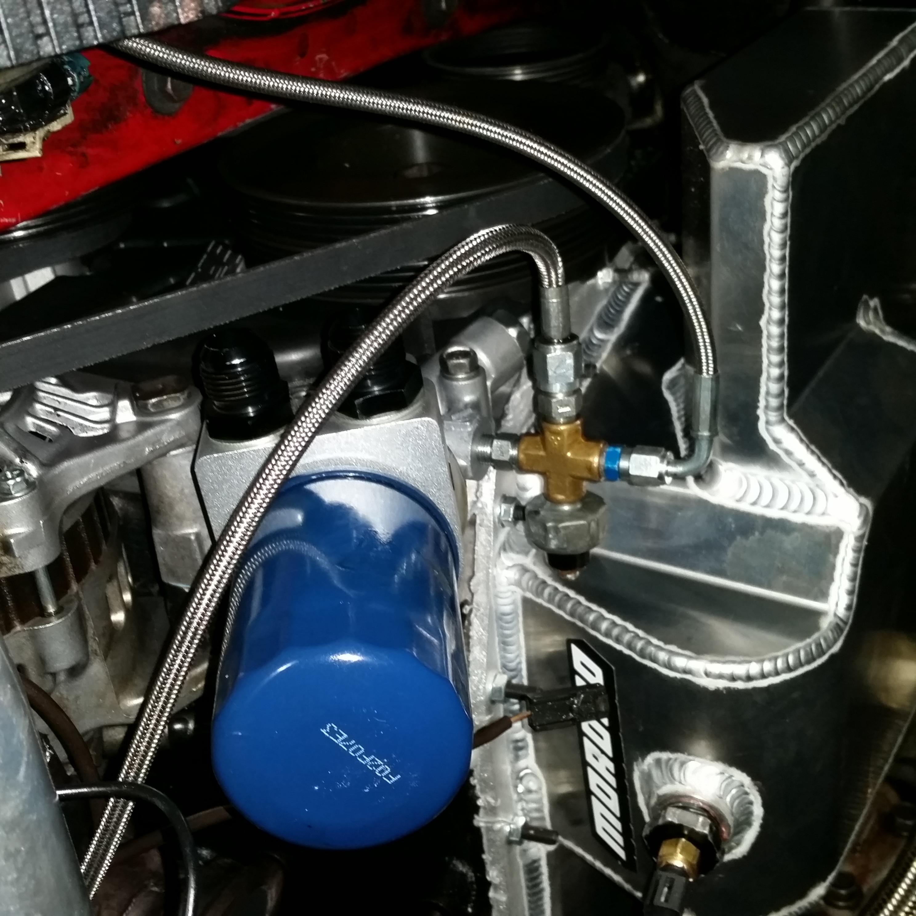

Old 03-12-2016   #6

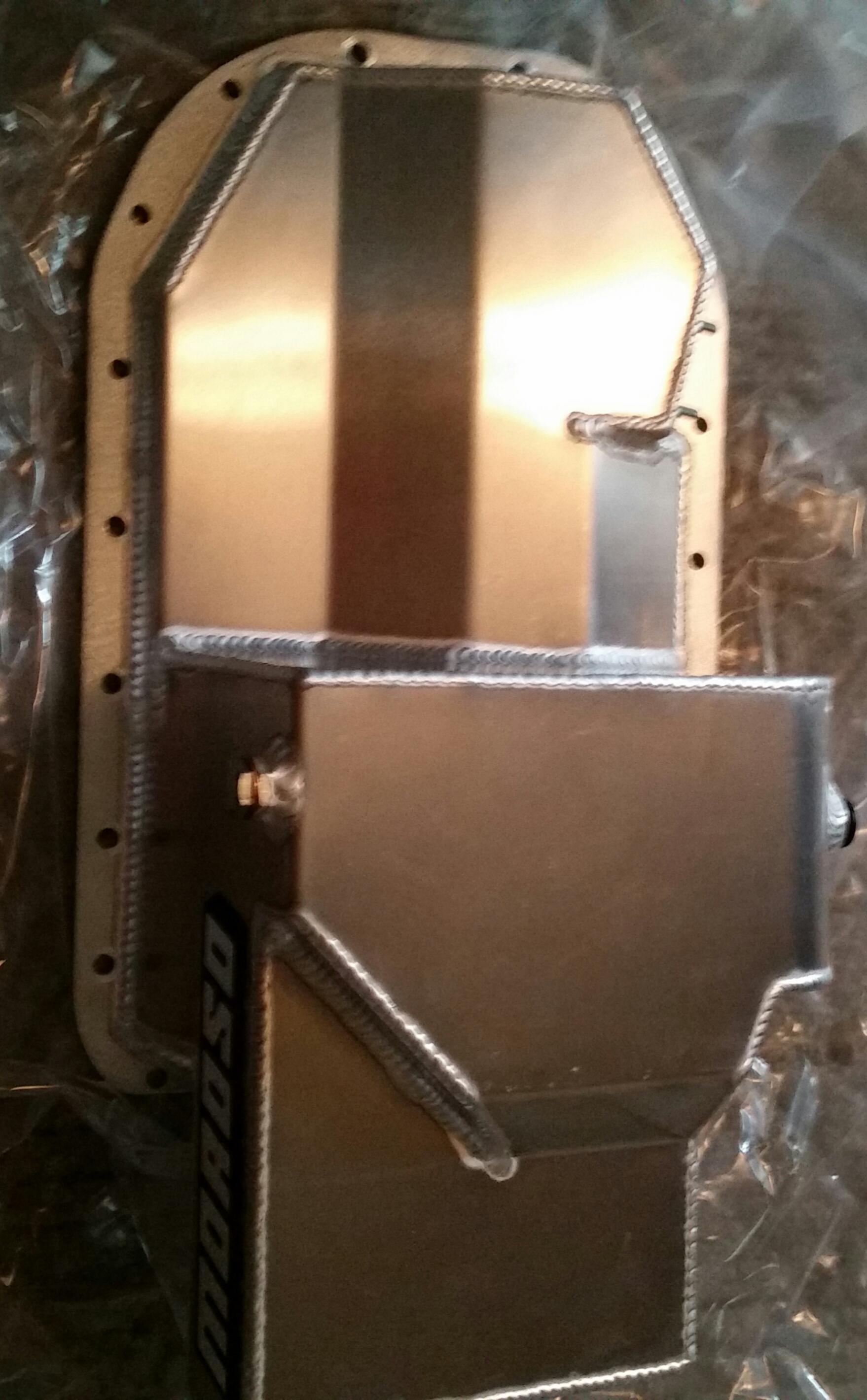

Picts oil temp and pan

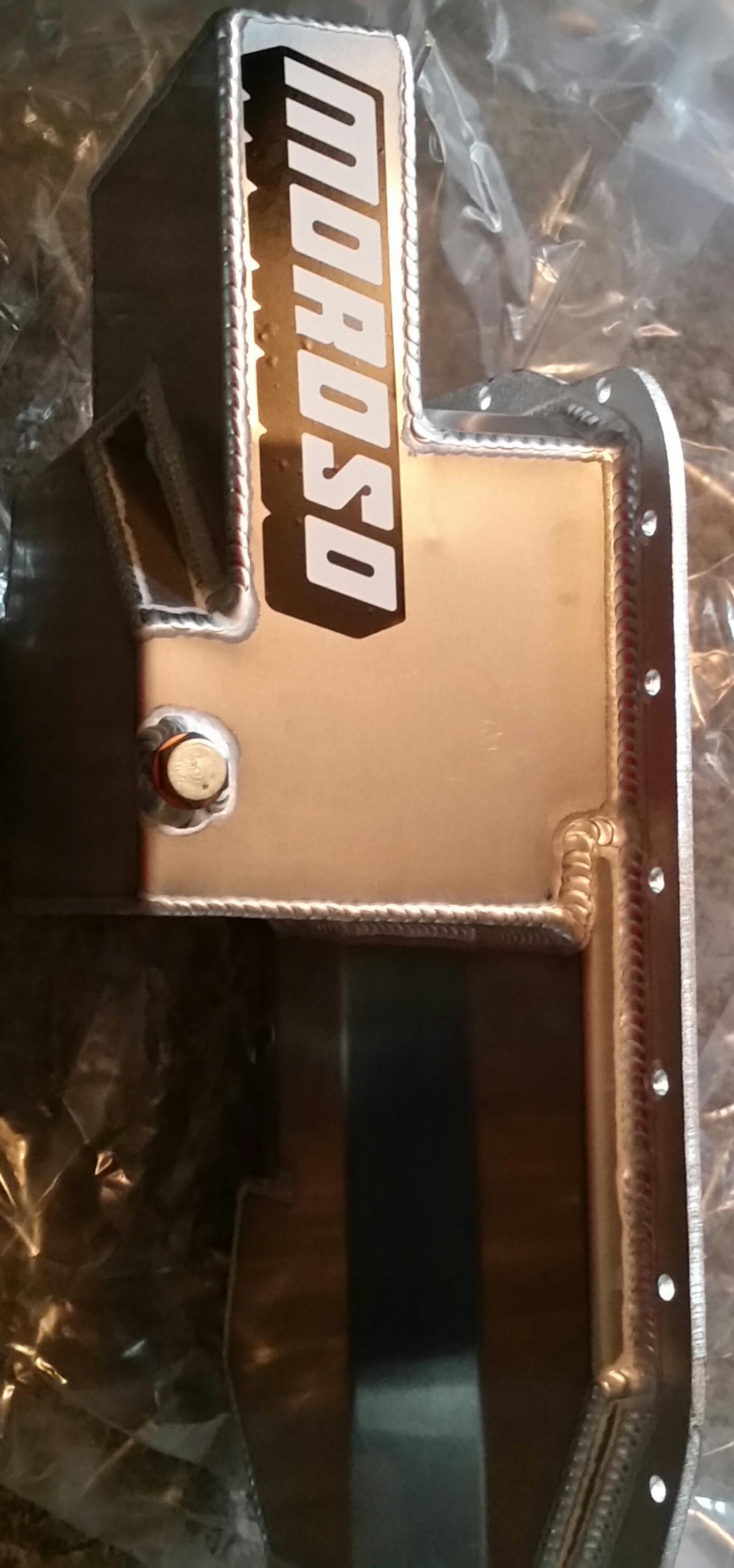

Old 03-12-2016   #7
Pan new style

Old 03-13-2016   #8
I love a quality baffled oil pan, nice purchase!

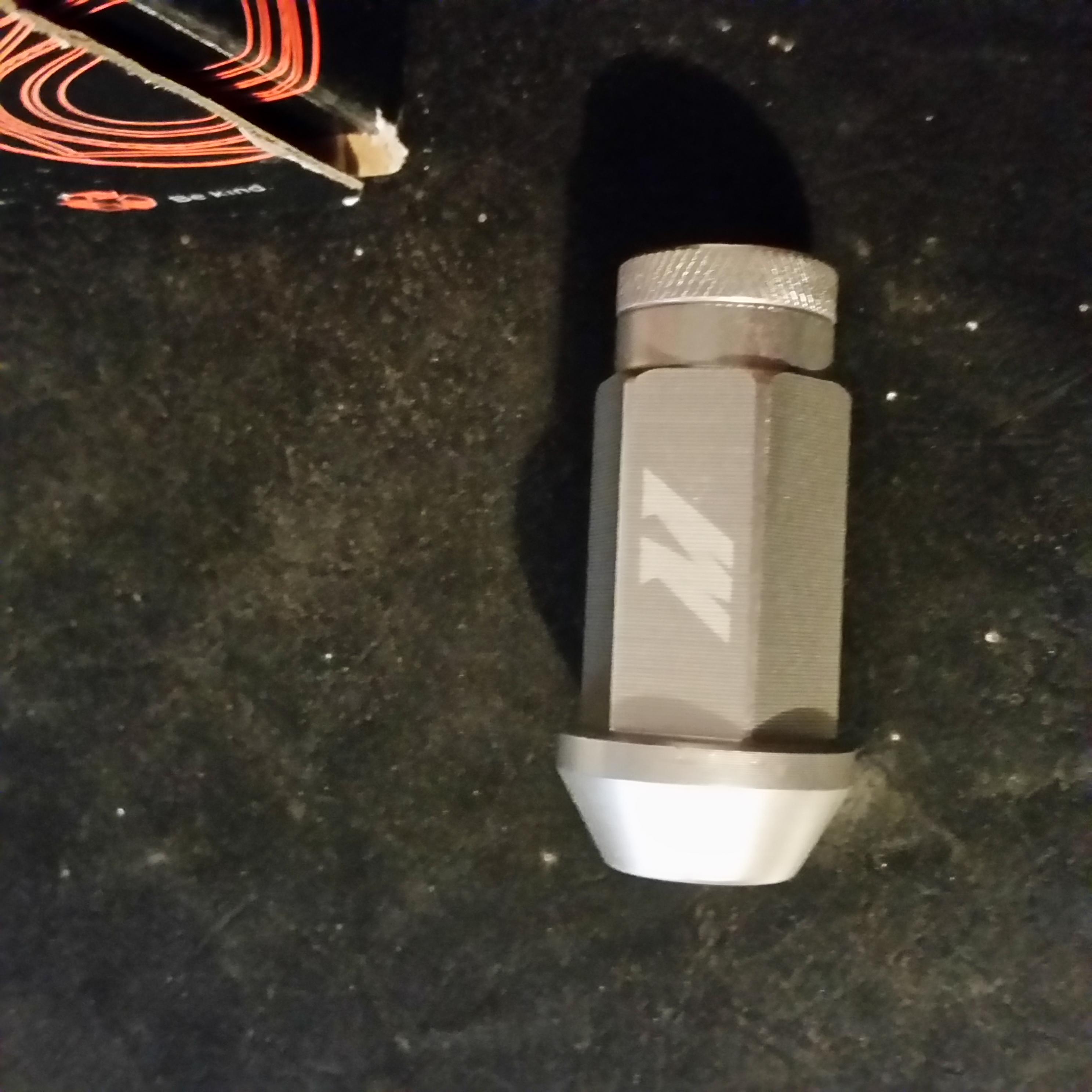

Old 05-08-2016   #9

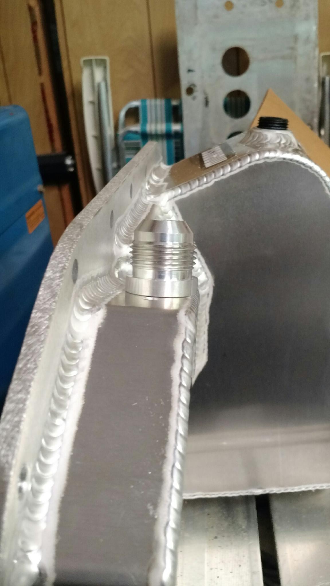

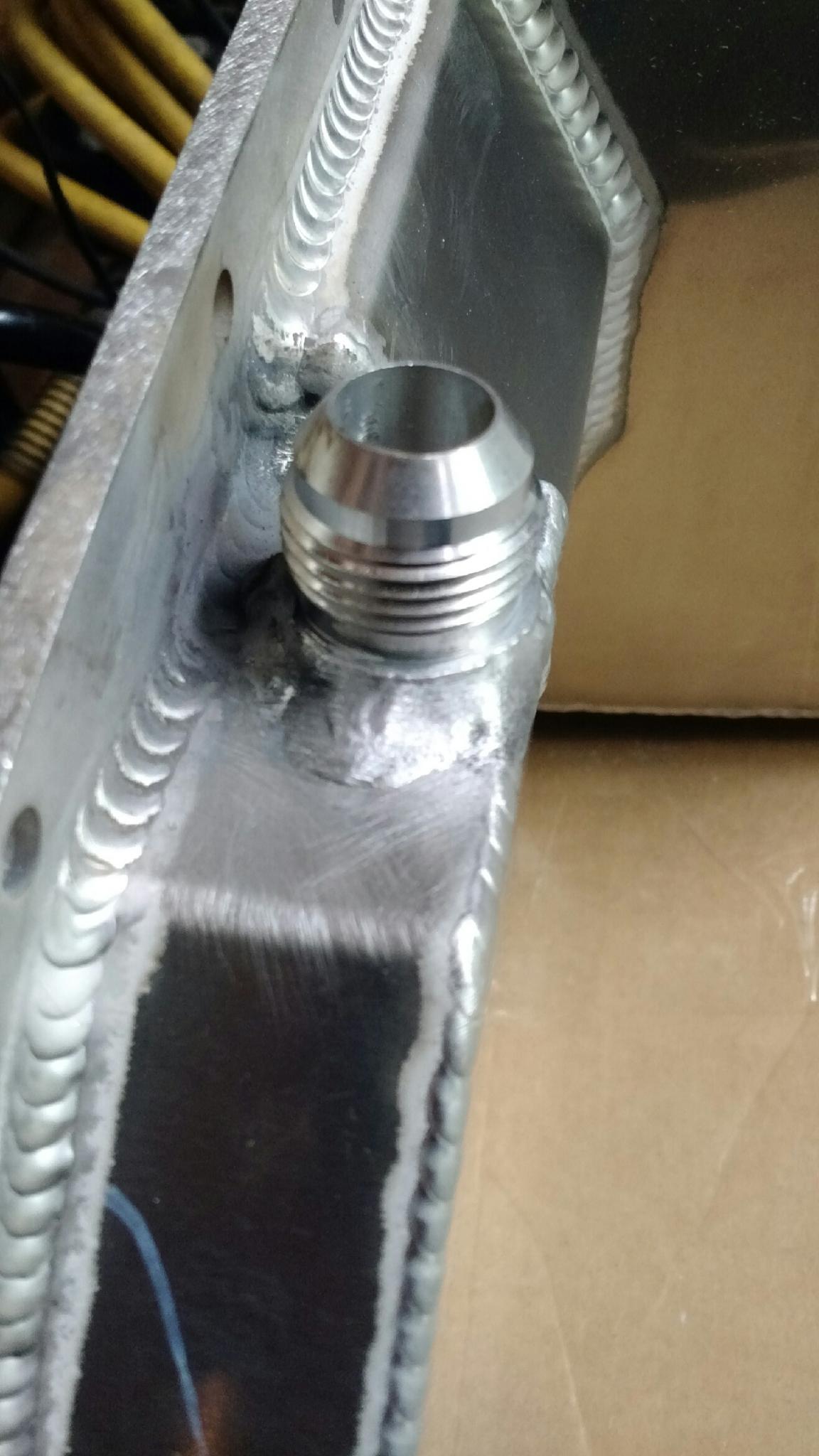

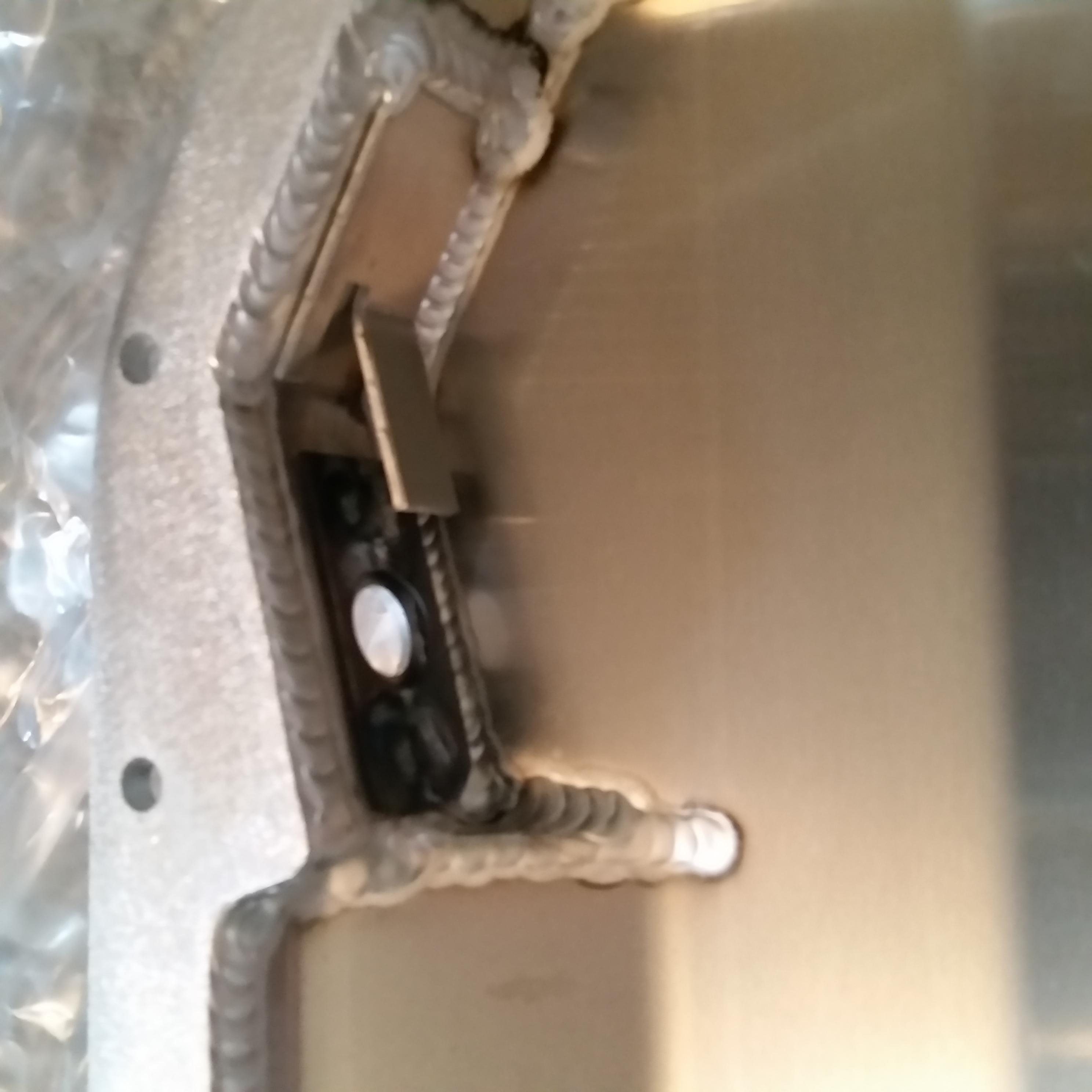

Well small update.
New items added.
I got my 12an fitting welded to my moroso pan on friday.
Since I don't have the lock key for my lug nuts I bought new set of Mishimoto locking lug nuts.

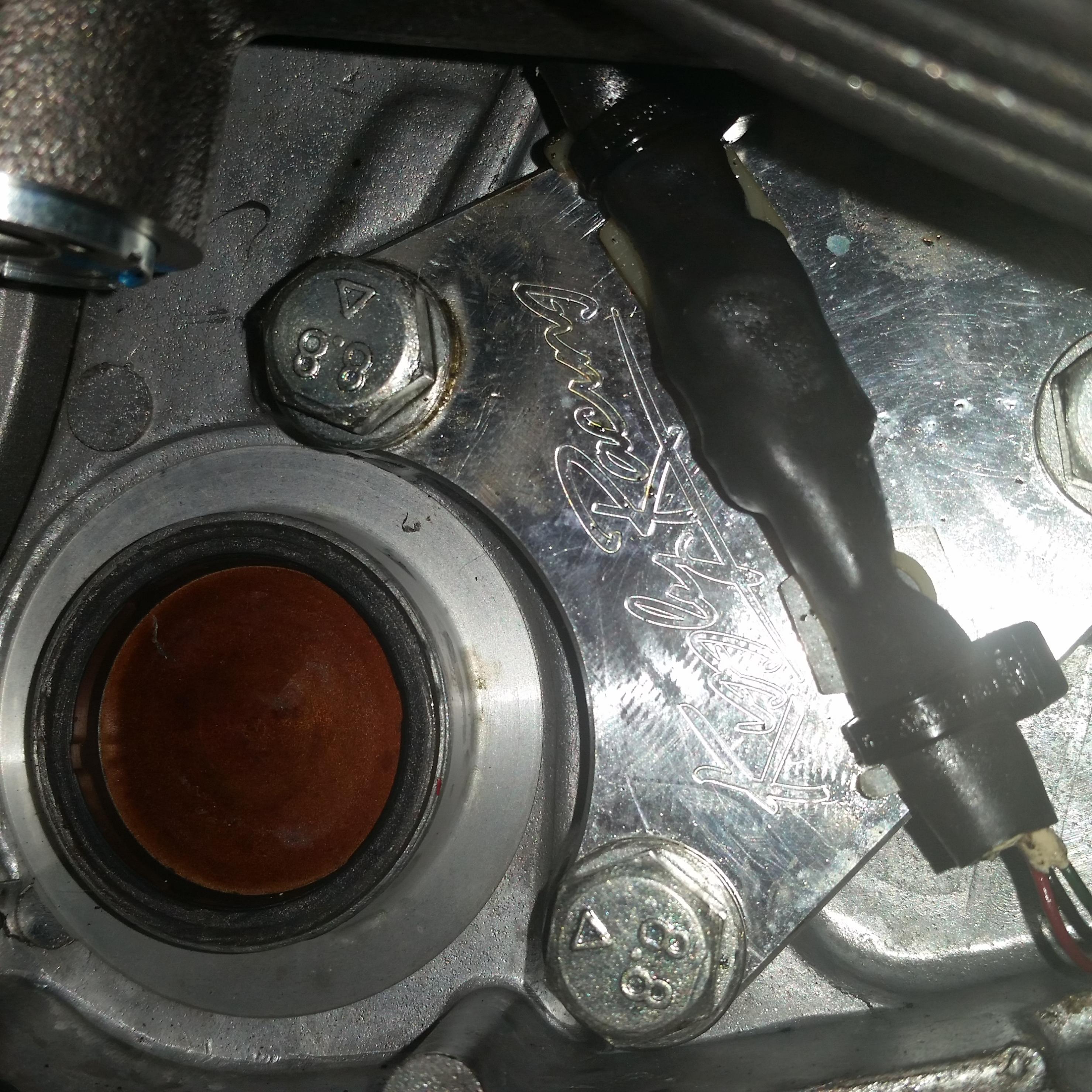

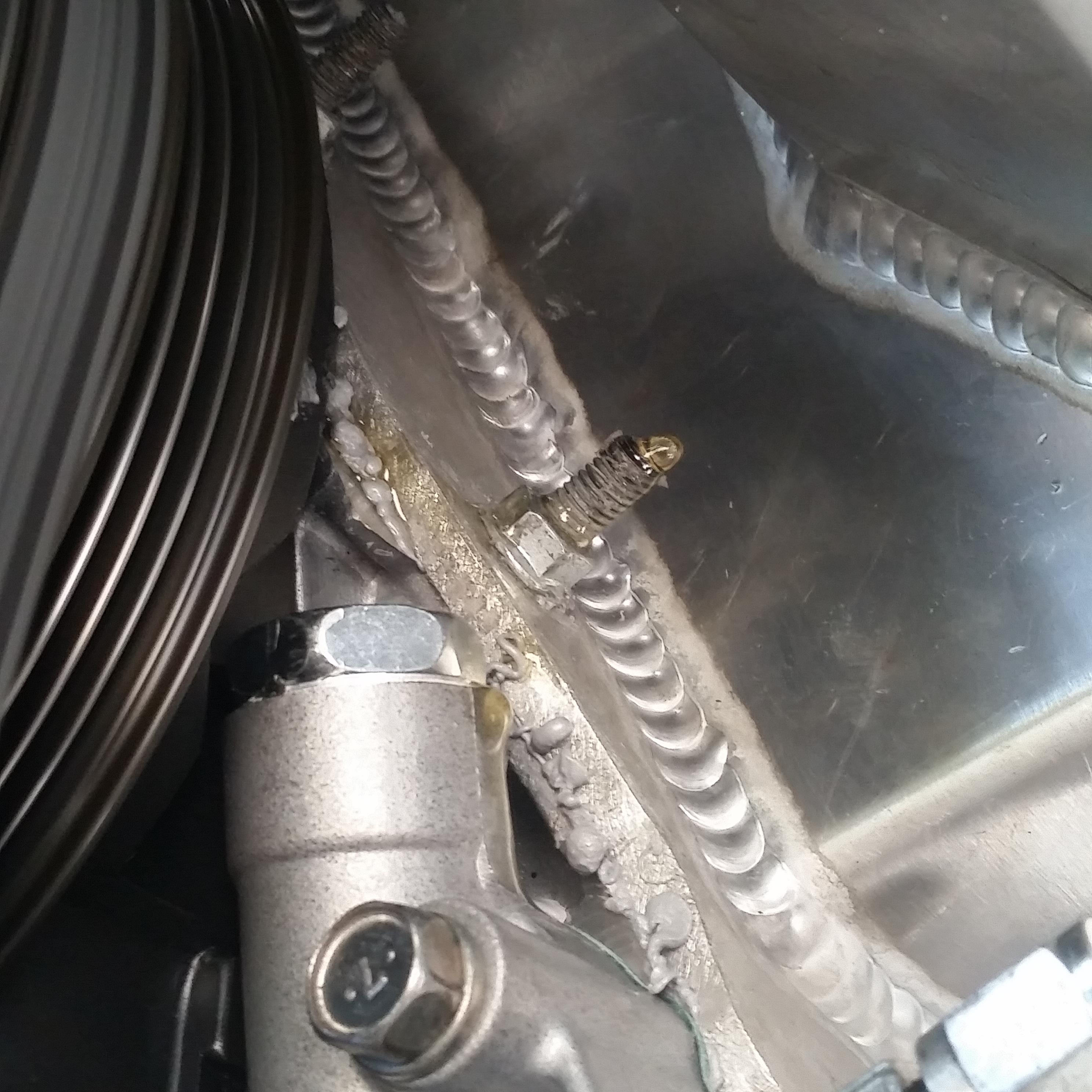

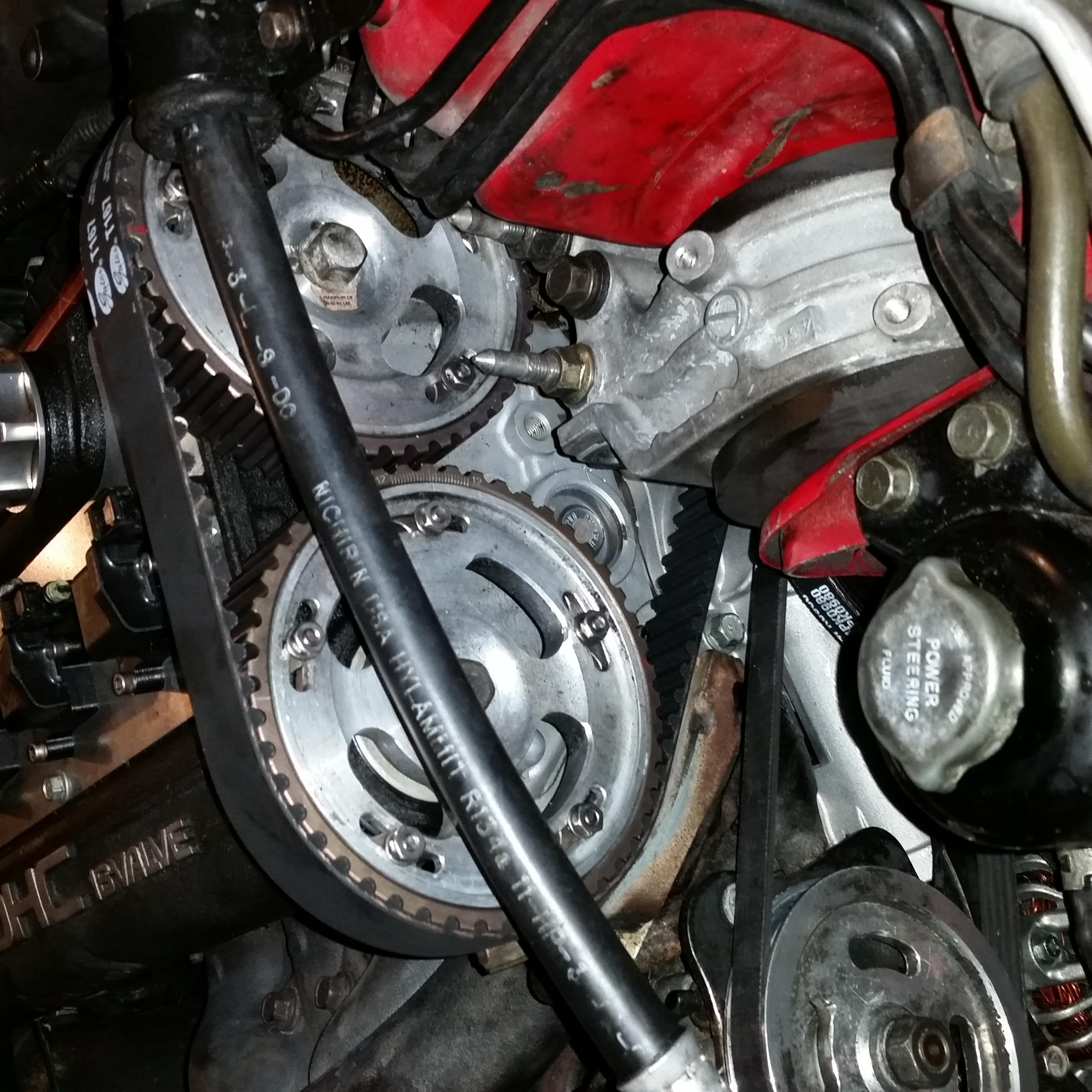

Old 05-23-2016   #10
Well all new:
Gates timing belt kit installed with new oem tensioner.
All new accessory belts
moroso pan installed
Mishimoto lug nuts installed
-note the adapters that the aem digital oil temp come with won't work with the moroso pan. I'll have to order a 1/2 inch to 1/8 adapter.
Also my 12an fittings to finish up the oil drain line still haven't shown up. (Supposed to be here end of last week but are still on back order with extremepsi.com)
I was also very please to see that the Kiggly crank trigger was there as listed when I bought the car. (Should have taken a picture but slipped my mind)
As well as the car has at least poly side motor mounts. Which I wasn't aware of. They are black from dirt but where they were protected by the sides of the motor mount, the red was still nice and clear.

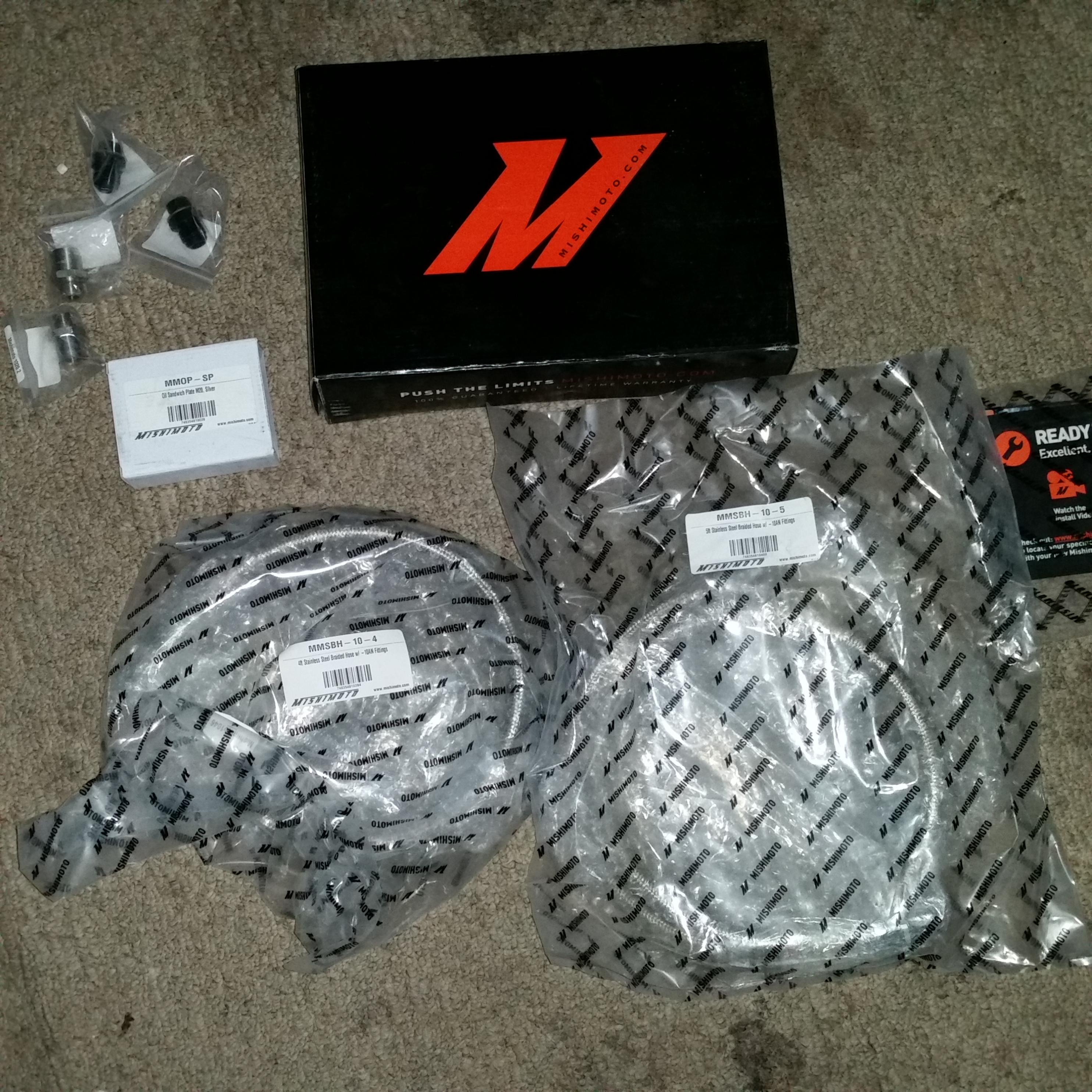

Old 06-02-2016   #12

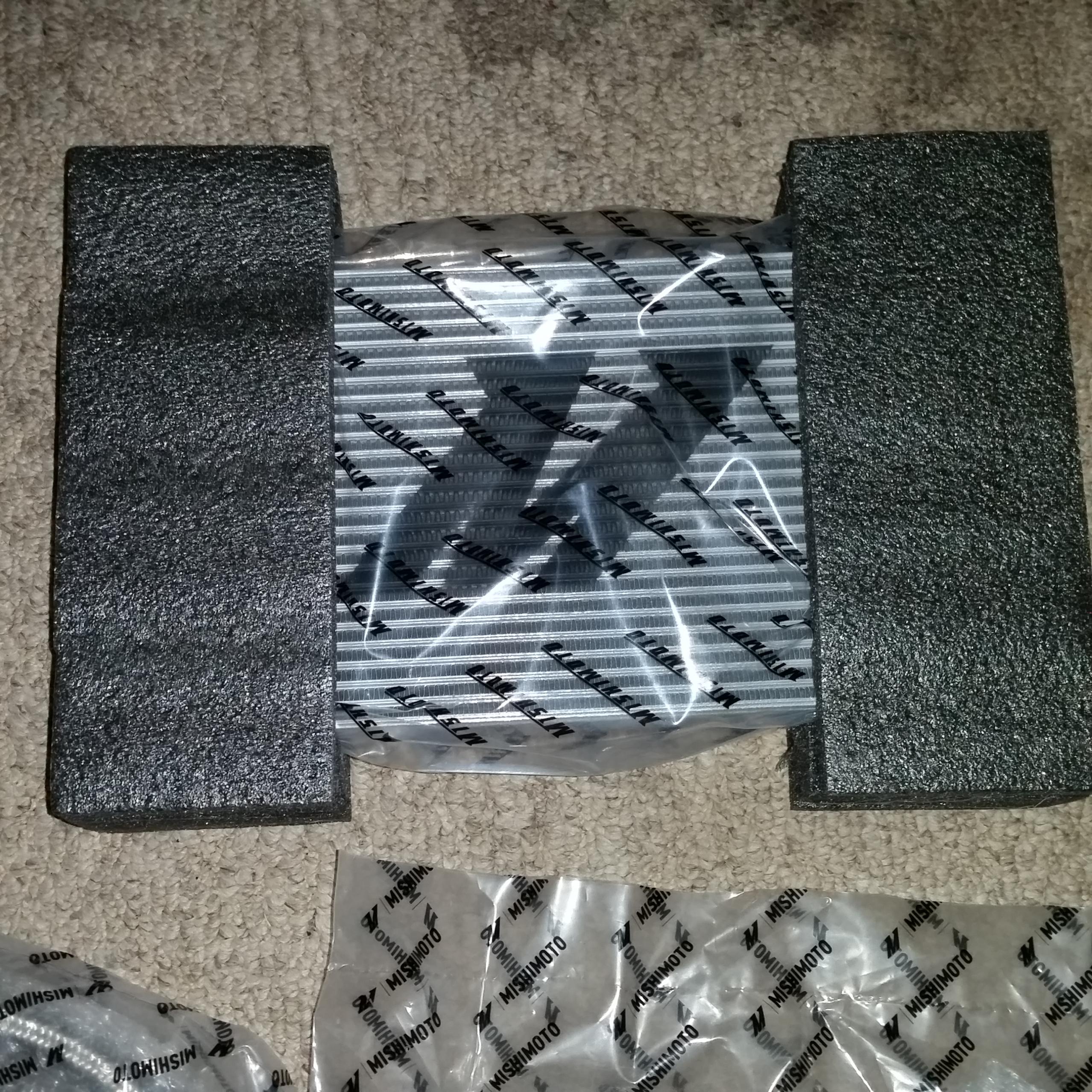

Mishimoto 25 Row Oil cooler kit, came with the 12an fitting and 12an line I needed to make my oil drain with.
Only they still haven't shipped the 2nd 12an fitting I need to finish the line (been a month already)

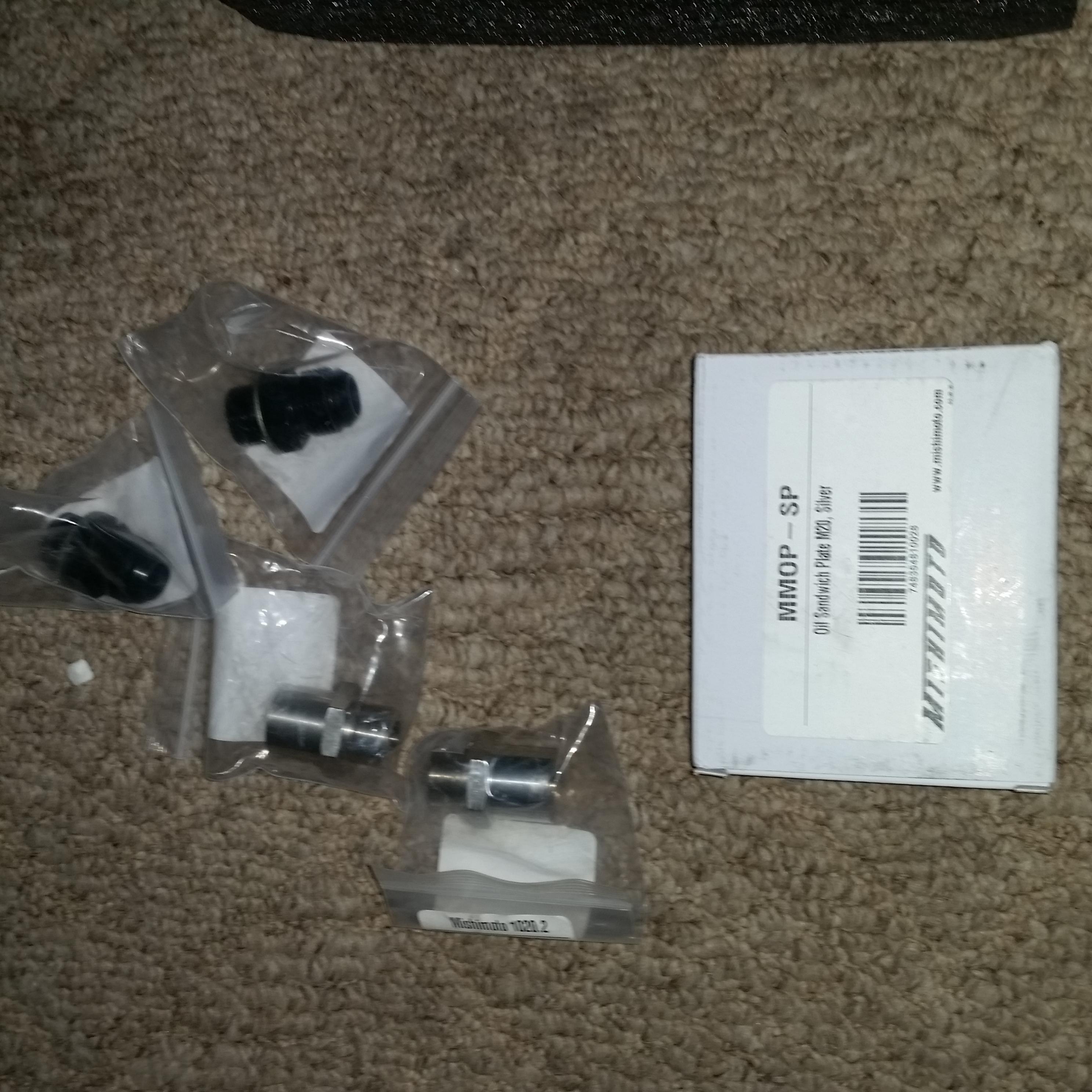

Old 06-05-2016   #13
Well got started on mounting my oil cooler today.
Got the sandwich plate mounted:
Just need a 27mm socket
And the M20 x 1.5 adapter from Mishimoto torqued to 40/lbs
Anyrate went to clean up that mess of oil lines under there as the sandwich plate has 2 ports you can use instead.
And when I went to tighten the turbo feed line to the oil filter housing I cracked it in half. So now I have to get a new forward facing oil filter hosuing.

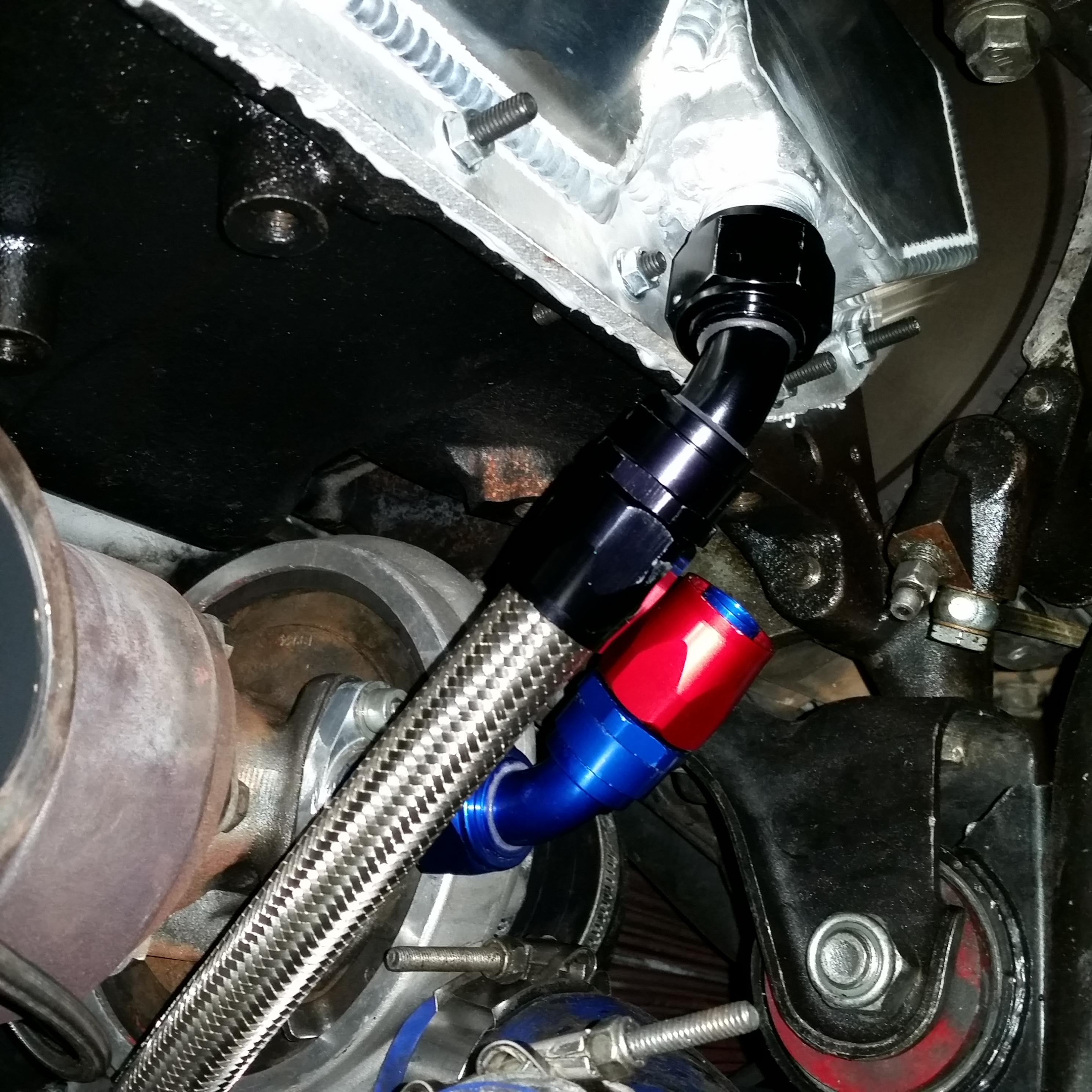

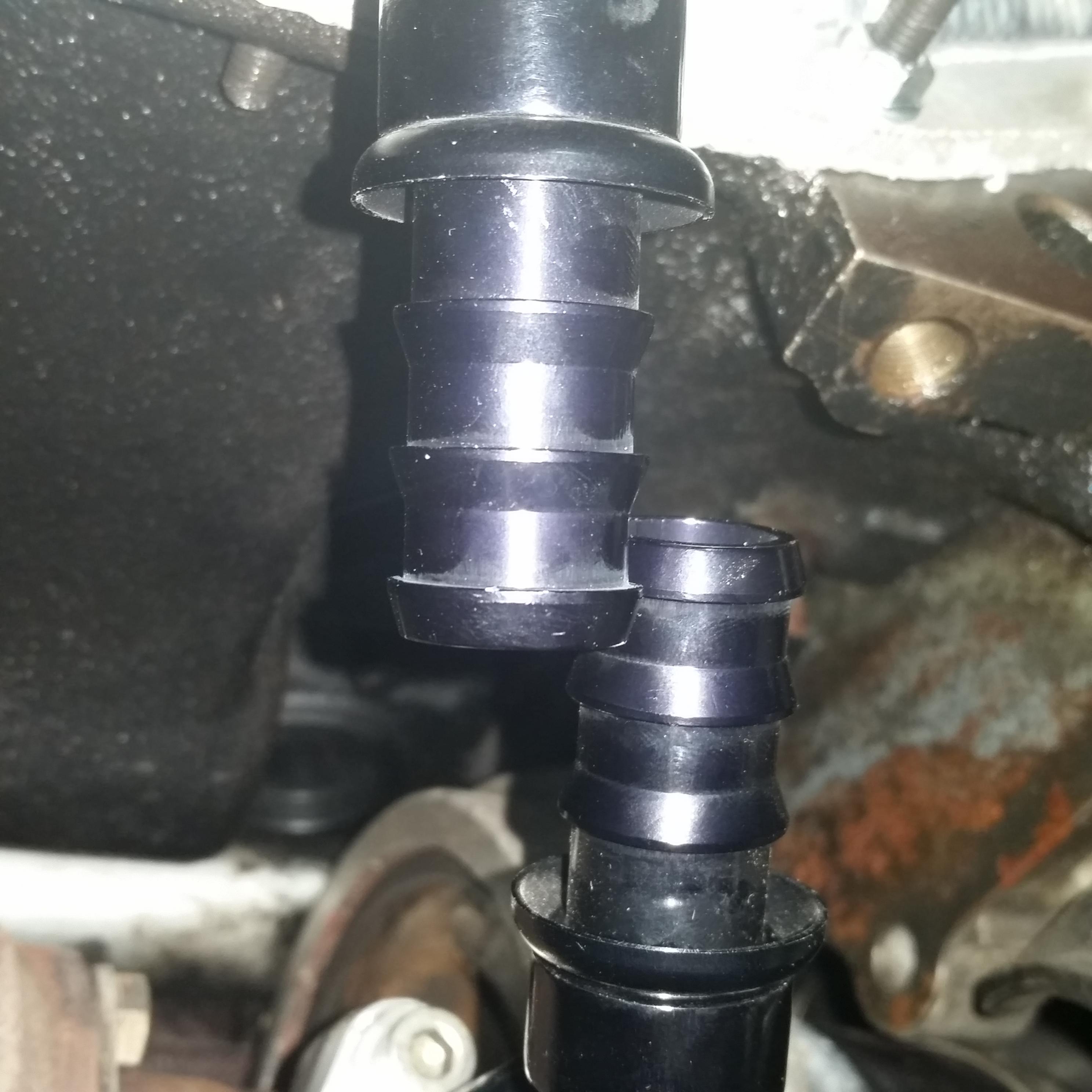

Old 06-15-2016   #14

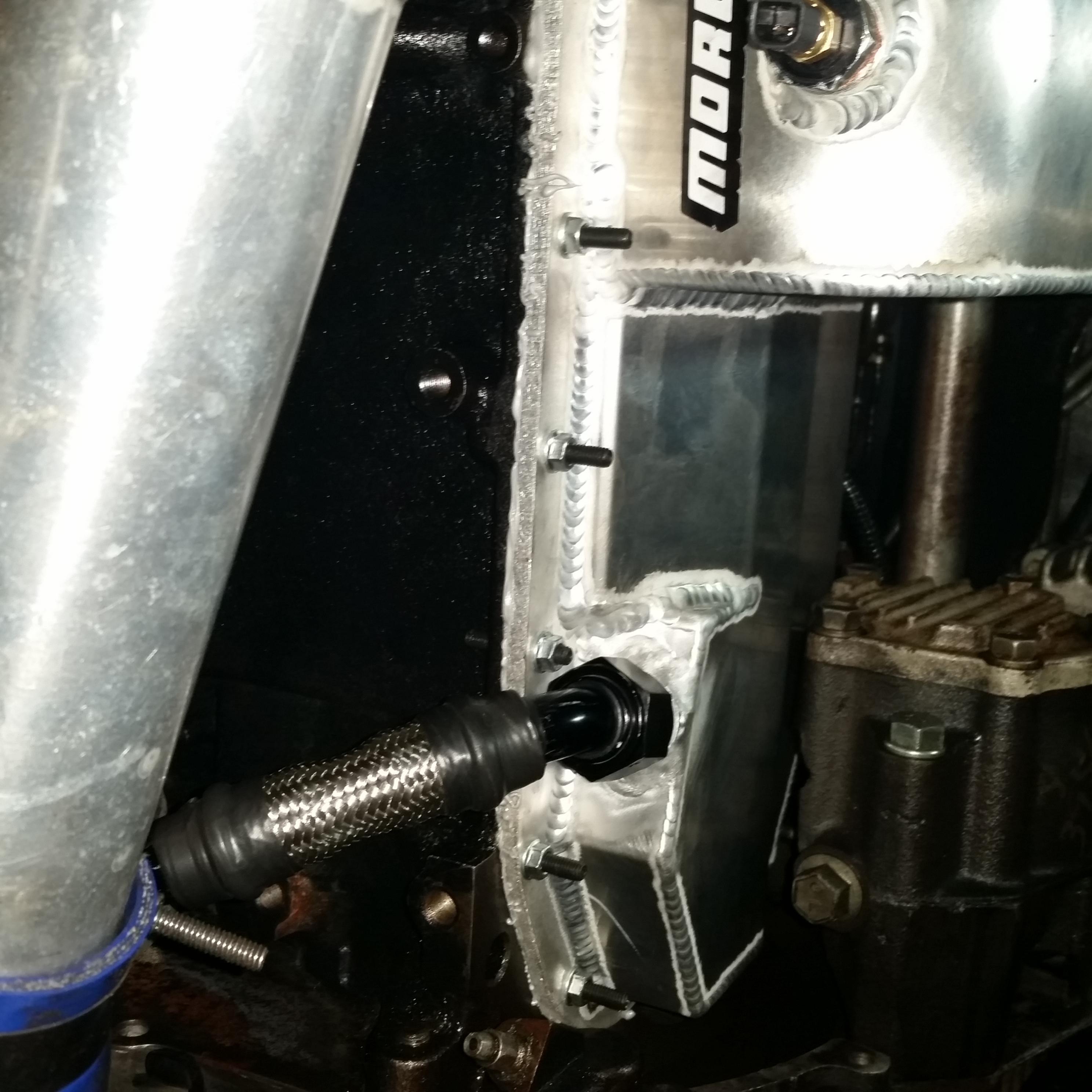

12an oil drain finally done.
(Months of waiting for fittings only to be to large for the distance between turbo and drain on the pan.
12an standard fittings won't work. Finally had to go with 12an push on fittings and then cut them down to size. And took a "press" at work to finally get the braided line onto them. Was a pain in the ass.

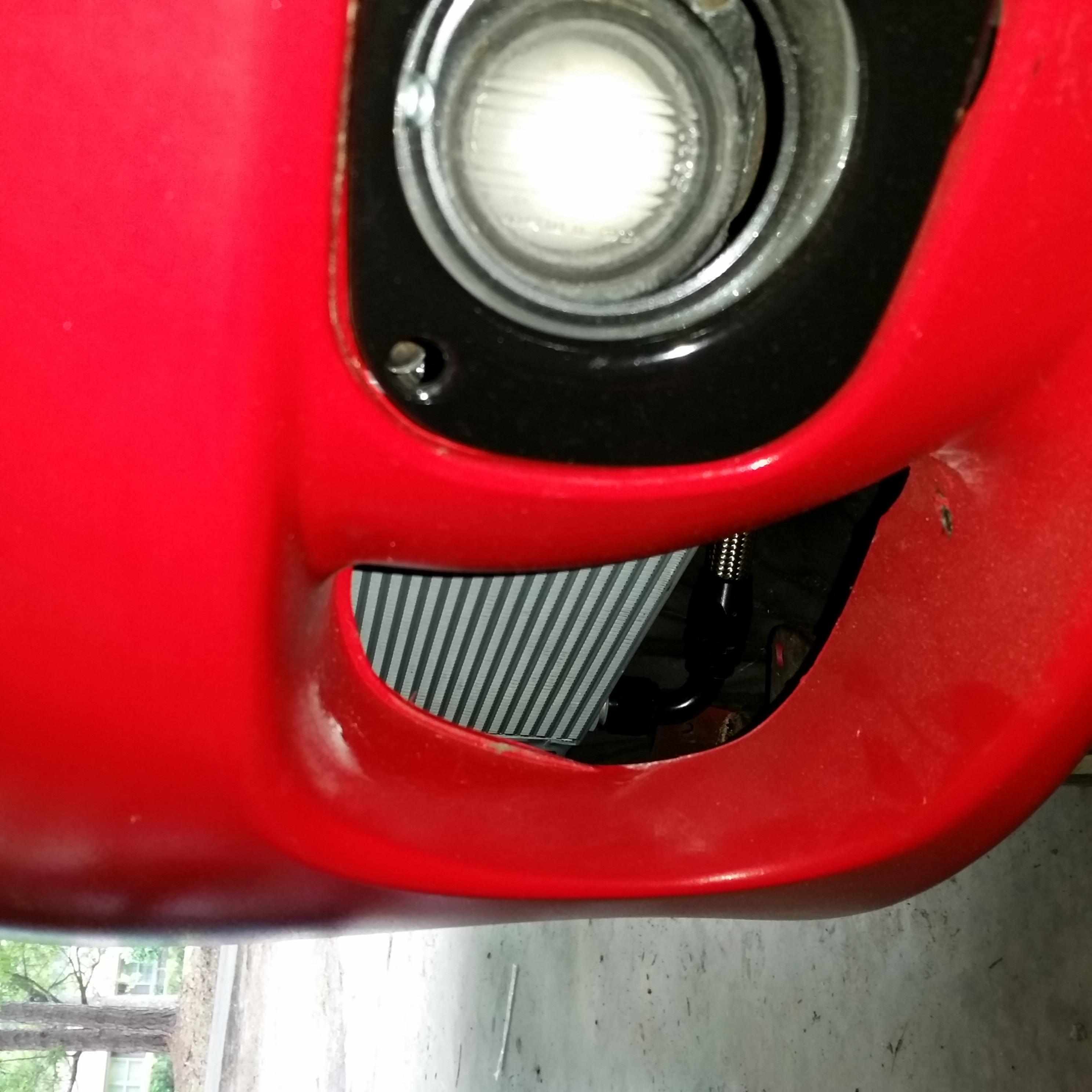

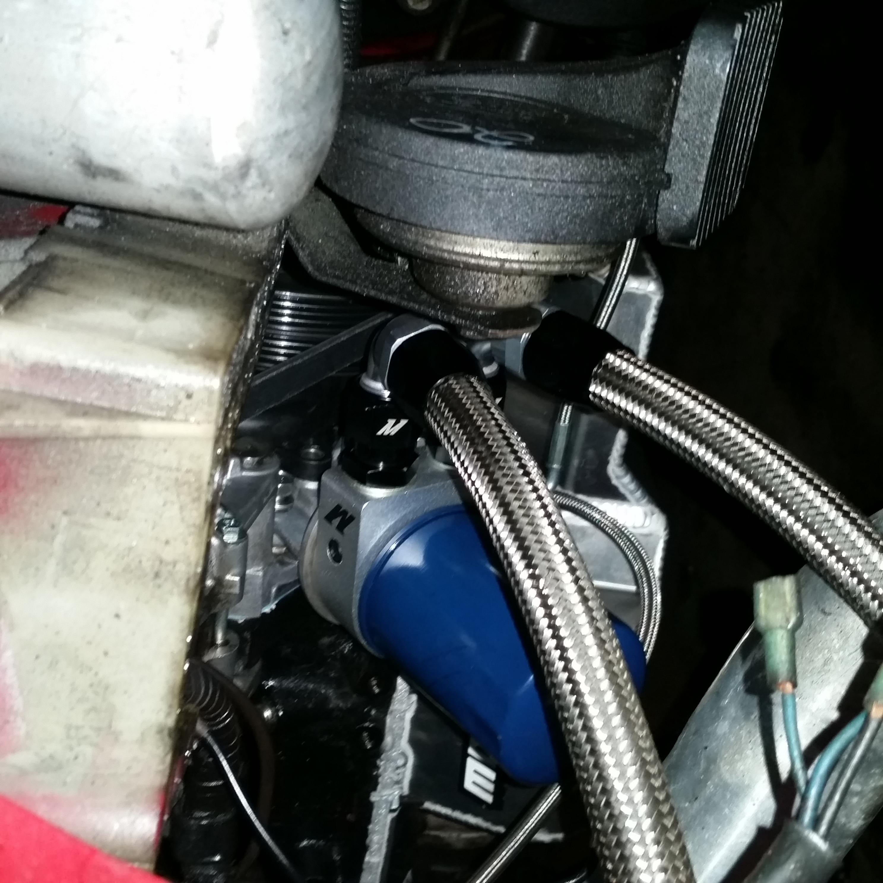

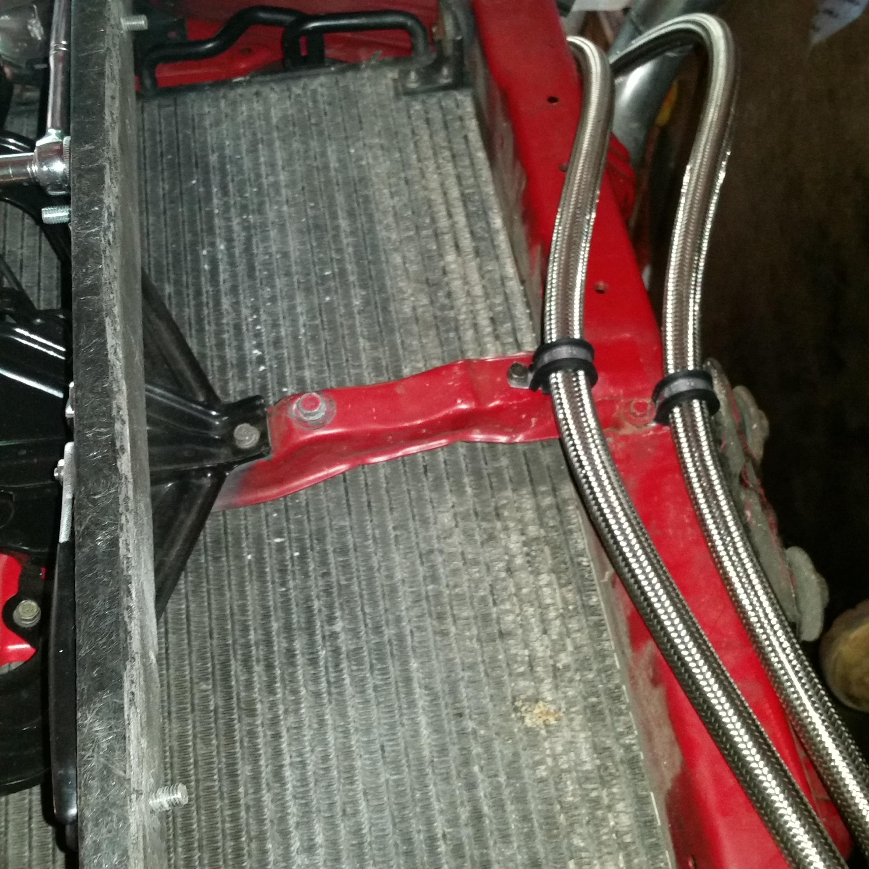

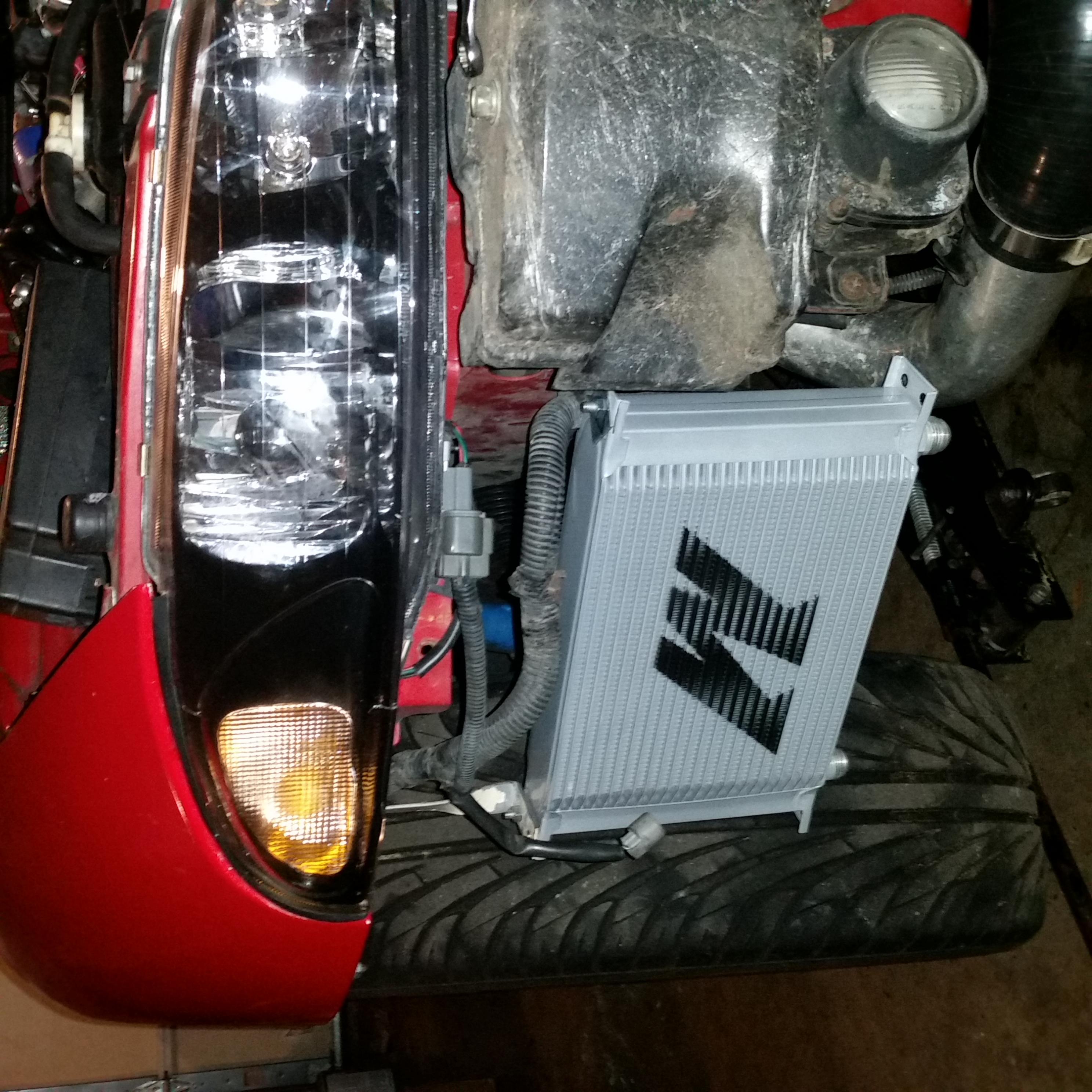

Old 06-22-2016   #15
Almost finished with the Mishimoto 25 Row universal kit install.
How to run the lines are the only issue left (fingers crossed I haven't tried to put the bumper back on yet though.
Currently the lines running/mounted behind the fmic I ran into an issue where they weren't long enough avoid the i/c piping (I couldn't rotate the fitting enough to clear)
Which was a huge let down as I thought I was all done.
Buy anyways here's the progress so far. If I can't get it to work on this location. I also fabricated brackets to mount the cooler between the FMIC and a/c condensor.
The only thing so far I had to change about the kit is I had to change out the "straight fittings, for a 2nd set of 90 degree fittings", the forward facing oil filter housing makes it so you need them.

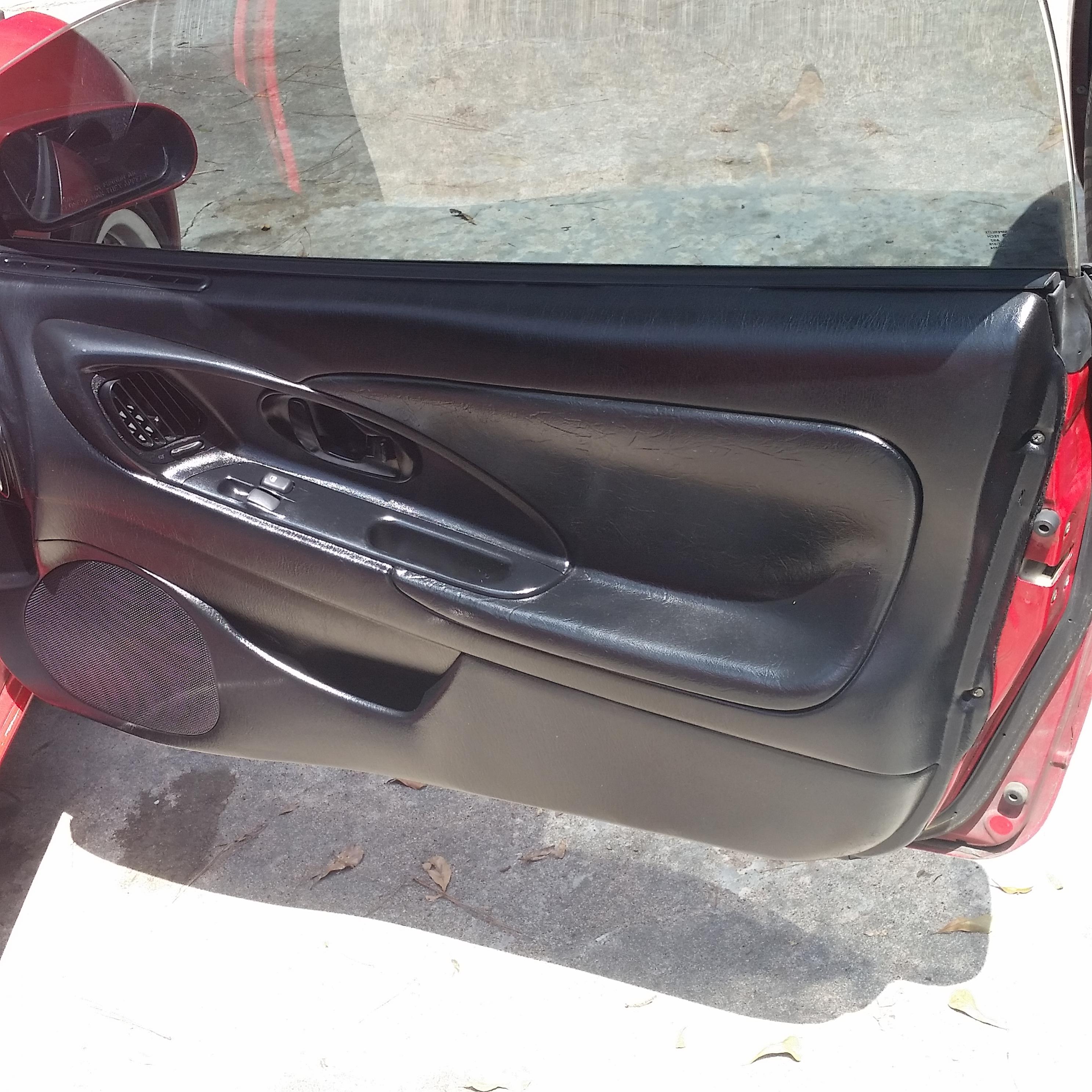

Old 06-22-2016   #16
Update also - father's day I got around to installing the 2001 eclipse black leather seats. As well as the dodge avenger doors (black/grey that I dyed black) amd the black door handles and plastics.
The last parts I need to complete the black interior swap. Will be the dash, a pair of sparco racing Seats, Sparco Steering wheel with quick release, and black seat belts or harnesses.
I'll update the door picture to a better one later. The door is jet black. But the flash ruined the actual color of it in the picture.
I also got a new passenger side airbag to replace the one in the car that has the typical sun warp to it. Just have to install it

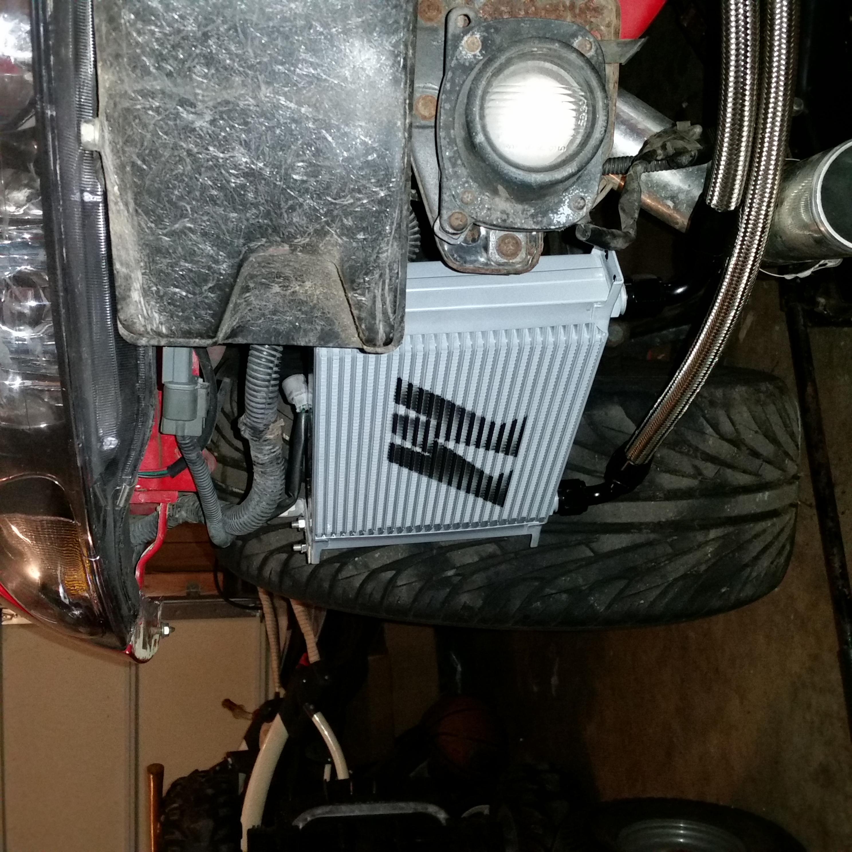

Old 06-27-2016   #17
Finalized the install, bumper fit perfectly
