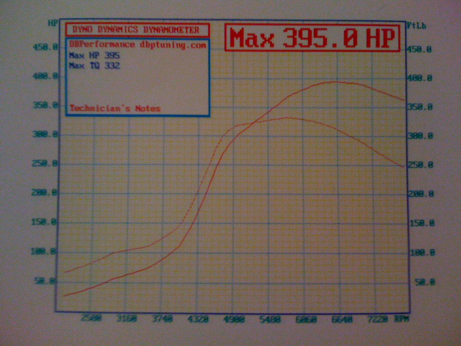

I meant the rate of acceleration, t28 in 2nd felt like it does now in 3rd, thats a pretty huge change. I guess I can post a graph, just for you Scheides.
Shane had it to something like 405 a few times, but I think he said he backed off the timing a little for a safer tune.
Seems to be a pretty healthy powerband, I'm very pleased with the results, now I have to not touch anything in order to have a direct comparison to DynoJet on the 27th.

Re: Make slowboy not so slow
Nice numbers!
Sorry, I'm just excited, I can't even remember how many boost leak tests we've done on that car Awesome. Torque is pretty late for a 2.3 IMHO, but makes damn good power up top! Gonna keep her together now?

Yea I guess I should post major mods now that the car is mainly "complete".
2.3 liter
FP red turbo (60-1 size)
FP4r cams
JMF intake
I'm happy with the numbers, torque is lower than I expected but no big deal. I wonder how close I am to maxing out the turbo, not sure what max boost could be on a stroker.
