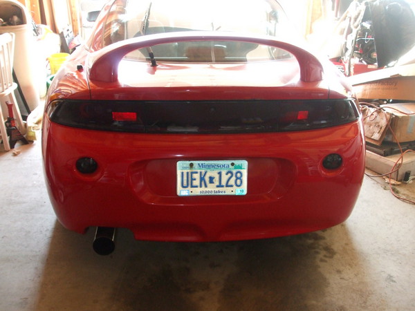

Couple of pics of the car now. The hood has about 1mm of dust on it thats why it looks like that. and the tail lights and reverse lights were done by Primo a while ago just got them on. they look darker in the garage but there only a cherry tint and not black.
ID:	11792   Click image for larger version

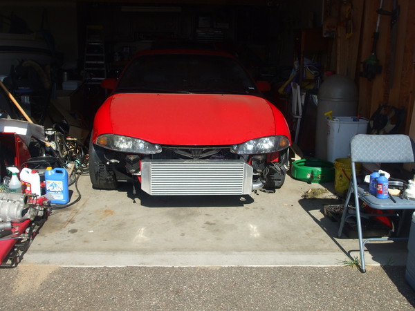

also is a pic of the exhaust that I am stuck with at this time but will eventually swap out to my old one.

I would have to say that a red car looks way better with factory untouched taillights. Hurry up you will make it to the MAP event!
Way to be a dick about it.. I happen to like the tail lights thank you.
