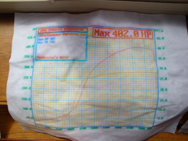

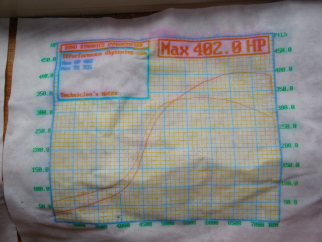

At Porkys last night Scheides asked to see my graphs, and I thought they were in my trunk. I didn't see them. I looked for them this morning, and sure enough, they were soaked in my trunk under a shirt... Thanks broken trunk weatherstrip.
Here are my wet graphs.
HP/TQ and HP/BST

Not making excuses. But from my experience, boost comes on earlier on the street because the motor is actually under more load. That could account for the 20psi by 4400rpms on the dyno vs. others STREET logged 4100-4200 threshold for that boost number. And also, can't remember your setup, but a ball and spring MBC which several others use can make a significant difference.
Still cant complain about +325ft-lbs of torque before 5000rpms with a bolton turbo at 26psi at that same rpm. Considering your uber conservative timing for your CR and e-85, it would be nice to see you push it a little farther before you sell it

Looks a little laggy but that thing has got to tear your fuckin head off after 4k rpm!! Nice to see what a Holset can do since not many people run em.
On the street it's 20+ by about 4000 rpm.
I'd say it really isn't that laggy when you're driving around normally and cruising.
When you want to go, it goes.

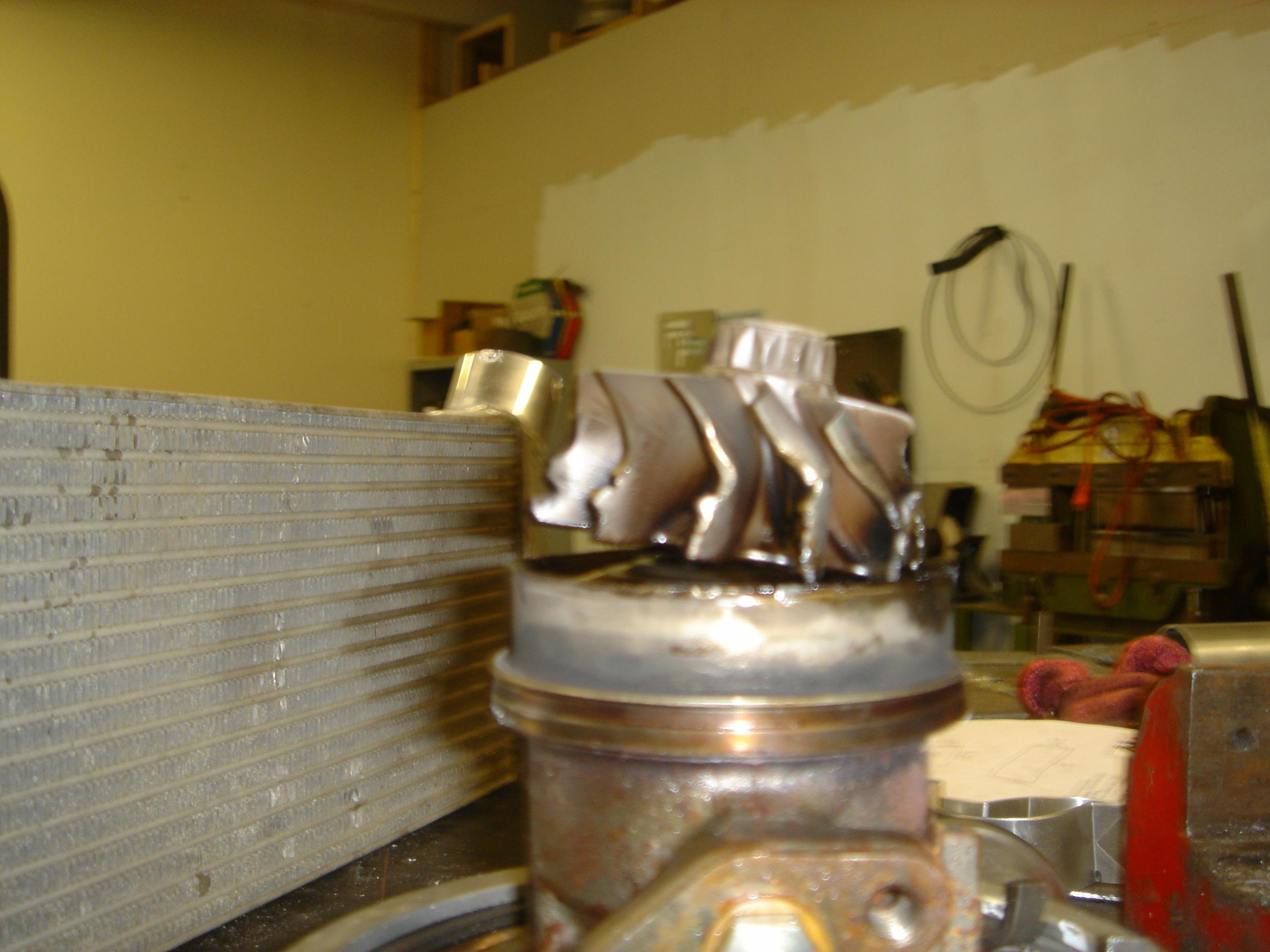

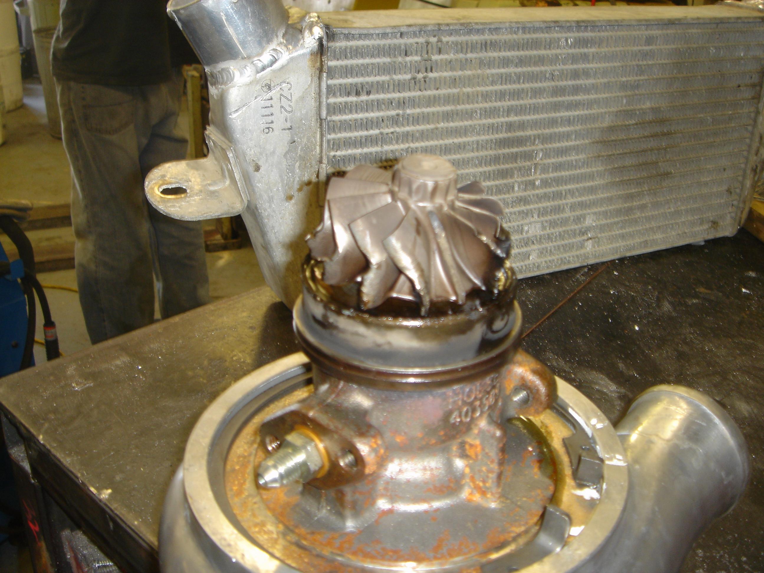

Feed fitting came loose tonight.
Turbo seized.

That sucks! At least you caught it before it shot all the oil everywhere and caused engine damage.

Fuk dude that sucks . Time for that 16g? 20g? I've never had a fitting come loose like that; ghey in the pants.

Hmm, maybe time for a new turbo?
