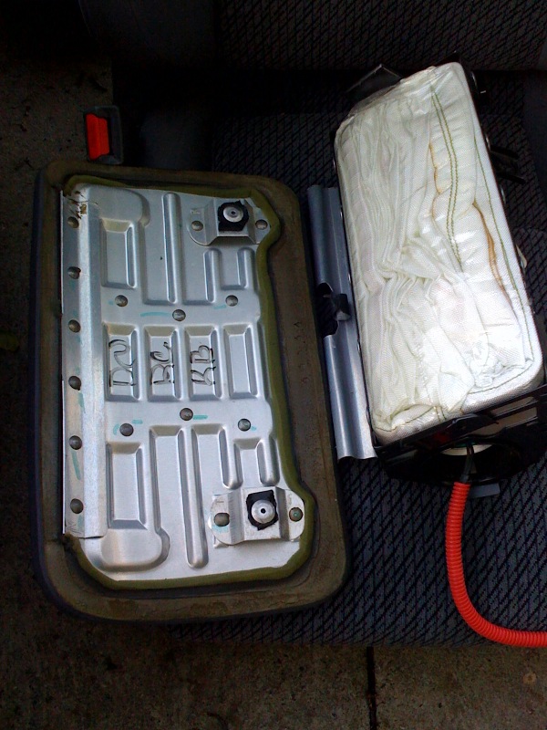

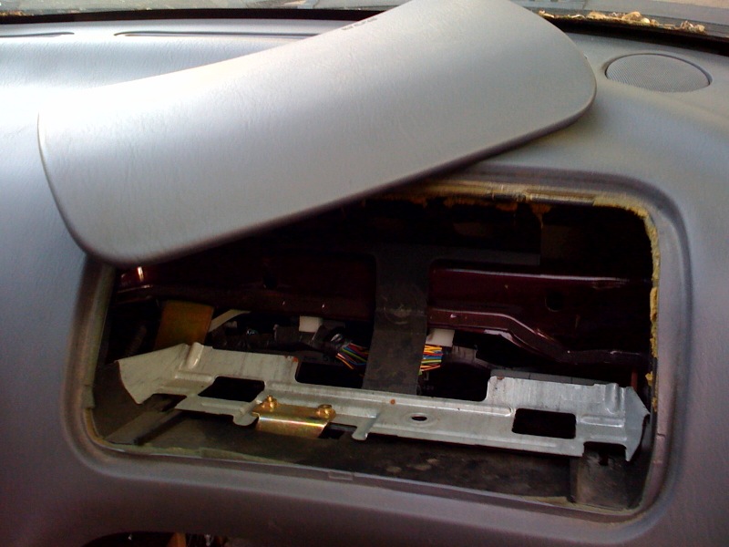

Removed the passenger airbag:
Here is the cover about to go back in:
Airbag computer:

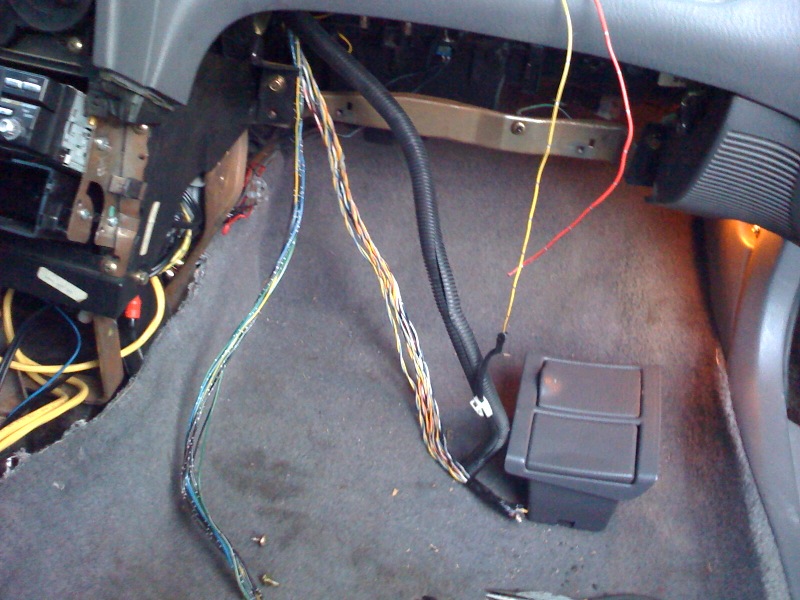

And a bunch of wiring that was no longer needed. Left group was for the airbag computer, right group was for an unknown harness under the passenger seat. The only thing I saved out the entire bundle was the ebrake light cable (hanging yellow)

The right group is wires for the stock infinity amp under the passenger seat.
Thanks. At first I thought it was for a powered passenger seat, but there's too many wires. Also, that explains why the red wire that's hanging had power without the key on. It sparked on me when it touched a ground, lol.
