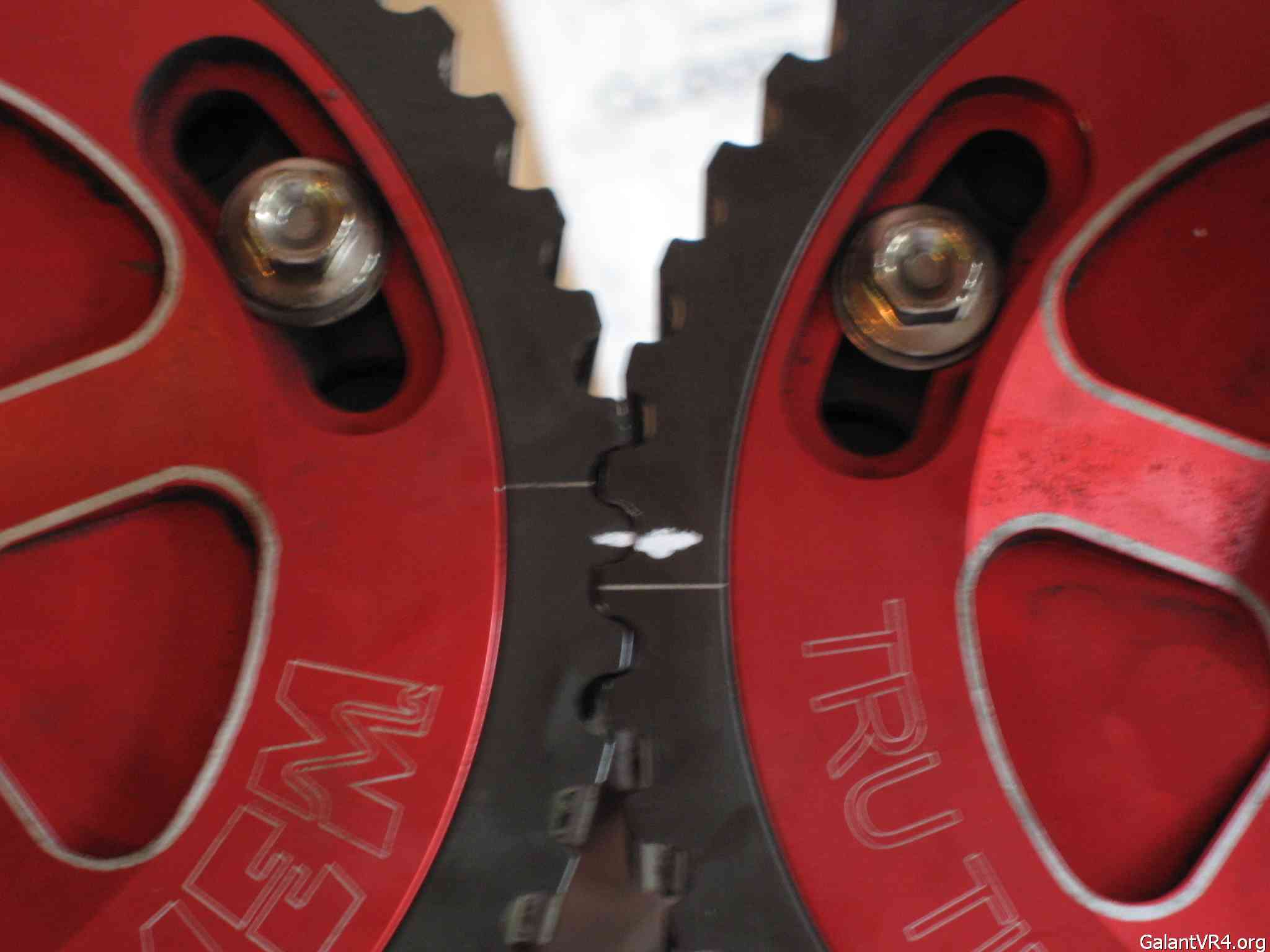

just use stock cam gears. you can re-mark them yourself and spend the 40 bucks somewhere else!
Old 10-31-2006   #28
Re: Engine Building-What Products?
Yeah, there is no need to buy 2.4 cam gears.

The cam gears are off by 1/2 a tooth. How do plan to re-mark them? Either way you are 1/2 tooth advanced or 1/2 tooth retarded. Buy 2.4L gears or adjustable 2.0L gears and degree them in like I did.
From reading this thread, you might want to let somebody build it for you.

You could remark your 2.0 gears, they'd be exactly half a tooth clockwise from the original marks. Like Vicious, I bought the 2.4 gears, timing is just not something I'd do half-assed.

Just mark them like this. Yes i know they arent the stock gears but who cares? The marks line up the same way.
Damn, homie's got a gear drive set-up.
If I remember correctly the difference is about 4.5 deg of cam timing in either direction. Ask anybody who's done building and/or tuning and they will tell you 4.5 deg is alot. Do it right. You'll spend many times the cost of the gears trying to get back that power difference.

shane, mo and cher all made some pretty respectable power with remarked STOCK CAM GEARS friend

I remarked my timing gears, I bought a 2.4 timing gear from mitsu to overlay on the stock 2.0 gears like forever ago. I have no idea where my 2.4 gear ended up, I know its floated around the community for remarking stockers. No problems here, pretty simple modification.
I seriously doubt that. Do you understand where the problem is in running the 2.0L gears on a 2.4L block?
Mike what are you saying? Shane, Cher, Mo, and myself all overlaid a stock 2.4 cam gear on top of a stock 2.0 cam gear and remarked the timing marks. Pretty simple and widely done, back when I did the 2.4 swap I don't think there were 2.4 cam gears available other than stock.
