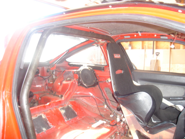

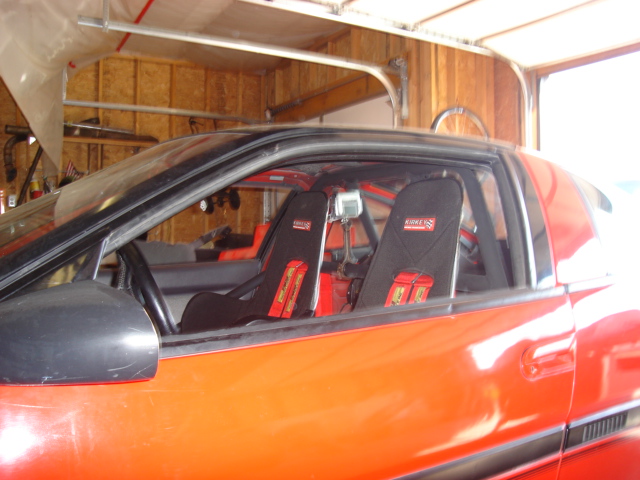

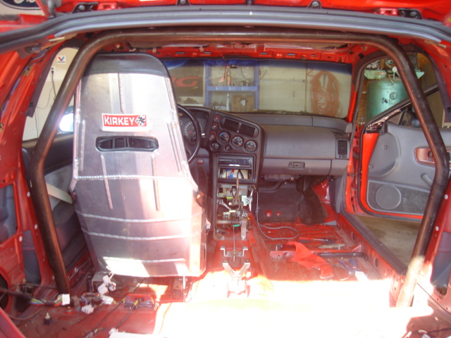

Josh, did you guys build the one for your stealth with that bender? It was real nice. I'm really leaning towards getting one built, rather then a bolt in kit, because I think a custom bent one would be able to fit a lot smoother/cleaner, and be able to be closer to exactly what I want.
My Main hoop was bent with there bender. I got the hoop and the straight bars and welded it in myself. John even borrowed me his old tubing notcher.
A 6 Pt with swing outs would be nice in a street car. I really like how safe I feel in my car just driving around.
