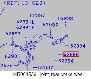

Something else I'll post up that I just found out about the lines. The problem is the Cobra calipers need a banjo style line (just like 2G's). So I ordered up those 2G lines, hoping they'll work.
Something I just found out, now that I already paid for the damn 2G lines, is that on 1G FWD models, there is a fitting on the rear brakes. Rear FWD 1G brakes have banjo style calipers. But there is a fitting that converts the Banjo caliper, to accent a standard line. You can simply steal that fitting from a FWD 1G rear caliper, and install it onto the Cobra front caliper, and a stock 1G line will fit right up.
Here's a picture from CAPS showing the part.

If the 2G lines even work. I am having a hard time finding info on lines. So I just decided to spend the $40. I'm still going to try and search out some of those fittings in case the 2G Lines don't work.

Got ahold of Brookdale Mits, and those little fittings are $25/ea. So scrap that idea, unless I can find some from a parts car or a junk yard.

25 bucks is high but if you already have ss lines, i guess its just one of those things, also if the 2g lines dont work it should still be an option to be tested out. plus im sure you could hit up you pull or some where and get them cheaper
i still do think the 2g lines should work though.

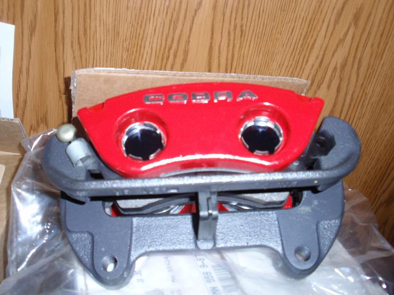

1st pieces showed up at the door today

haha those look better than mine :P
