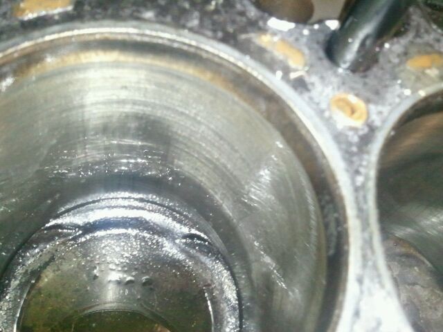

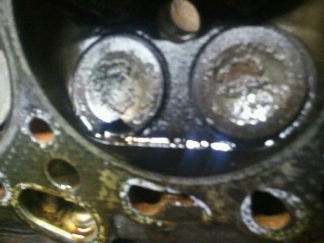

Took the head off and BAM a chunk of the exhaust valve on #3 is gone!

What should my next step be? Think I should get new valve guides?

Was that an exhaust valve? I would be trying to find that piece, get the head checked out, and check you turbo if that's an exhaust valve all for starters.
Old 08-17-2013   #28
Re: 3/4 cylinders
Take the head to a shop, have them fix it. Try to find the missing piece. Put it back together. Let r buck.

Is there any cylinder wall damage?

No cylinder wall damage. Still have crosshatching in them. It was a #3 exhaust valve. Taking the o2 housing off now to put my external setup on and will see if there is damage to the wheel.

What could have caused this?
Taking the head over to Marks tomorrow to take the valves out and pick up a set of Jackson Auto Machine std size valves. Then the head goes to Gosh on Mon. to see whats up with it and reassembly.

just a burned valve does it look broke or like it was cut with a torch

im gonna assume its a burnt valve don't usually just break little chunks off

what causes a burnt valve? lean?

that or to little valve clearance sticking it open a little for some reason seems not possible with hydrolic lifters but who knows happens to saturns all the time

My injectors ohm tested fine and look perfectly clean.

The valve does have jagged edges where it broke.

than maybe a bad lifter pumped up and held the valve open a bit. what happens in saturns is there supposed to be adjusted and when people don't do it enough they wear out of clearance and hang a valve open and they burn just like that.

The cam cap bolt was a little loose.
