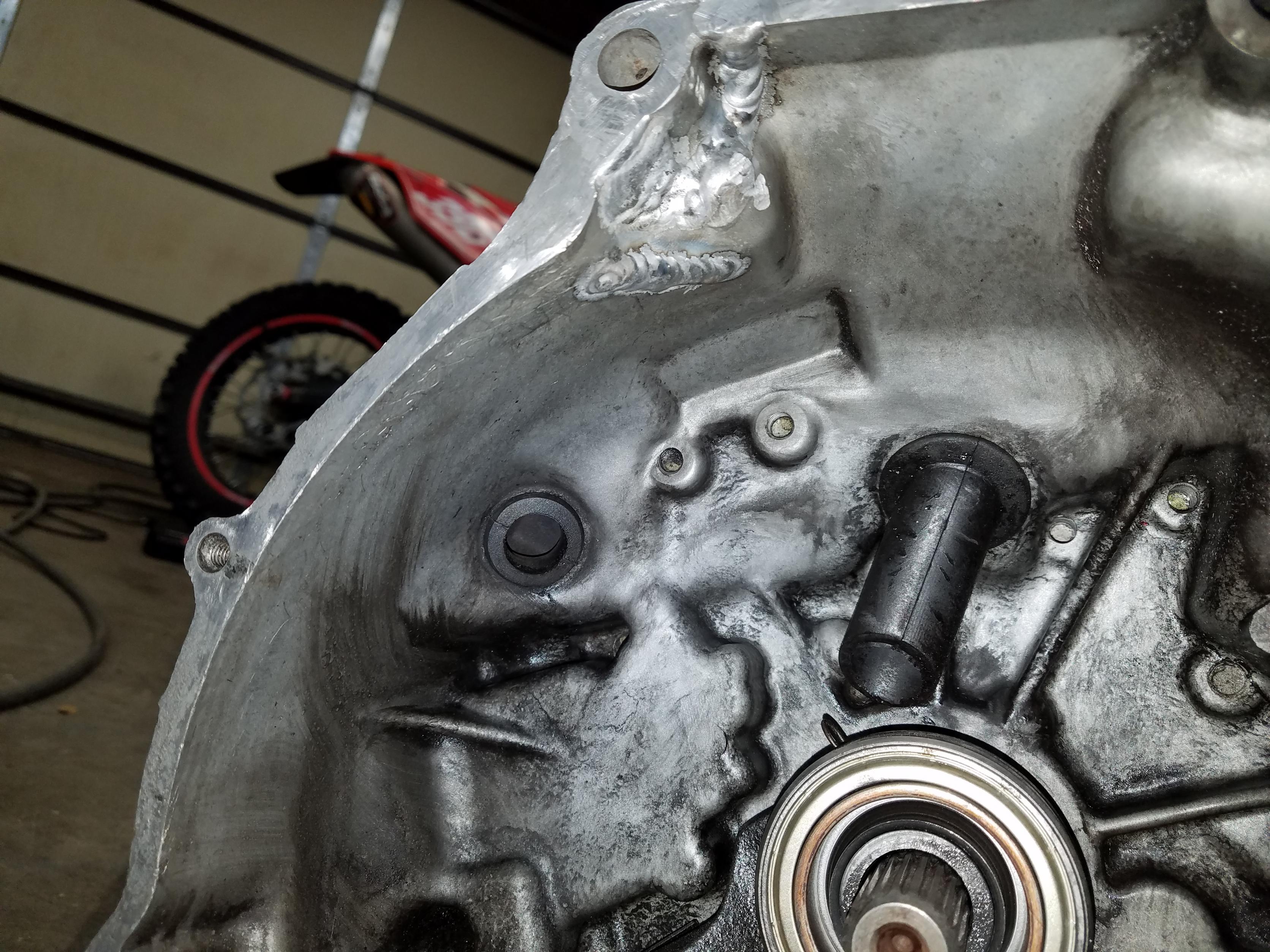

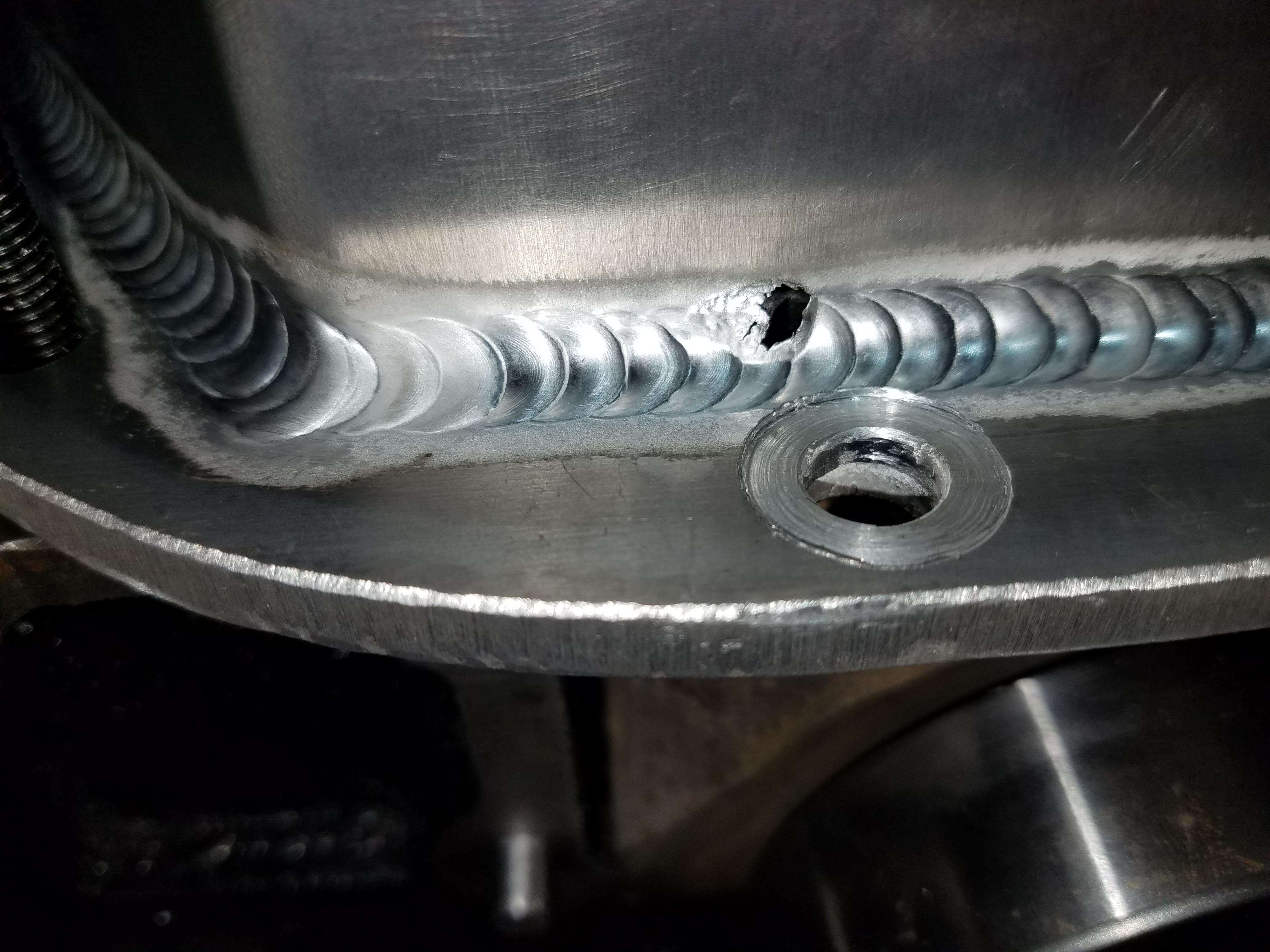

So it's been a while. Been busy tying up loose ends while the engines out. But the fuel system is ready to go finally. I was able to get a friend of mine that welds to fix the bell housing so I didn't have to disassemble the trans to swap bell housings (a task I was not looking foreward too), and he also welded up welded up my O2 housing with the piece of 321SS tubing I bought, so hopefully no more cracks.

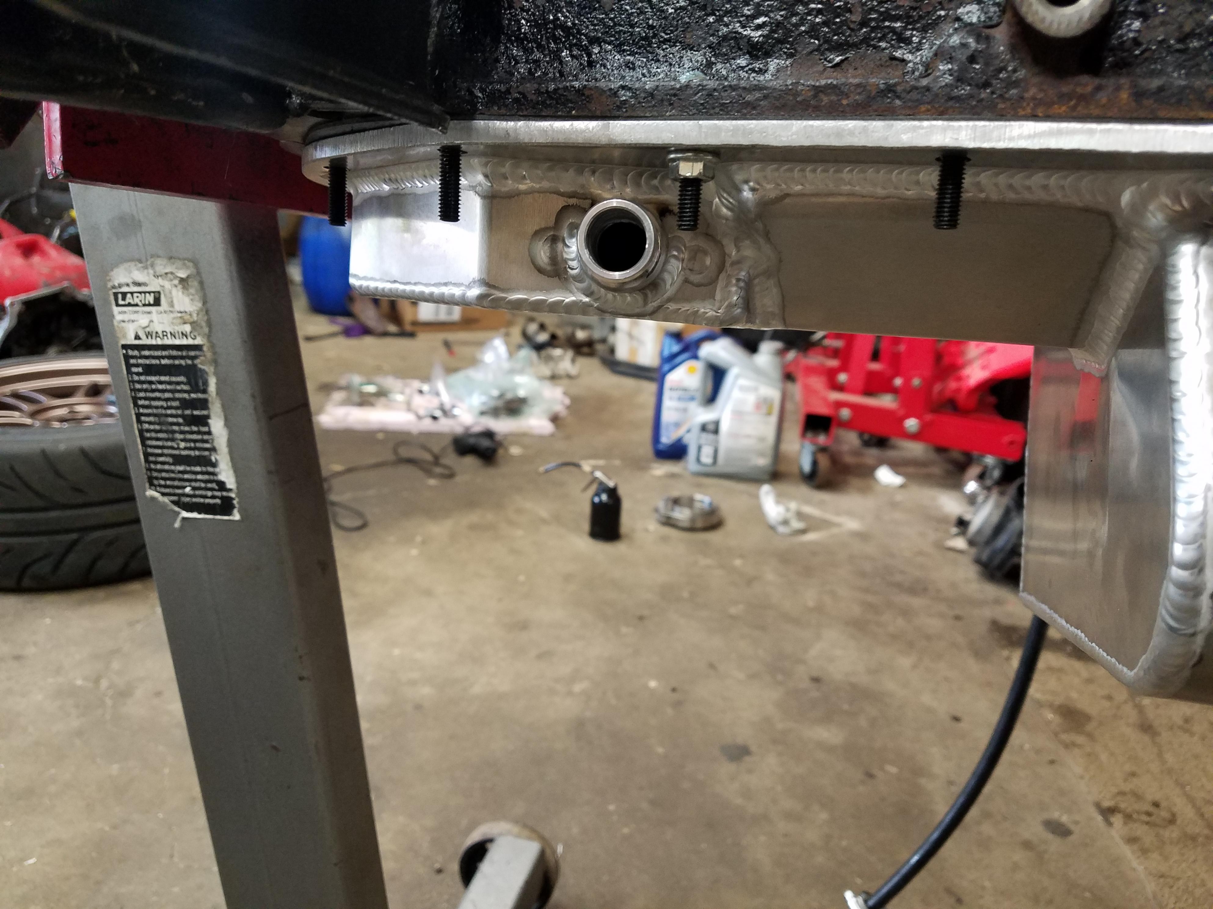

And he also did the welding on the oil pan. And fixed it after I had to relieve it that much to clear the main studs. So make note of that. Girdle+arp mains+moroso pan don't fit.

I was bummed when I figured out that my morosso pan didn’t fit over the girdle and studs. Sucks to have to hack up a brand new oil pan like that. I ended up using a oil pan gasket to help it sit a bit further away from The block a little bit and worked after a bunch of grinding.
