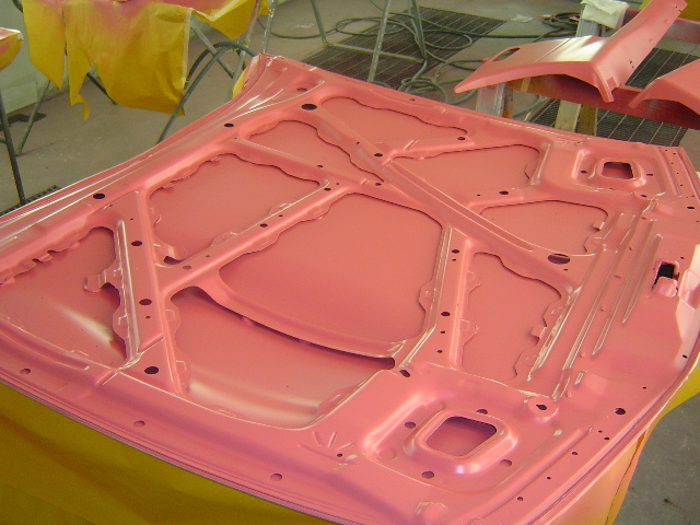

Old 07-28-2005   #21
Re: painting my 92 talon at school (dunwoody)
july-28

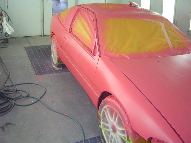

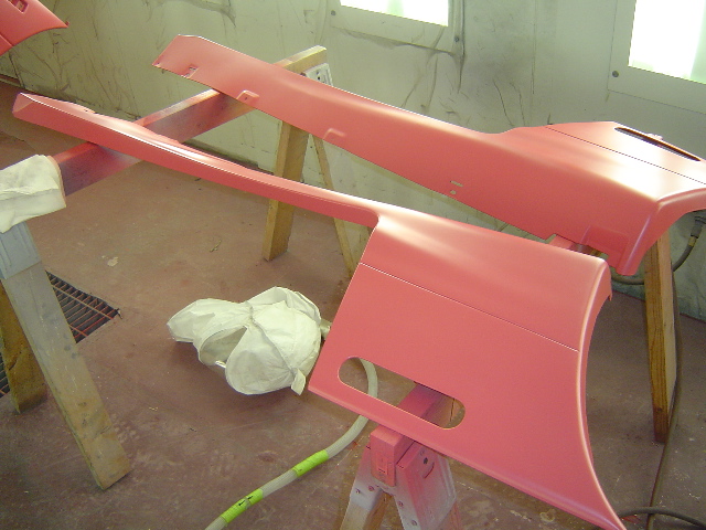

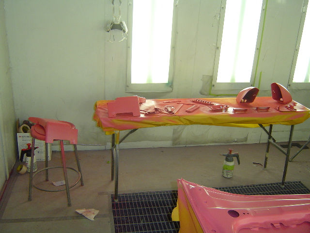

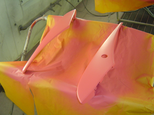

sealed and painted alot today
under side of hood,side skirts,door caps,fender caps,mirrors,door handles,wing,side vents
and yes the sealer is pink

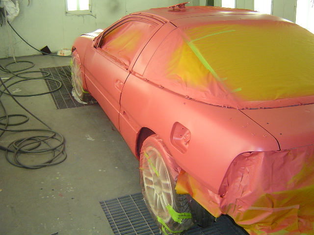

Old 07-28-2005   #22
july-28

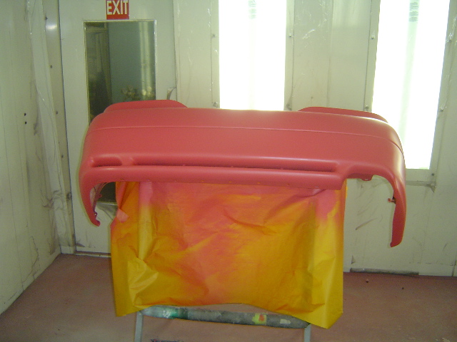

more pink

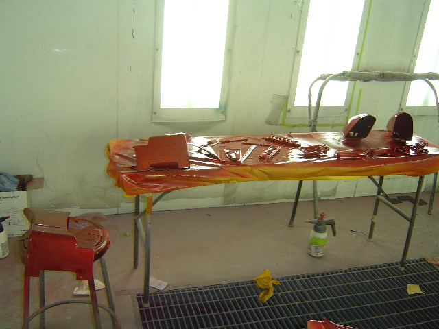

Old 07-28-2005   #23

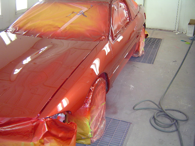

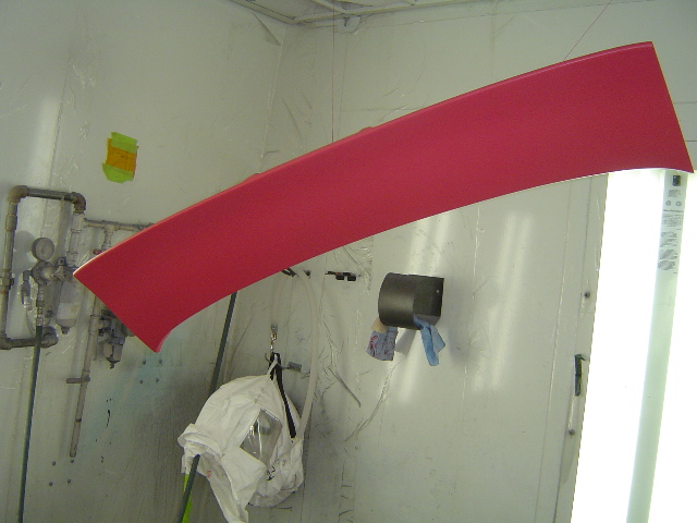

july-28
more pink
base,and clear

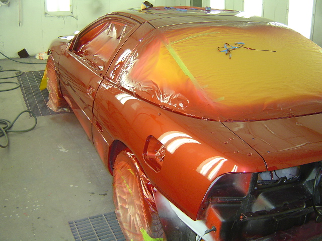

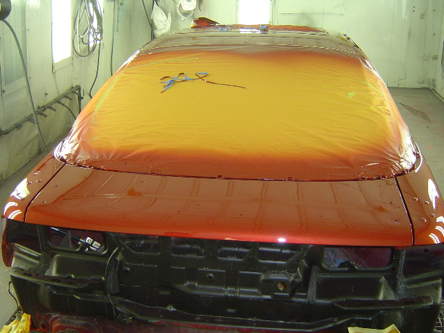

Old 07-28-2005   #24

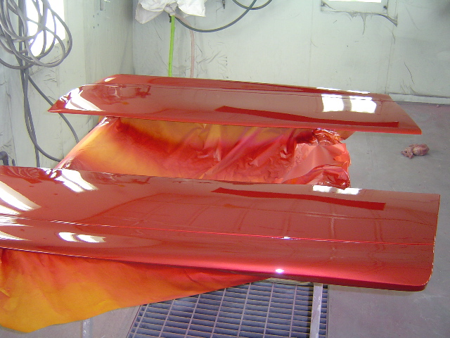

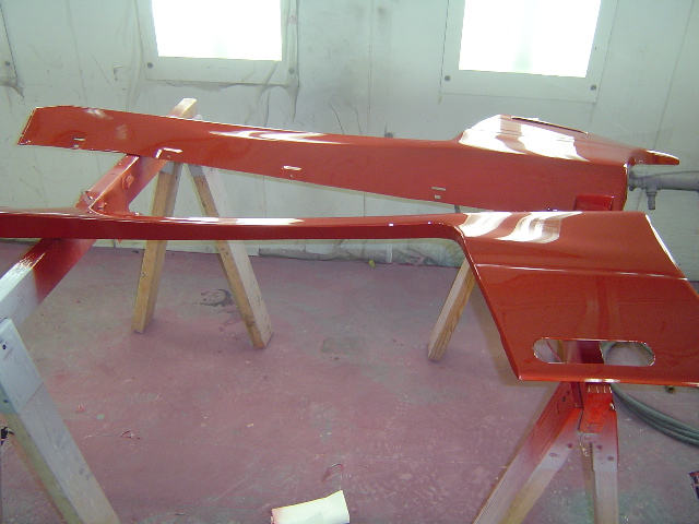

july-28
base and clear

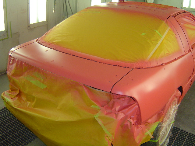

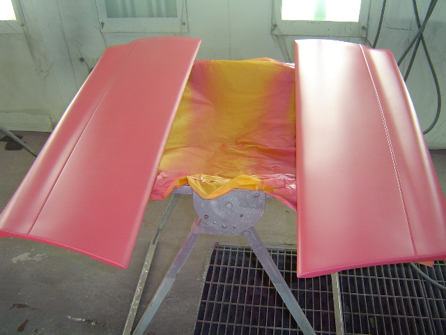

Old 07-29-2005   #27

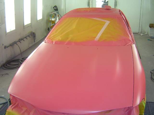

july-29

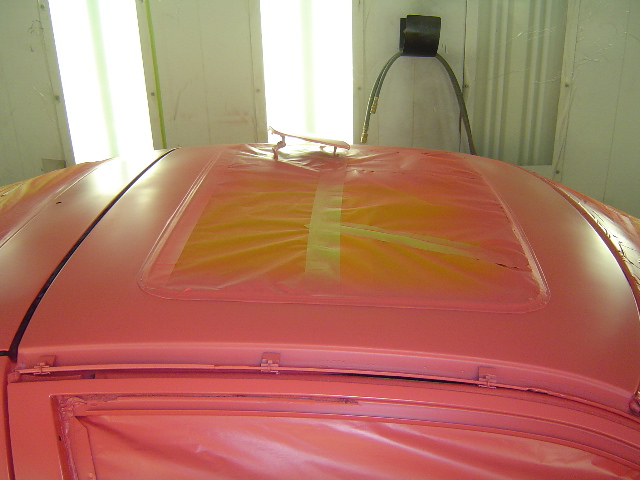

today was it all but the front bumper is done
here is the pike sealer on the car
Old 07-29-2005   #28
july-29
sealer pt2

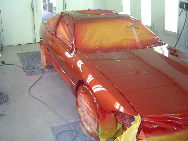

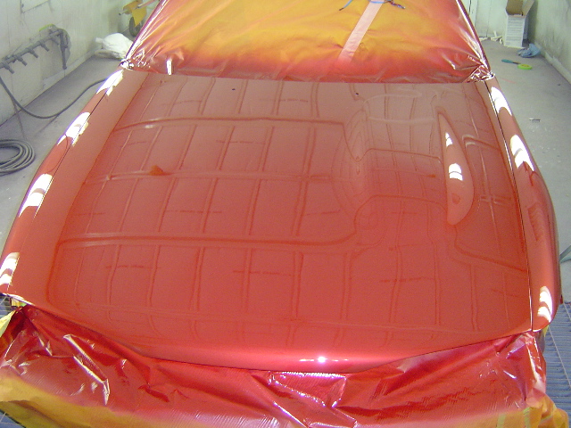

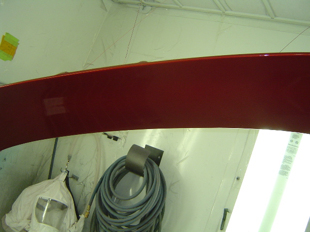

Old 07-29-2005   #29
july-29

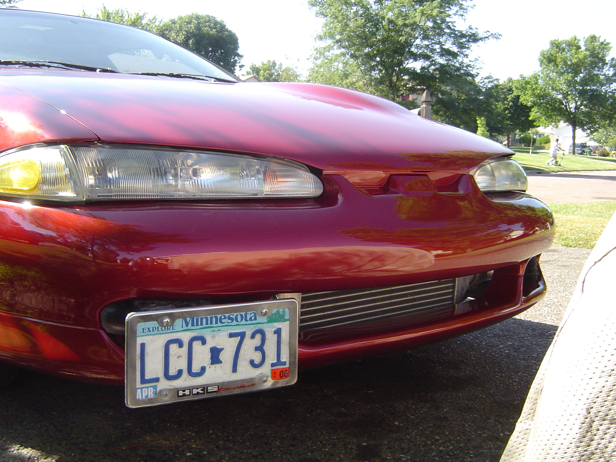

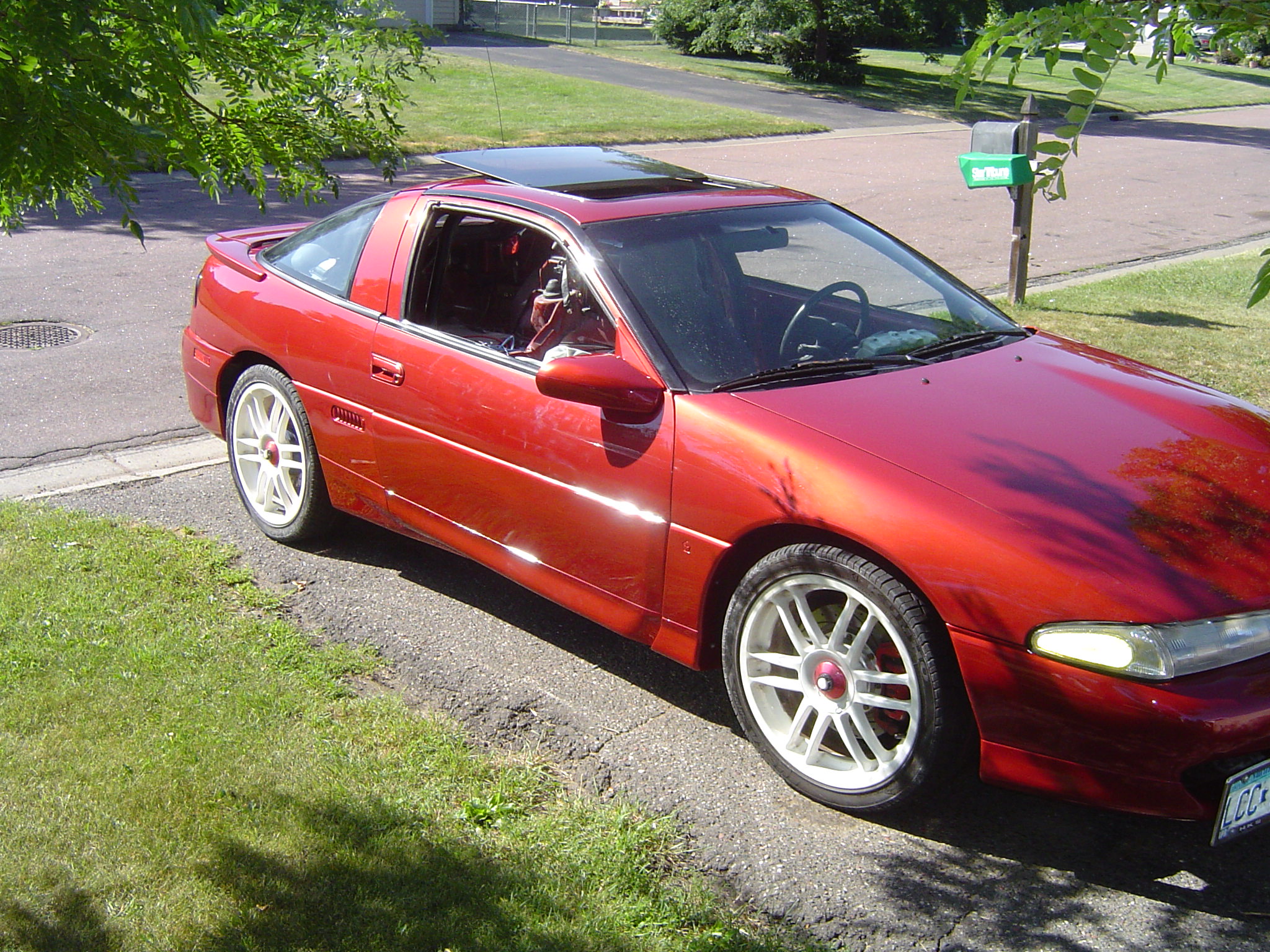

finaly painted

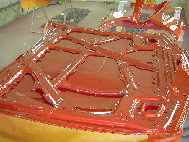

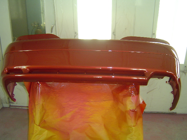

Old 07-29-2005   #30
july-29
painted pt2

Ahh...virgin paint to greasy hands and bird poop. Looks nice!

Old 07-30-2005   #36
Let it sit in the sun for a while and the UV's will bake it. When it gets baked in an "oven" it isn't actually heat that bakes the paint, it is UV lights.
Old 07-30-2005   #37
I am just letting it sit no heat
I could have baked it at 140f to get it to kick but paint will take up to 6months to fully cure
come monday it will be wet sanded then dry sanded and buff the hell out of it
