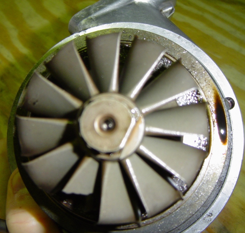

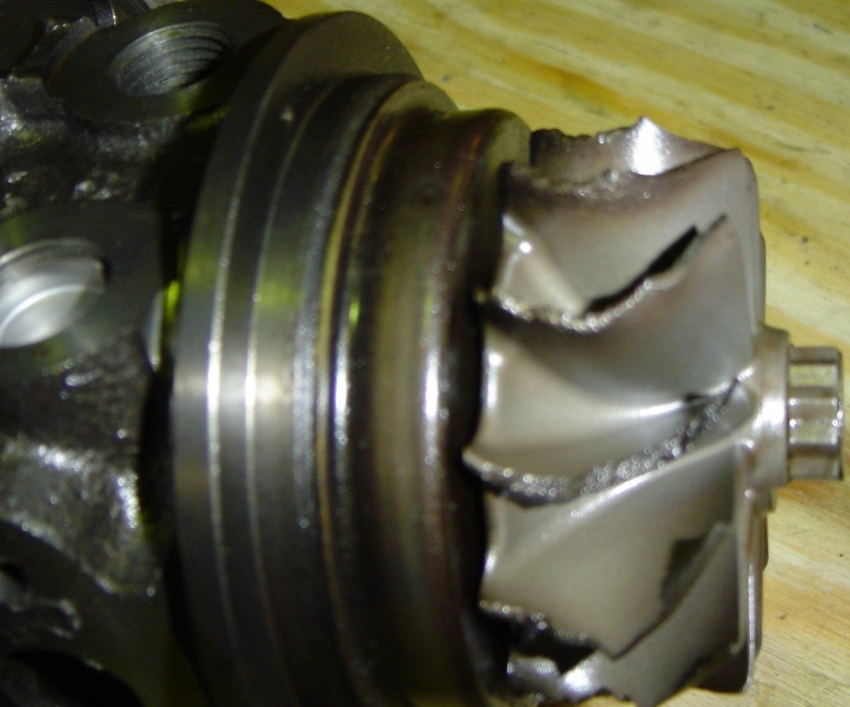

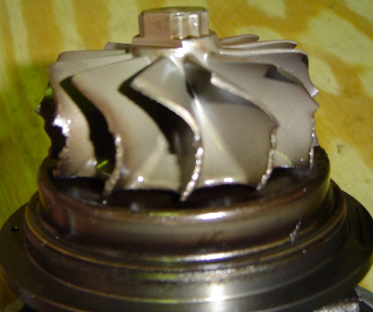

I called him yesterday, and asked him what SBR is going to do for me on this $1000 3 month old turbo?? The following is the reply and pics I just recieved from him today:
Howie,
Something went thru your turbine wheel sir. I can not warranty something that had an object shot through it or left inside the turbine housing during install.
I apologize in advance but you can see from the turbine wheel shots attached that either a piece of a valve, something small was left in the turbine housing during install went through the turbine housing and caused the problems you see in the pictures.
A new shaft, some rebuild parts and assembly would be 400 dollars.
thank you,
Cragger
I guess my first concern is that a valve or whatever else didn't let loose? Is this typical? I've never heard of this kind of failure? What's your take?, Do you all think this is just BS, cause they just don't want to pay up or? Don't seem like even if shit flew threw it it would cause major shaft play would it? What's next? Pull the VC and inspect what? Maybe a leak down first or?
