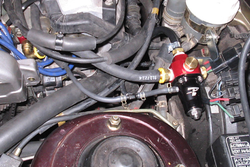

Here's a snapshot of the new FPR! I just need to get a gauge for it now!
