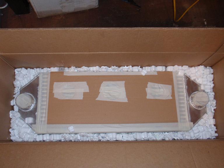

Also something showed up at my front door today Hopefully throw her on this weekend! It's the same height as my current one, but 2" longer, and .5" thinner. External fin spacing seems to be pretty "radiator friendly" which was my whole intent. I think I'm going to be real happy with it

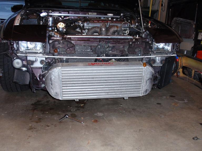

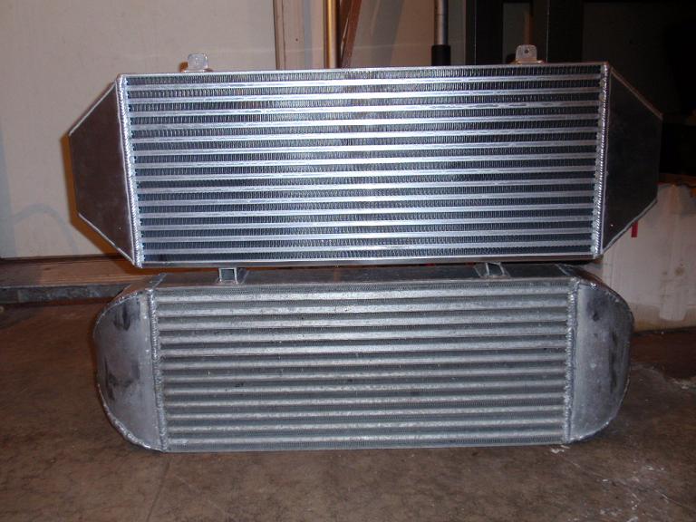

Out with the old, and in with the new. You can see the new is 2" longer, and .5" thinner. Also you can see the external fin spacing difference, and how the ETS is a lot more "breathable".

I like your old IC's end tank design alot better. hopefully the wider openings between the rows will help with your cooling isues.
I completely agree. The end tank design on my old one is why I went with that one instead of a Kinetic (SBR) one. IMO VPE had the best end tank design on a 1G back-door style FMIC out there. Too bad they aren't in business anymore.
But... The goal here was to get more air to the radiator. A small amount of performance may be lost, but that's ok, there is reason behind it.
