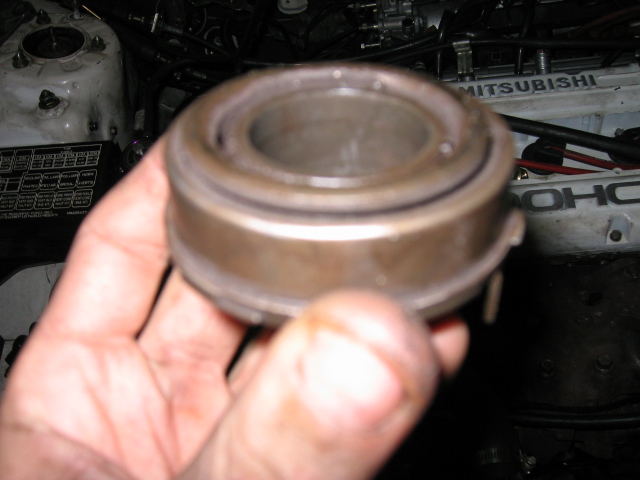

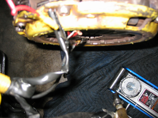

Re: I give up...
Amazing how i can now take a tranny completly out in less then 2 hours
Heres a couple pics, tell me what you guys think. I was talking to the guy that i bought the car from and he said the PP was pretty much brand spankin new, like less then 15000 miles on it.

Old 08-17-2006   #49
Re: I give up...

Re: I give up...
That pressure plate doesnt look new. It looks like some thing was hitting againt it. its hard to tell from the pics but it looks like something was hitting the flywheel too. I agree with M/// guy replace it all and be done with it.

Re: I give up...
That pressure plate is sure beat to hell. The one I just took off my car supposedly only had a few thousand miles on it (maybe 10,000+ as far as I know) and aside from the dust it was shiny. Yours looks like it was tossed around the garage a few hours before hand.
Old 08-18-2006   #53
Nash
Nash's Avatar
Re: I give up...
From the looks of the pictures it looks like the PP fingers are flat. They should be bent out away from the clutch disk.

I'd still check the position of the clutch fork. If it's still more towards the passenger side, then it could mean the TOB is constantly riding on the PP. If so, this can cause premature wear.
I agree with the others above. The PP does look like it has seen better days. By the way, the fingers of the PP flatten out as it's tightened to the flywheel. When it's off is generally the only time you'll see them at the angle.
