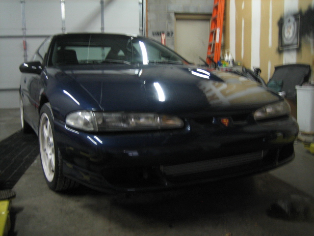

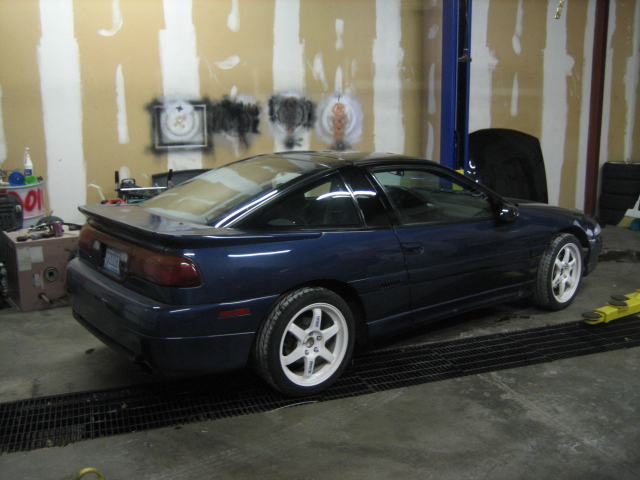

Well, I finally got to take her out for a quick spin this morning. I've got a few things to take care of like a working 02 sensor for fuel tuning and welding a new bung for the wideband, but it actually drove pretty well. It was spooky how quiet it is now with the full interior back in and the dynamat, plus power steering and heat will take some getting used to. Once I get it running right, I can put it in storage and bring it back when I get time to put in a real stereo system and move on to my next big project, 3000 GT VR-4 or EVO brakes.

Re: Comfort comes home-Project Lexus GSX
Awesome steve! Can't wait to see this thing on the street again!
Old 12-08-2007   #50
Sweet!
Old 12-08-2007   #51
Looking good!
