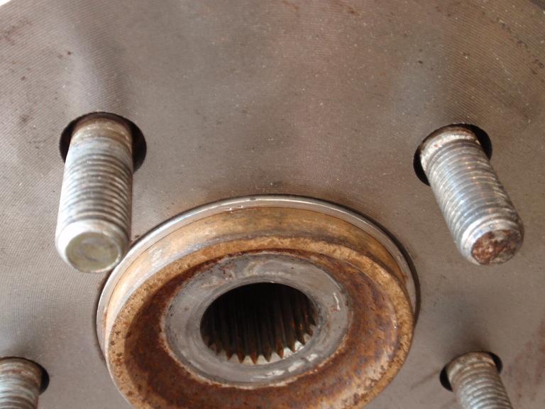

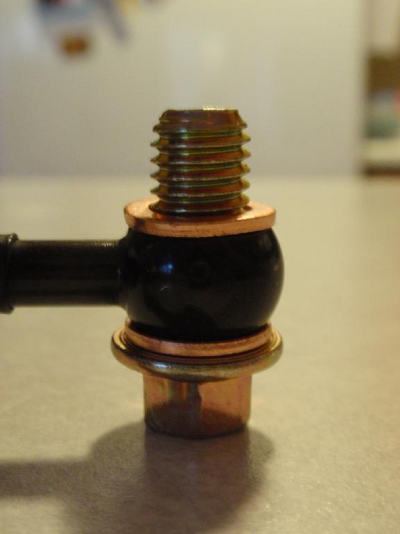

The end is the right diameter for the cobra banjo bolts. But there will need to be some tweaking of the banjo bolt required for it to work. With the bolt screwed down as far as it can go, it's still not tight down on the fitting. So I'll tap the bolt further, and that should hopefully take car of that. Might need to cut a little off the bottom if the bolt ends up being too long. I would have preferred it just fit correctly, but really is a fairly minor issue in the end.
Here's a pic showing what I'm talking about.

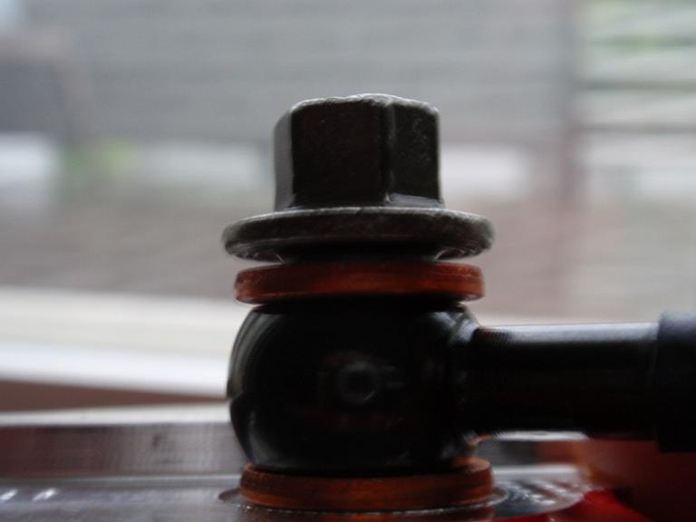

Hmm... Looking around some more, and I think that place I got the banjo bolts from is the cluprit. Here you can see how mine look. The threading stops, and then turns into some kind of worn down looking threading, that won't thread in, which is why it doesn't go down far enough:
And here are others I've found, that thread much higher, and would have worked perfect:
So lesson learned, don't buy the banjo bolts from that company I got mine from. Get them somewhere else.
They are M10 x 1.5mm banjo bolt, around 24mm in length or so. I'm going to go to Ace and Lowe's to see if they have any.

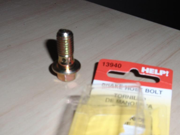

Went to Checker, and they had two M10 x 1.5 x 22.8mm banjo bolts on the shelf. A hair shorter than the standard 24mm, but they look like they are going to fit perfect for me. 4.99/ea (Checker/O'Reilly Part# - 13940). $10.65 after tax for two of them.
http://shop.oreillyauto.com/ProductD...rtNumber=13940
So lesson learned. Don't buy the banjo bolts from that Ford Racing shop. Just get some from your local parts store

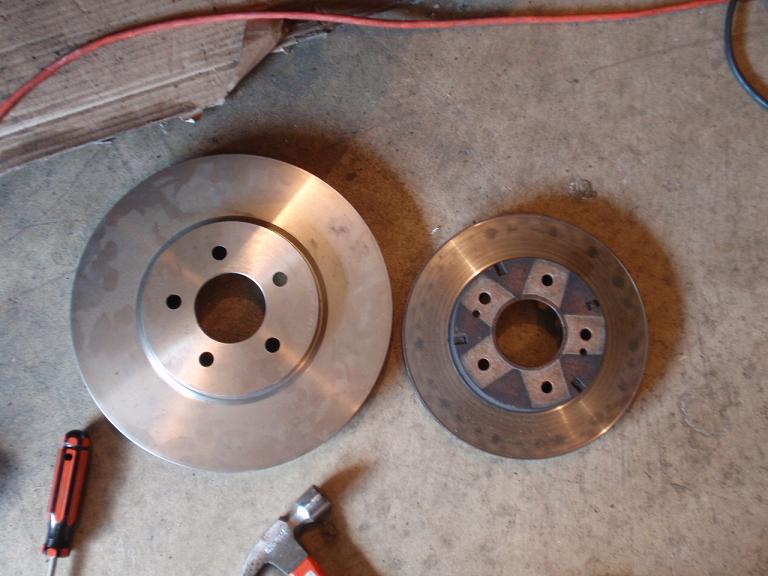

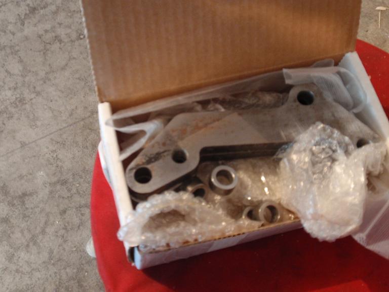

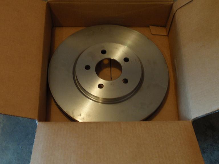

Got the rotors and the mounting kit today.
One thing I do still need is hardware to make it all work. So a few more bucks will still need to be spent. I'll make sure to post up exactly what hardware I use.

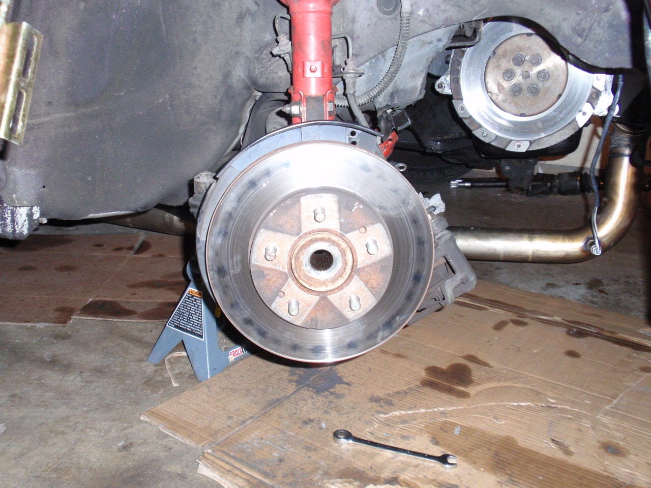

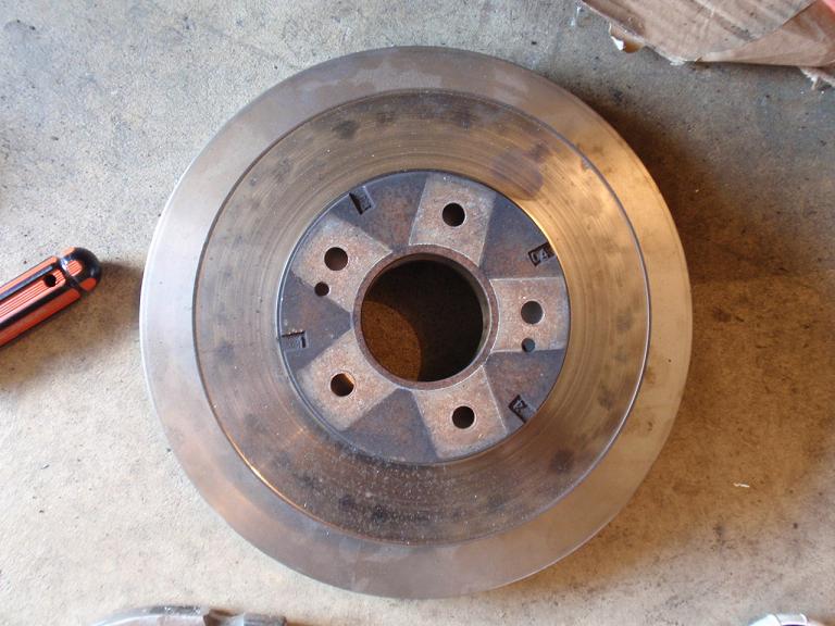

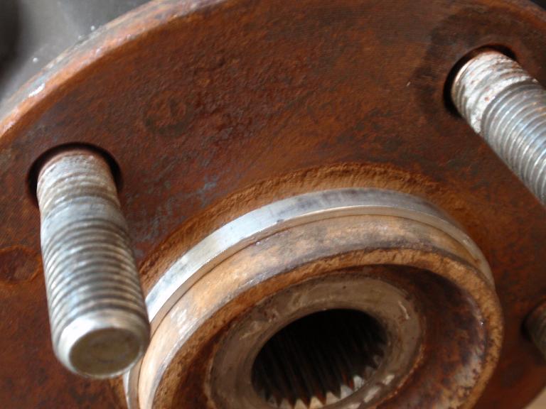

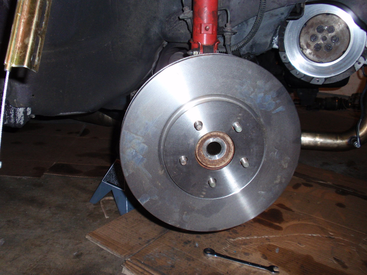

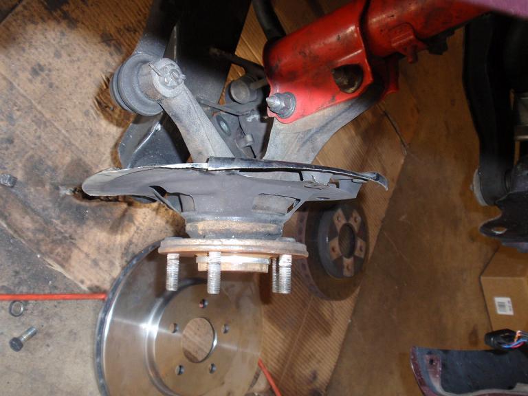

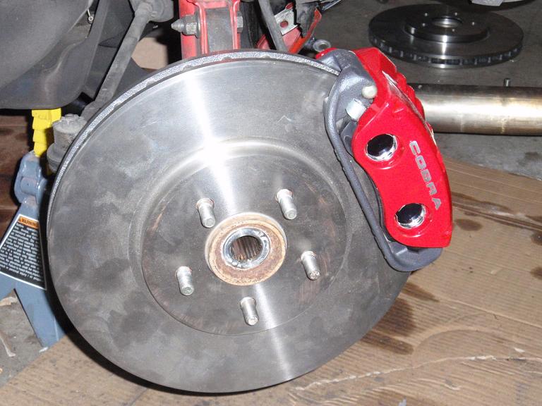

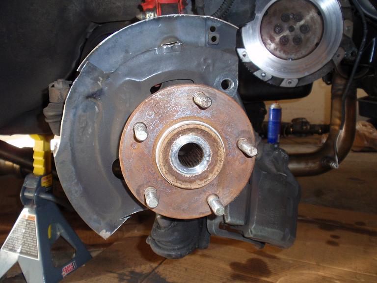

Got to come home for a day. Here's what I've done so far. Had to modify the brake dust shield to accommodate the larger rotor.

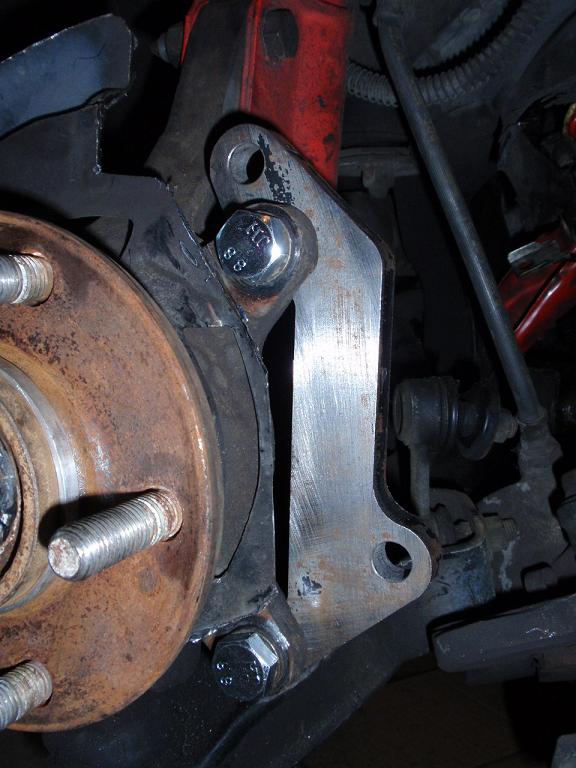

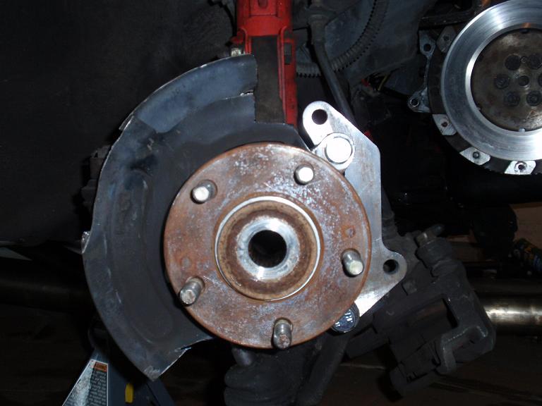

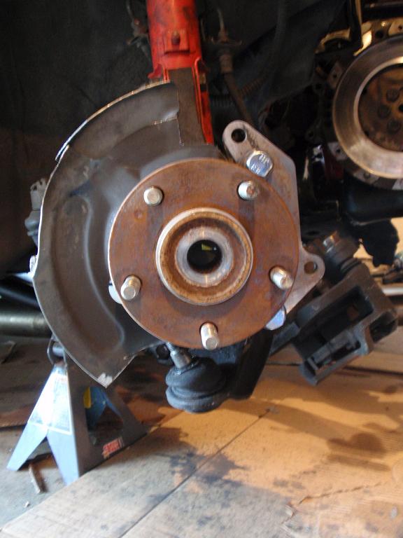

Had to cut away a little more of the dust shield. I used M12 x 1.75 x 25 bolts and lockwashers to mount the brackets to the car. 25 seemed to be a good length where it wasn't sticking out the back. Ideally I'd say a 30mm length would be ideal but Lowe's didn't have 30. 35 seemed a bit too long. I'm going to stick with the 25mm ones as they still are in there a good 4 threads deep.
I bought M12 x 1.75 x 35 and lockwasher for the bracket to caliper bolts. They work but only thread in a couple threads. 45mm would probably be ideal. I left the 35's in, but will be getting some 45's next chance I get to work on the car.
Here's the pics.

Re: Cobra Brakes on a 1G
Looks like a nice setup, but I would definitely be getting longer bolts for those calipers and brackets. Also, it seems like there's alot of wasted space on that rotor. Is there any kind of upgraded caliper for this setup that takes advantage of the space between the hub area and the inner edge of the pad?
That is very strange and will definitely cause some strange looking wear marks (and rust) as they get worn in along with some lips in the rotor surface. I don't recall my Baers being like that and I can't imagine they came from Ford like that on the Cobras.

just looked at my cobra brakes and they have the same extra space.
i dont think its such a big deal as the majority of your braking power is going to come from further out on the rotor.
but that is how they come on the actual cobras
I beg to differ.
Here's the DSM 13" Baer kit:
Here's the Cobra brakes on an actual Mustang:
Some other DSM brake upgrades for reference, and you can see they're all similar...:
Willwood:
VR4 caliper / Cobra rotor upgrade:
Quit hatin on my budget setup!!! :P
