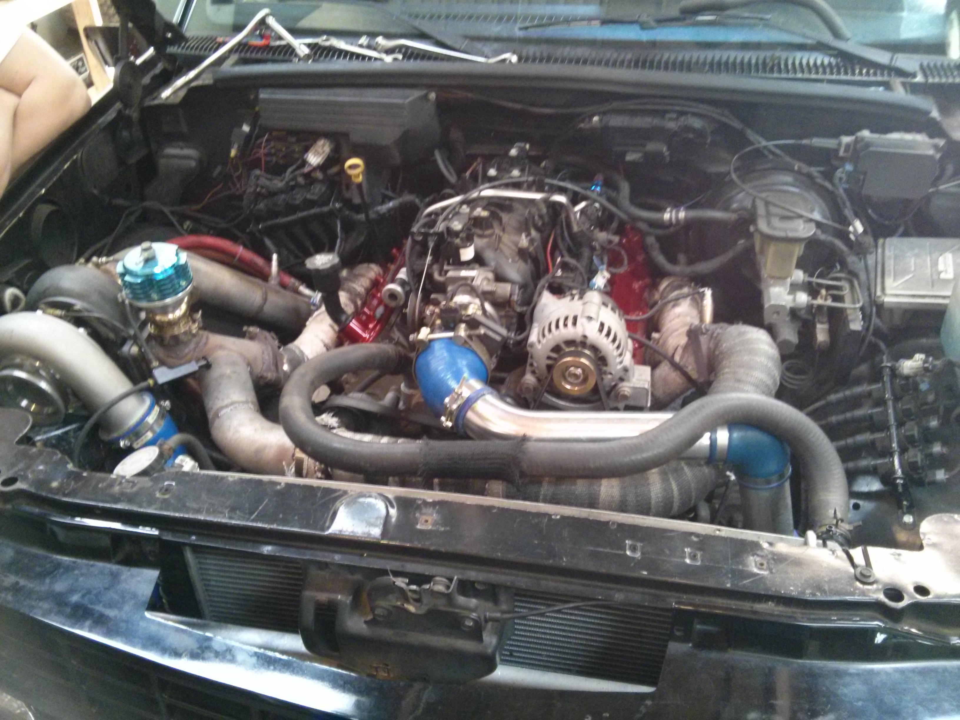

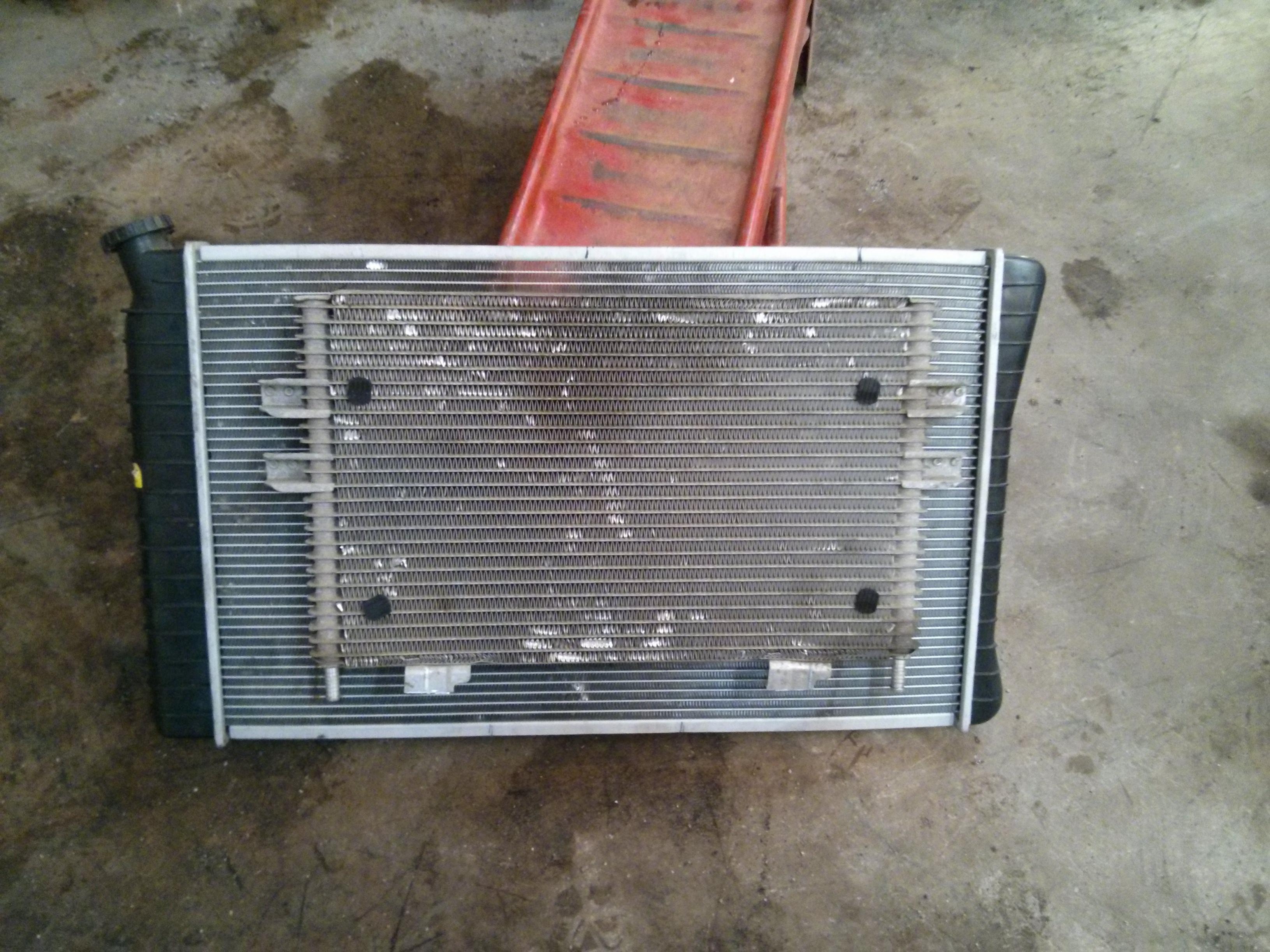

Re: project darkness
New transmission cooler and I painted the valve covers candy apple red.
