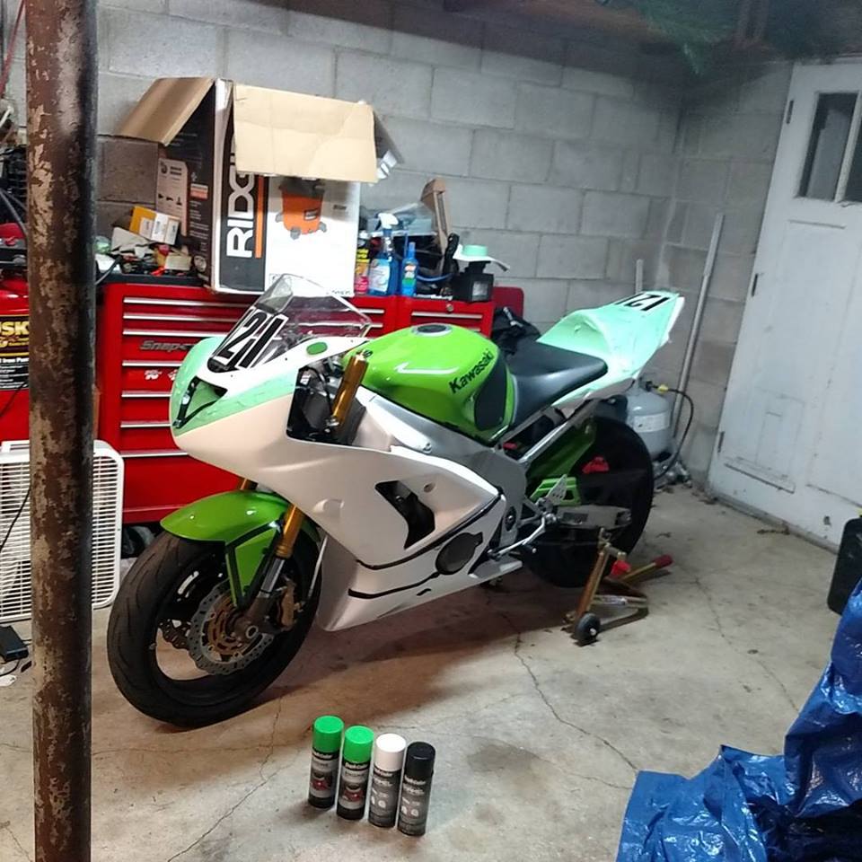

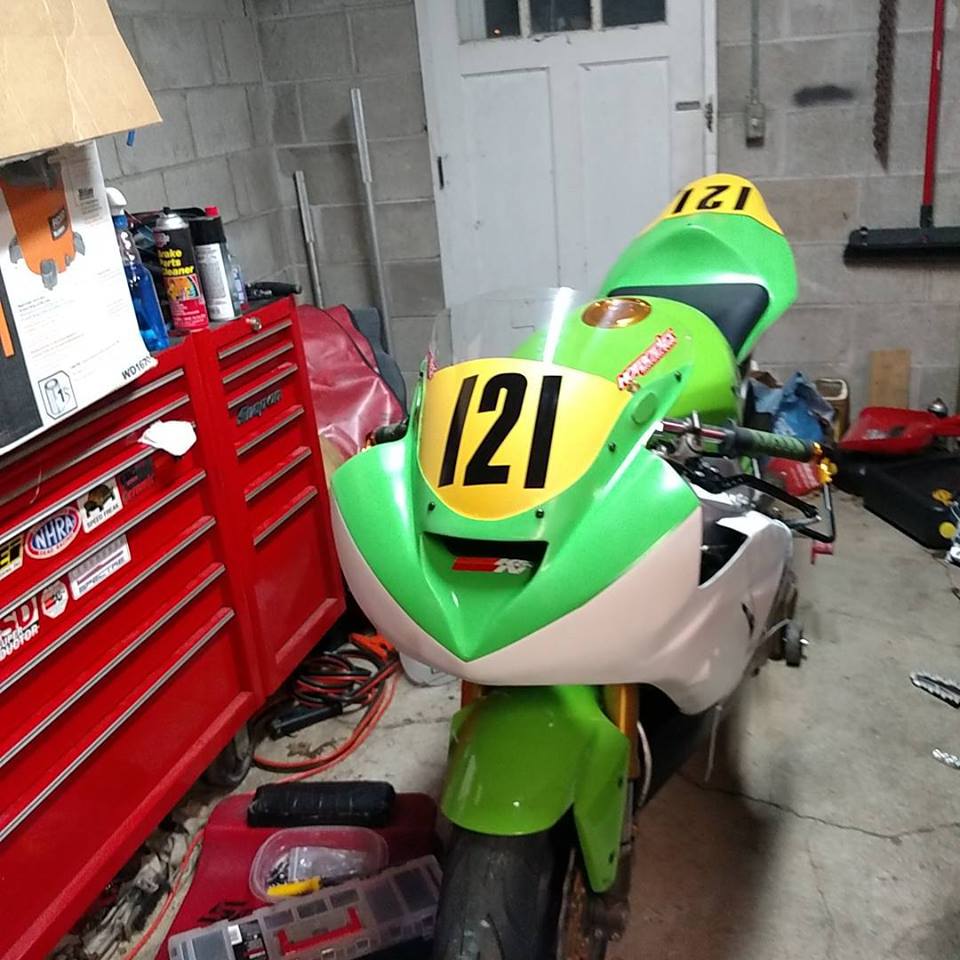

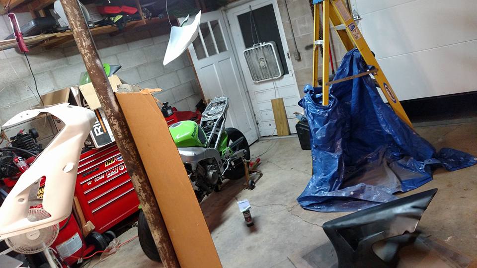

I've been working away. Last night I was fitting some race plastics and playing around with paint ideas. Finished the night with a completely black lower fairing (e-tape), white upper fairing, and the under side of the tail in white.

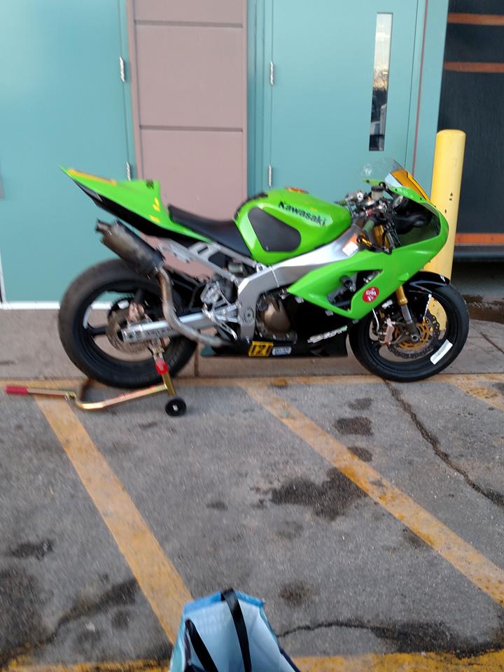

Bike is getting closer. Having tires put on tonight then all that is left is:
Swap out front pads for more aggressive track pads (EBC) - In the mail.
Adapt GSX-R steering damper and swap out oil in damper - In the mail.
New Dzus fasteners as the garbage I ordered the first time was crap - In the mail.
Install new frame protectors - In the mail.
Install new chain (gears are in) - Tonight.
Essentially unless the mail comes, I am doing tires and a chain tonight

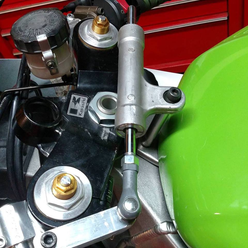

Adapt GSX-R steering damper and swap out oil in damper - Done, see attached picture.

Behold, a 2006 Suzuki 600 GSXR steering damper adapted to a 2003 Kawi Ninja ZX6RR. I'll swap it out to 5W oil tomorrow. It "should" hold as I really beat the piss out of it on the stands and it held just fine.

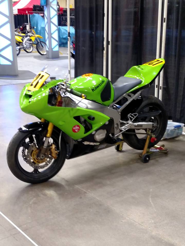

I just dropped it off at IMS last night to be in the ZeroGravity booth as part of a display representing local race bikes. Those are the attached pictures, feel free to check it out at IMS this weekend.
