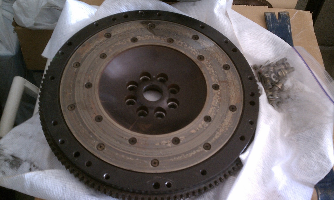

Picked up a used lightweight JWT 350z flywheel for cheap. I like the fact that the replacement surfaces for these are only $65.

So, excuse my newbness but I have a few questions...how does it happen that this particular 350Z trans bolts up to this motor? I get that you have an adapter plate but what about the input shaft spline count and length? What about the mounts that bolt it up to the chassis? And how does this new flywheel you got simply bolt up, all the holes align correctly? And the driveshaft just fits or do you have to modify the one you have?

I will run a stock SC300 auto flexplate. An adapter will make it so that I can bolt a 350z flywheel and clutch setup to it. The 350z clutch will have the correct splines for the 350z trans input shaft. The trans mount will have to be custom, but it's 1 mount, nothing too fancy there. A custom driveshaft will need to be made to fit into the 350z trans. A Titan driveshaft fits into this trans, so I'm thinking of just seeing if I can find a used Titan driveshaft for cheap, bring it along with my current one to a driveshaft shop, and let them make it work.
