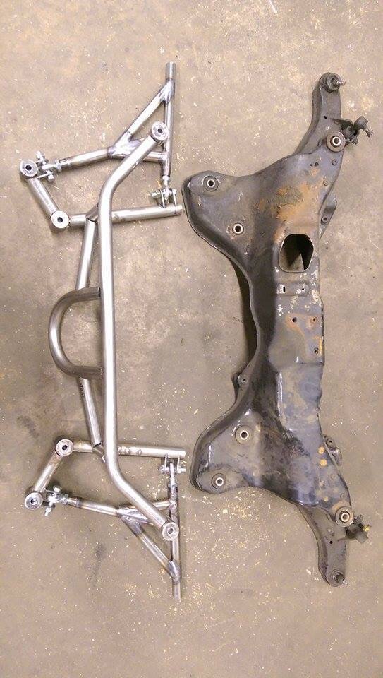

I'd like to see what you do with yours.
Here is a picture of their k-member.

Check this out, it's a good design. It has good triangulation with the best weight savings. I'm building this one:
http://www.dsmtuners.com/threads/93-....456345/page-7

Yeah that one looks good. I'll have to save that one for making my own. Looks like the hardest part is the ball joint receivers. I'm assuming heim joints will be used to connect lca's to k-member.

For those chassis tabs is it needed they go around the tube? Could they just have a radius and be welded on.

The reason they are round is that I can mock the suspension up without needing to weld any thing up.

Now that the block is at maperformance for machining I'm starting my kmember fab. First stop is measuring everything and get a starting weight.
72 lbs, it has all the bolts, brackets, and driveshaft loop. I know others have weighed just arms and kmember at 64. This is going to save a ton of weight!
