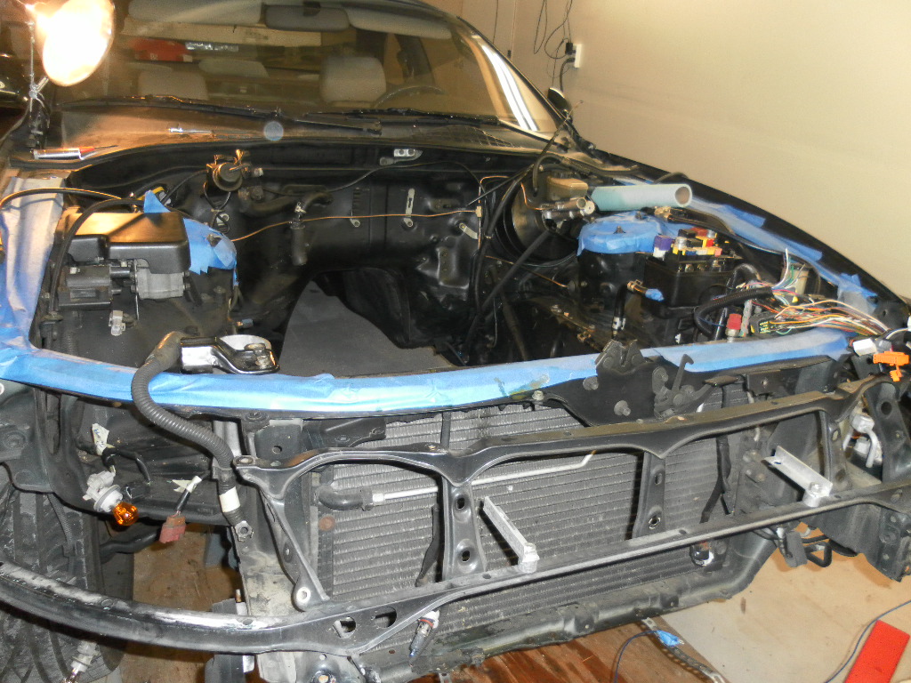

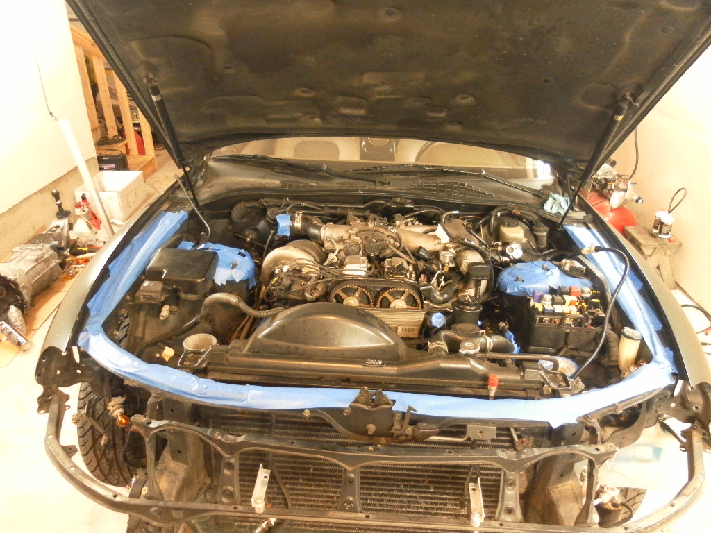

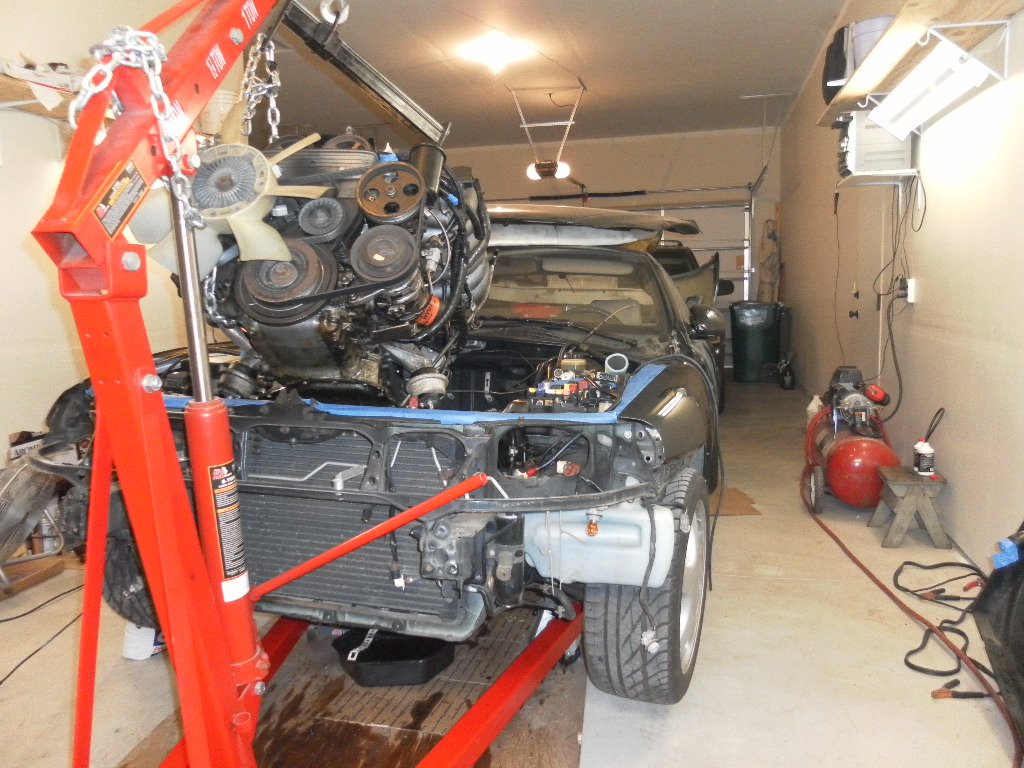

Well got about a 2hr start on it today. Got the oil, coolant, and PS fluid drained. Got the work area taped off since I know it's going to become a tool rack and I'd like to keep the paint as nice as possible. Got the front bumper removed, FMIC and piping removed, bunch of stuff unplugged and labeled. Slowly but surely is the way I work now-a-days Leaving it like this for the night, will hopefully get another couple hour crack at it tomorrow!

Is this the ignition/forward facing intake and ghetto-pipe delete portion? Will this allow you to do something with the MAF then as well?
Old 12-29-2012   #751
Re: Project Lex
Basically I'm still trying to do one at a time as much as possible. So this will just be replacing gaskets to eliminate leaks, some other clean up stuff, and new trans. When I out it back in I want the ignition, intake, all that to still be the same so it hopefully starts and idles nice still. Will probably also do some freshen up in the head, along with the new springs and cams too. I just really feel like the the FFIM and ignition is going to take a bit of dialing in to get things running right, so I don't want to do that at the same time I'm doing everything else. Want to make sure I start with the car working well, then do those so I know if something isn't running right, its that and not something else.

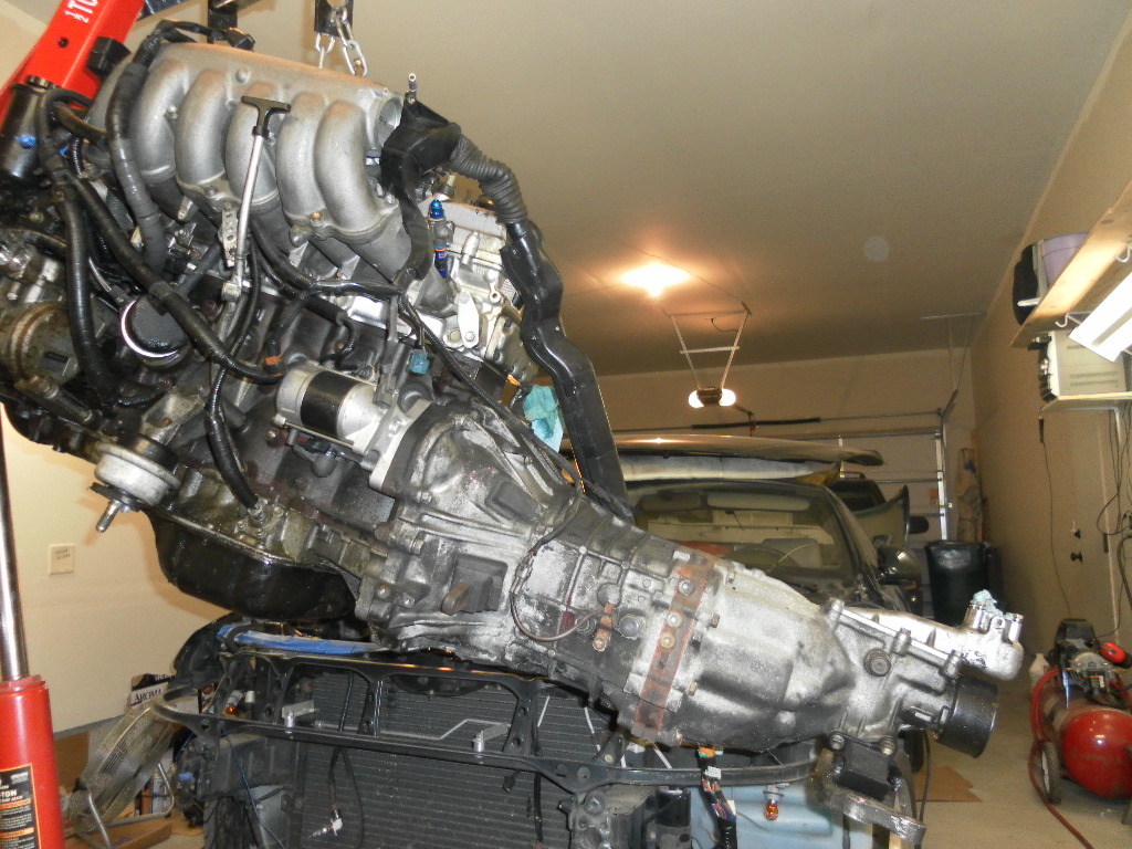

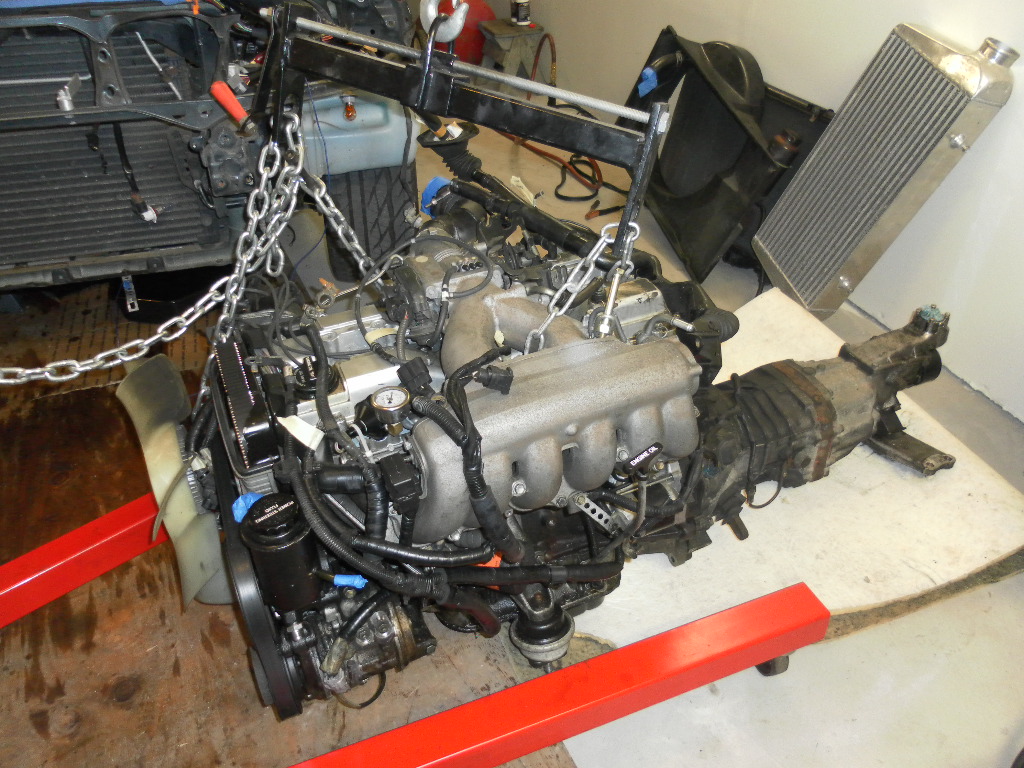

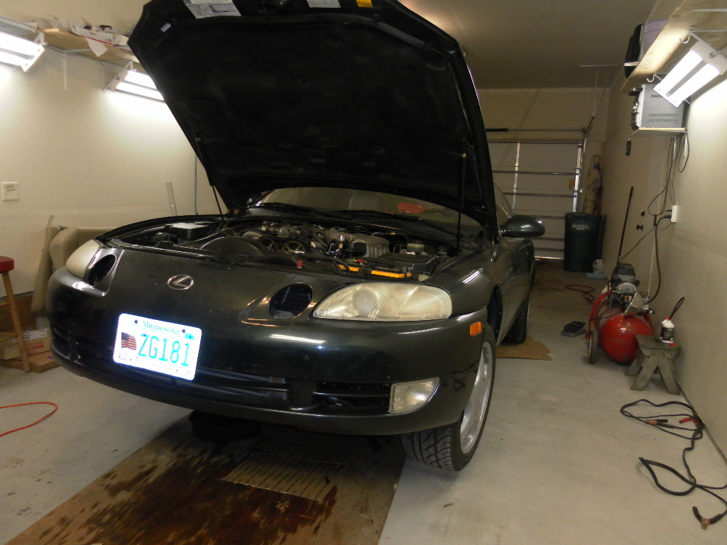

Made a little progress today.

Nice! Engine out of the car makes it so easy to work on, love this part. Fram oil filter, really?! LOL.
I see a 4x8 sheet of plywood under there, did that work ok with the hoist or did the wheels get caught on it?
