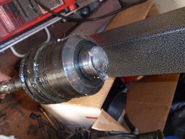

Got the tranny partially apart. So far nothing has stood out as being an obvious issue, which is good I suppose.
Someone mentioned the Viscous coupling maybe being bad. How can I check that?
Also, after seeing all of this, does anything stand out thus far as being the reason that the car felt like the clutch was slipping really bad? What would have caused that, because the clutch looks to be just fine.
Here's a few pics. I was taking tons of pictures, because when it comes time to put this thing back together, I want some pictures to look at to make sure it's right

Yea, with a non-lsd tranny and a broke axle, the other axle/wheel isn't going to get shit for power sent to it.

I didn't take the time to read but wouldn't you're snapped axle be the cause of all you're slipping?

Dumb question, but again I'm not a drivetrain guru what-so-ever. How does the broken axle, make the car feel like a slipping clutch. Not just shit for power, but slipping clutch? I would hit it in 1st and the RPM's would just race up, then I'd let off and they'd go back down to the RPM you'd expect them to be at?

Watch the video's of MAP trying to go 9's (or 10's can't remember) in their blue 1g. They snapped the rear axle twice and the car would just rev up like a slipping clutch would.

So since the one wheel had a snapped axle, it was like the "slipping wheel in snow". So the torque is very little. So the other front wheel also got little to no torque correct? Makes sense.
But what I still don't understand, is the "slipping". What was slipping? It wasn't just that there was no torque, the thing free-revved like a slipping clutch. That is what I don't understand, and wish I understood.

Since the front diff is open, couldn't a lot of the power be sent to the broken axle thereby allowing it to free-rev?

Nope, AWD= three diff's. One to split front/rear and a front and a rear to split side to side. Same principals apply. 50% of next to nothing = slightly more. Since DSM's have a viscous center LSD, the VCU provides some resistance and allows the car to drive "normally" untill you try and put "a lot" of power to it.

ok im kinda drunk so this post is iffy at best as ive only read the past 3-4 posts, but i broke an axle recently, the car would rev up pretty easy while in gear, as if it was a bad clutch or something, once i got some good axles in there its back to normal, i broke a read driver side axle and it really seemed wierd after it broke,
i know this because i drove it for a little bit after the axle broke, the axle broke, but didnt actualy leave the rear diff for aboujt 20 minutes, do it drove just fine, (no shakes or anything) for a little while till the axle fully seperated from the carrier.
dont know if that clarrifies anything for you, but that was kind of my experiance

I had the output shaft splines going into the xfer case strip slightly and it did the same thing, felt like a slipping clutch. Glad that's all it is for you, btw, that ring compressor is still sitting in my backseat. :-)
