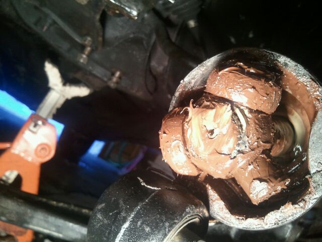

well one of the bearings fell off from inside the cup right before the carrier. Lost all of its needle bearings and i'm guessing causing the vibration.

That will cause a vibration for sure.
