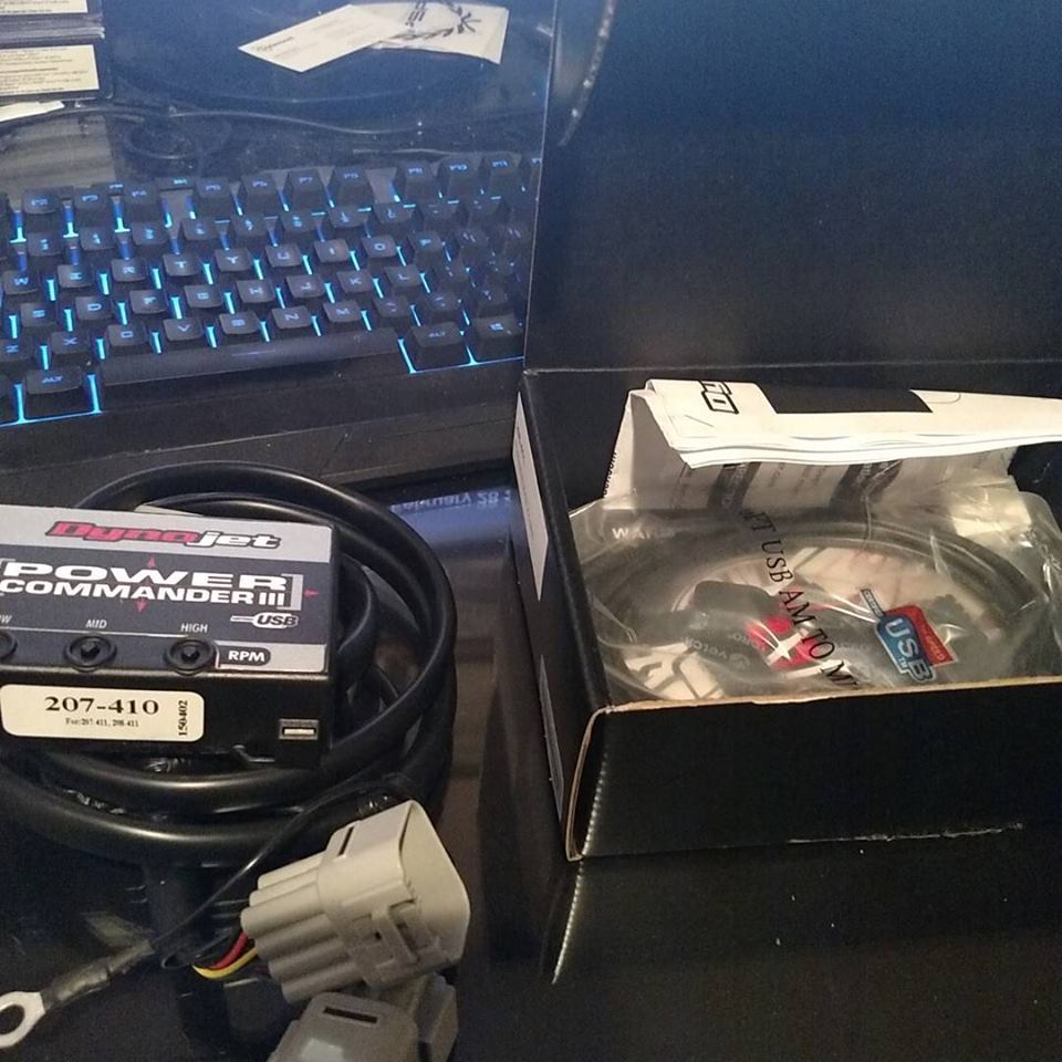

Final piece of the power puzzle until next season. If I am still campaigning this chassis it will get motor work, but for now we've added:
Kawasaki Racing OEM factory race velocity stacks (shorter)
Ignition Advance rotor by Factory Pro +2
Power Commander PCIII
Shorted Hinkle Titanium muffler that has been repacked and cleaned up exhaust piping.
Get this installed and then get it over to the dyno tuner to have it dialed in. Hoping for a smoother power curve and not a huge loss of power from 8-11k, if it picks up 5-6hp on top of that, bonus! 100.5hp, 42.1 tq was last season's numbers.
Go like my Facebook page as I'll be posting more actively on that as it is easier for live posting. I'll also be sharing deals that come up from sponsors and funny/inspirational motorcycle quotes if you are into that sort of thing.

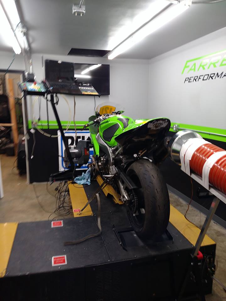

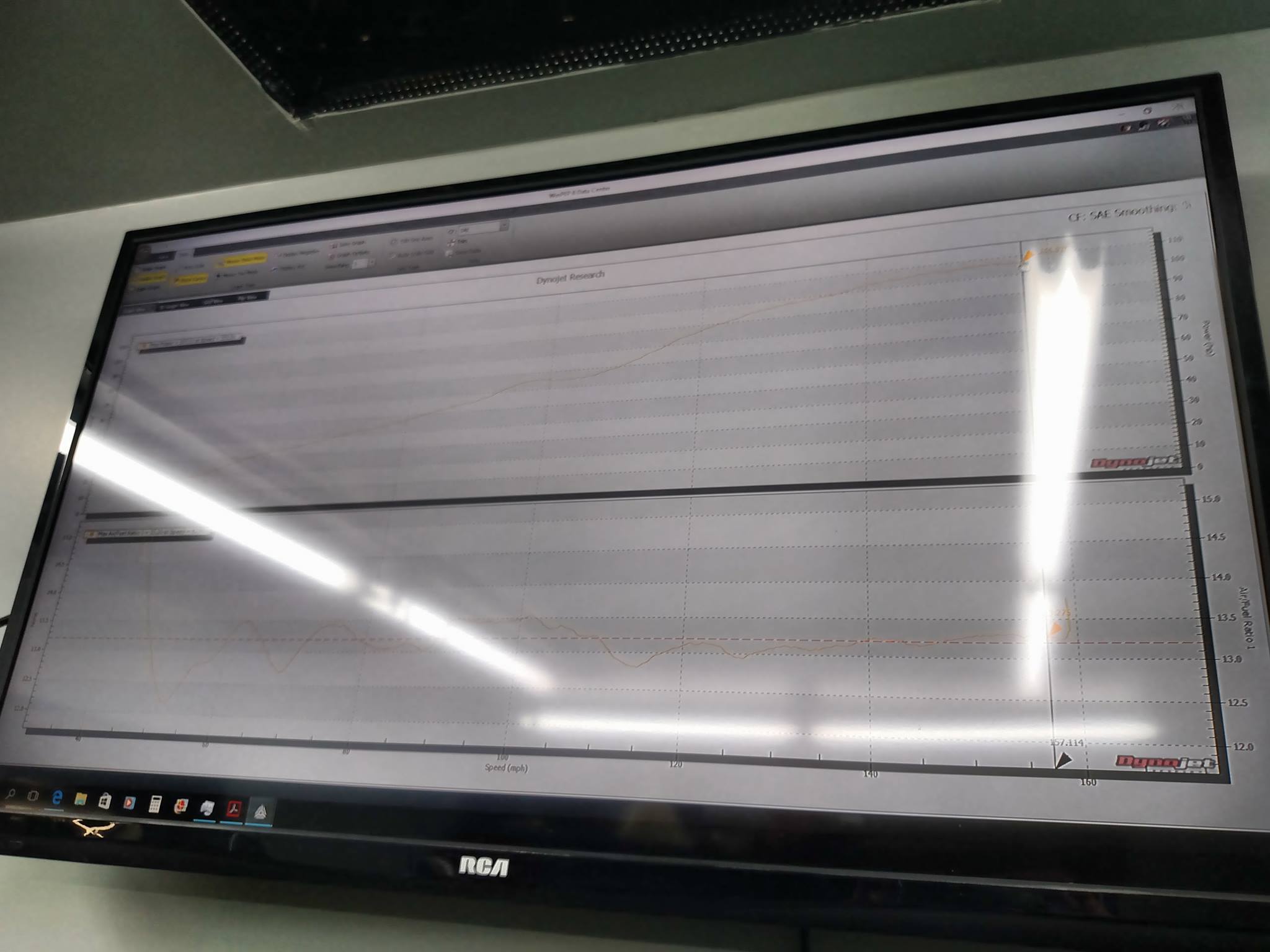

Well last Wednesday I got the bike over to Jason Farrell's of Farrell Performance in Oskosh, WI.
http://www.farrellperformance.com/
Dude does excellent work. As many of you know I am actually a tuner, but specialize more in cars and more focused on that, forced induction. It's not that I couldn't tune a bike, but why in the hell would I try to rent a bike dyno when I can have a pro Kawi guy do it?

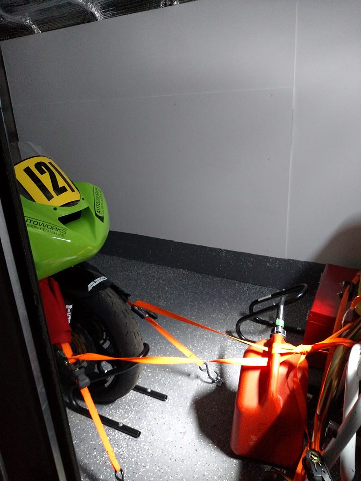

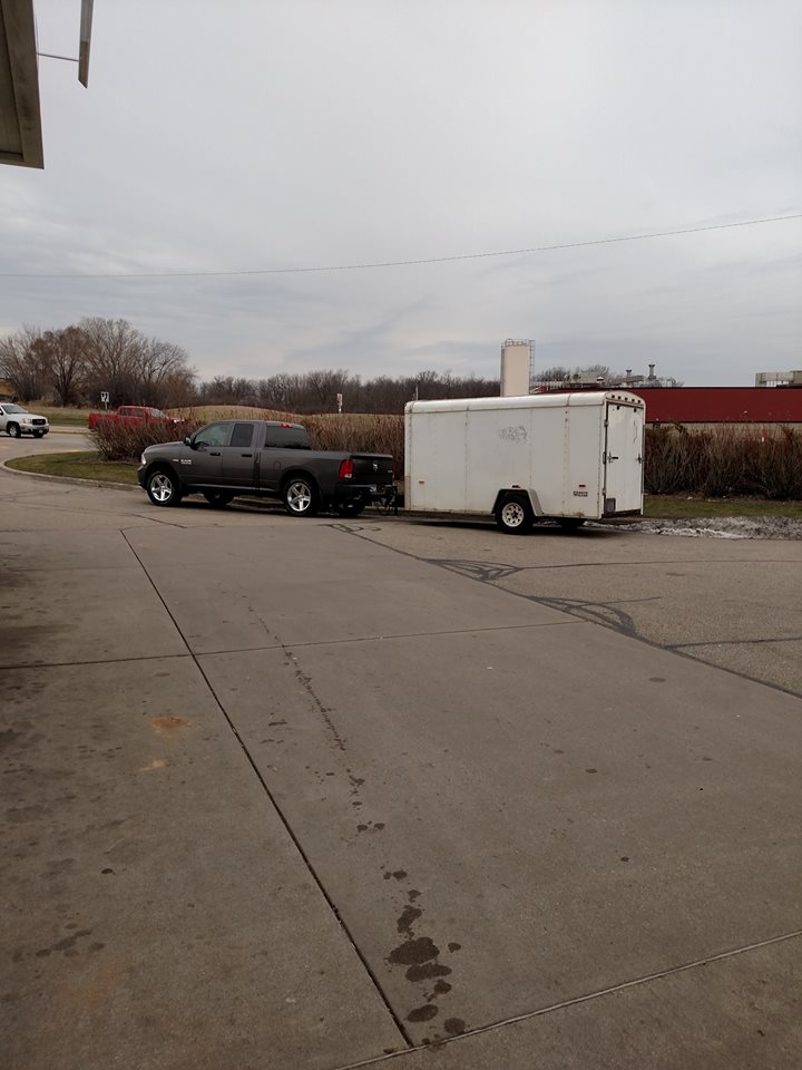

So we loaded it up and proceeded to drive the 300 miles or 4.5 hours one way to the dyno.
Last year on the track I had a bit of a hesitation/bike didn't have the power coming down to turn 2 (WOT turn if you do it right) above 13k rpm. Figuring it was me backing off the gas or the bike was just hot I didn't think about it.

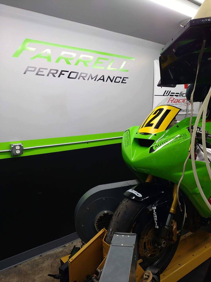

First pull was 89hp, utoh (Last year it made 100.5hp with a full exhaust, K&N, SMOG blockoff, and no tune).
So upon further evalulation we determine it is an ignition issue. Decide to pull it apart and swap coils. First pull...103hp. BAMN short velocity stacks are helping.
After some tweaks it ends up at 107.33hp, which is about a 7% increase from last year. It makes more/same power from 8k up so the drive and the addition of the power commander/fixing the exhaust/adding the Kawi velocity stacks was well worth it!

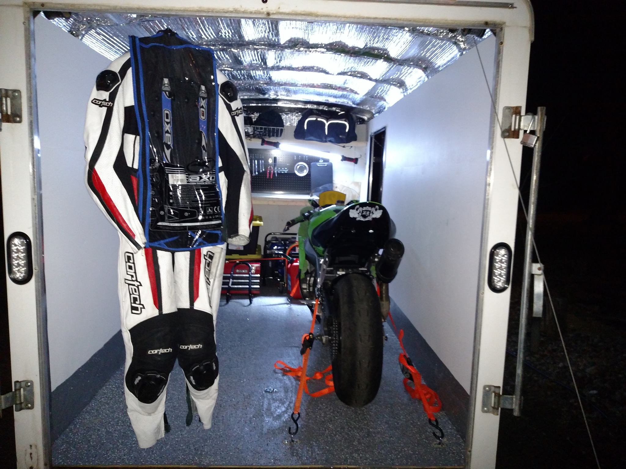

Name:	loaded to farrell.jpg
ID:	15835   Click image for larger version

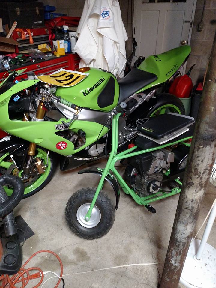

Got the new tires on this week and wrapping up a few small things. Also the doodlebug (pit bike) is ready to rock as well!

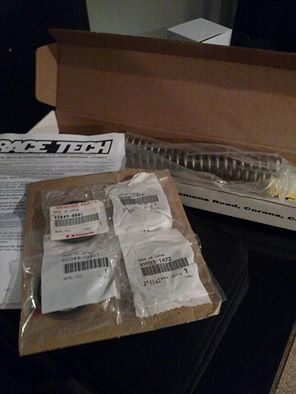

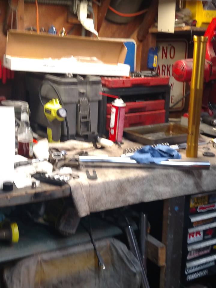

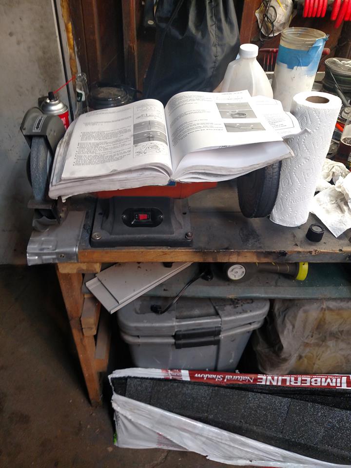

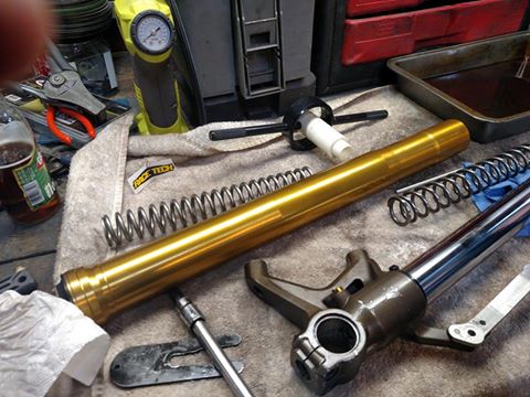

Another update:
This past week I tore apart the suspension and found the cause of the issue:
The rebound dampening was not set correctly in the forks after trackside assembly. This means I pretty much had none activated due to operator error and not understanding how the adjustments are made. FYI BIR is very scary without suspension. I've fixed that by tearing it all apart, validating everything functions, and reassembling back to spec (with proper weight springs in the front).
