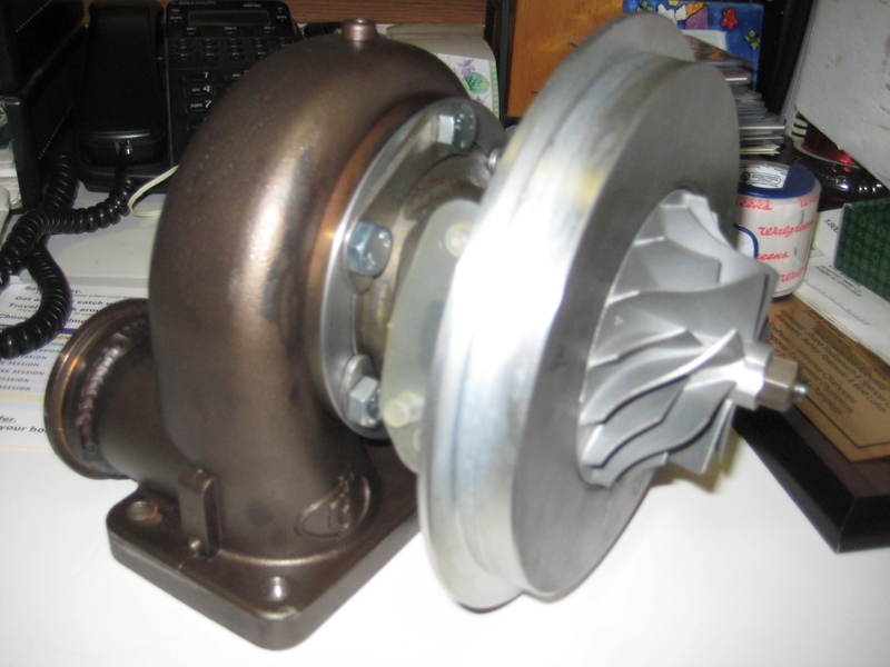

The only shop that I know with a readily available housign. There are dozens of guys with other platforms that have had various garrett housings cut for the hx40 and hx35 turbine wheels. There's even a DSMer that has cut a used FP30 turbine housing and fit an hx40 onto it .
There's is no mph or dyno side byside comparison. The larger .70 a/r housign does spool about 400rpms later.

Here's the pic I was looking for. FP housing on a wh1e (hx40). You can see an adapter ring had to be used. That fp housing was bought used. If you buy new, buy the non-GTbb FP30 turbine housing since it has a deeper mounting area. . .
