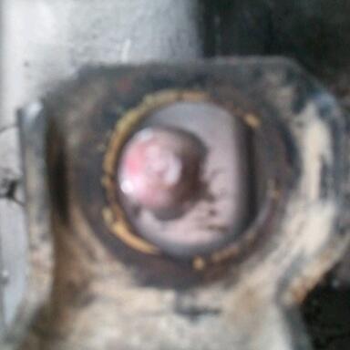

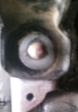

Rear hanger. Pass. side is off a little bit.

Well fixed the hanger, problem still happens. No idea what to try next besides new driveshaft.
