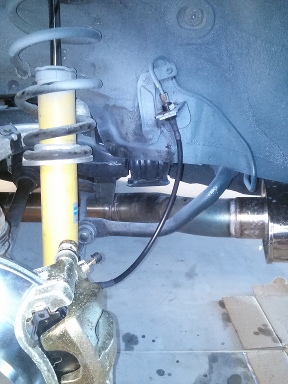

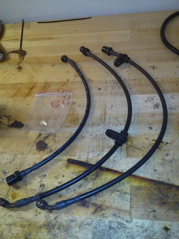

Got some black coated SS Brake Lines. Also hoping to hit the dyno here in a couple weeks for some WOT stuff

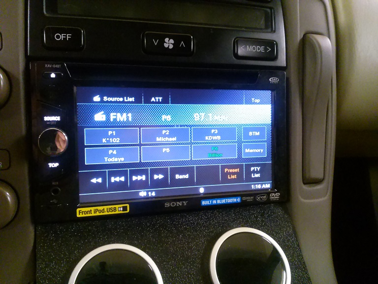

First, I feel like the sound quality coming from the China head unit left a bit to be desired. The aux input plug was becoming intermittent, and the bluetooth streaming was just horrendous, it's like it only streamed treble. So, I picked up a new Sony unit off Amazon for $150. It doesn't have GPS but I never really used that anyway, just use my phone. It does do DVD though, has aux in, USB in, and bluetooth which included a mic. So that is installed, and man everything sounds so much better. So if anyone wants a china unit, I have one up for bid lol.
