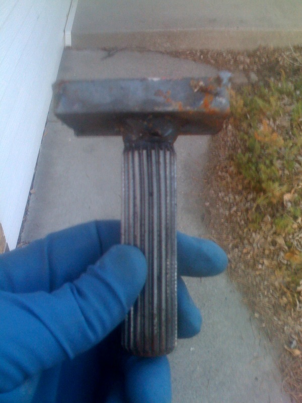

Welded center diff in my 1st GVR4 500AWHPish + a good hook did this:
I snapped my transfercase output shaft in the yoke.
We had to weld that chunk of scrap to it and hammer it out.
look at how it twisted the splines...I cant be the only one right?
I felt kinda proud and defeated at the same time because it was the rare JDMyo switchable one. I have fields of regular transfer cases.
Great build! keep it up!

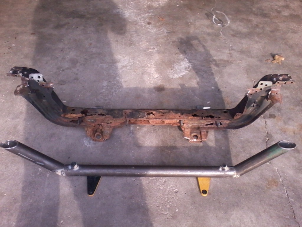

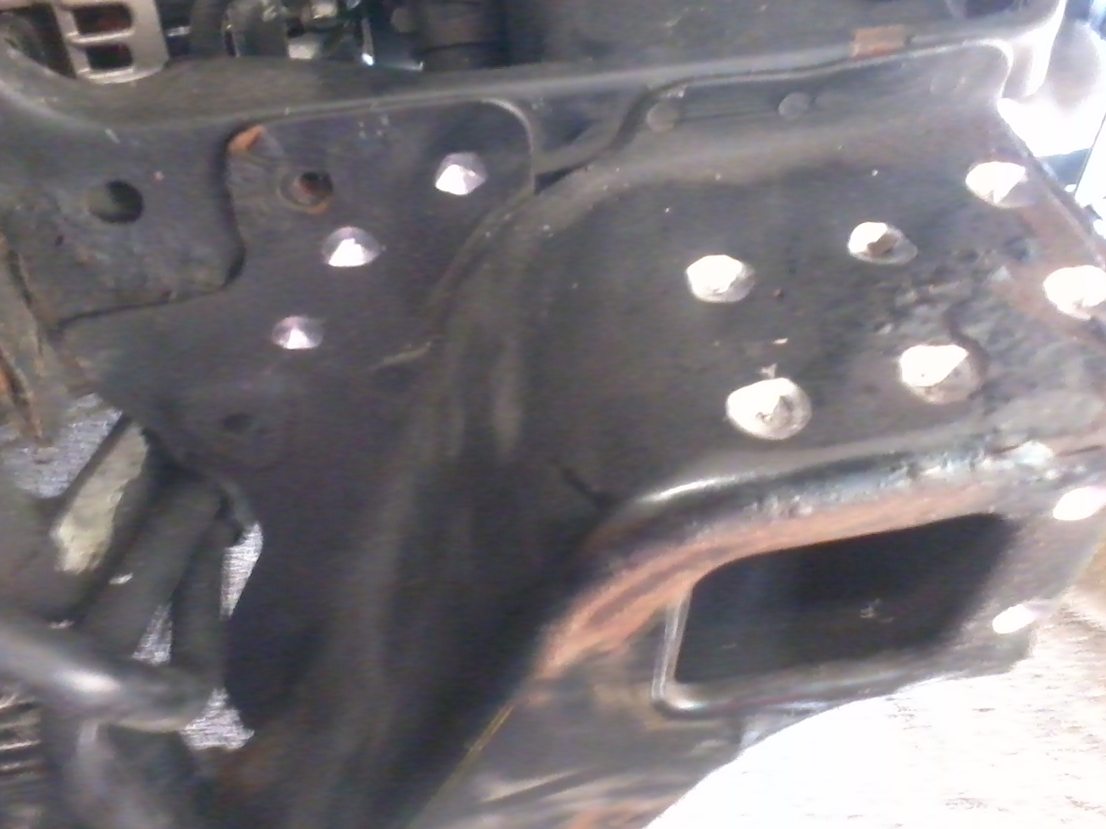

I officialy Parked The car the day after Thanksgiving since the roads were salted.

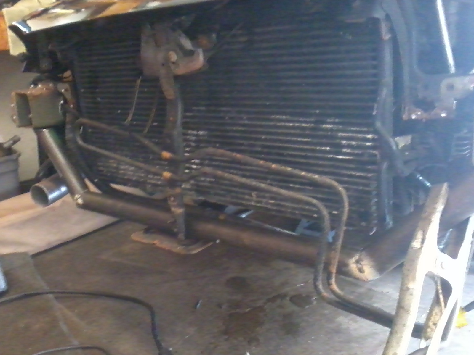

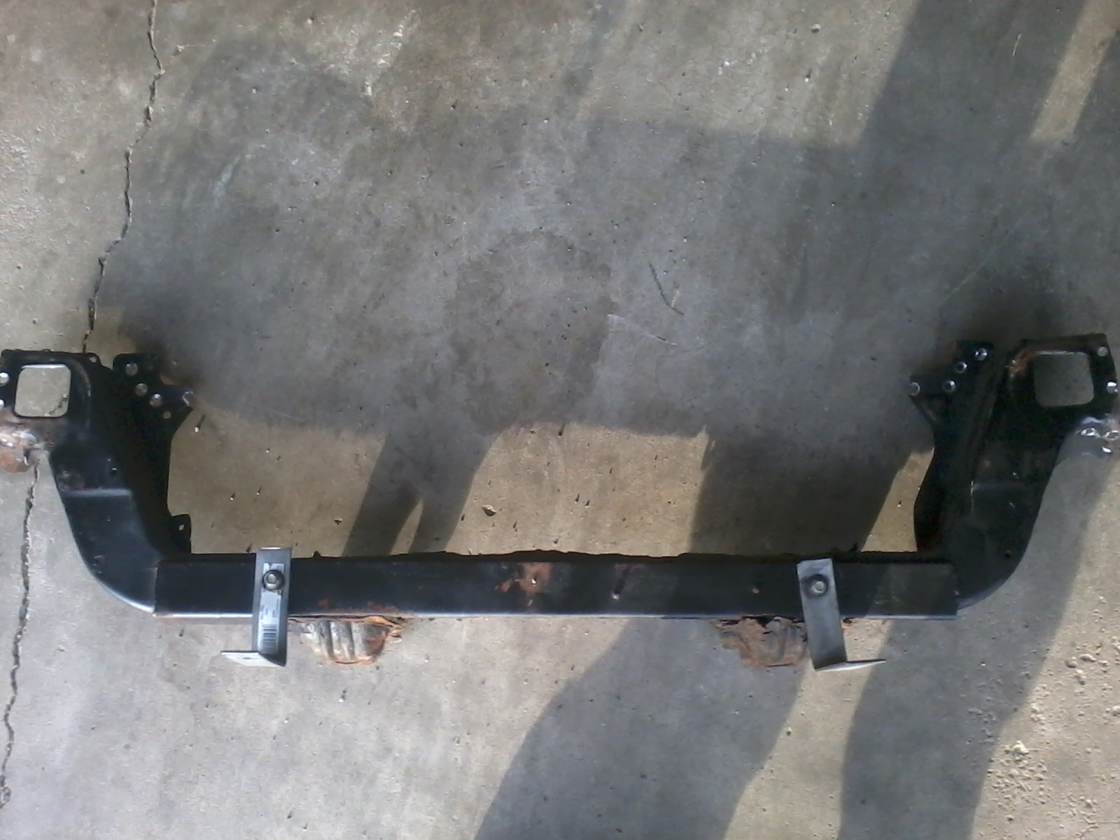

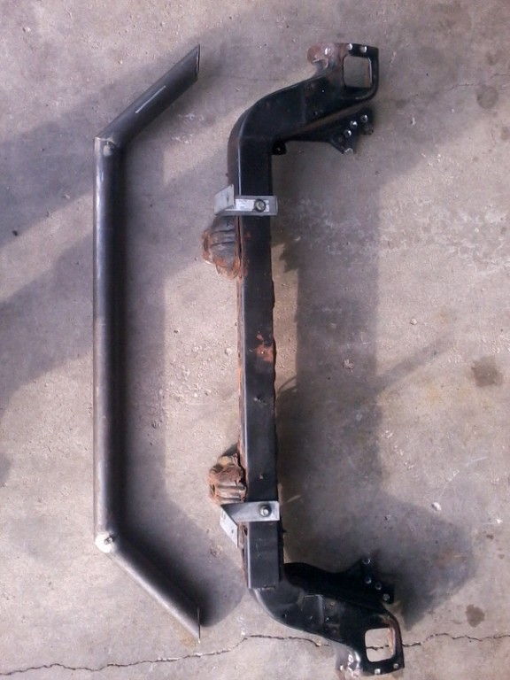

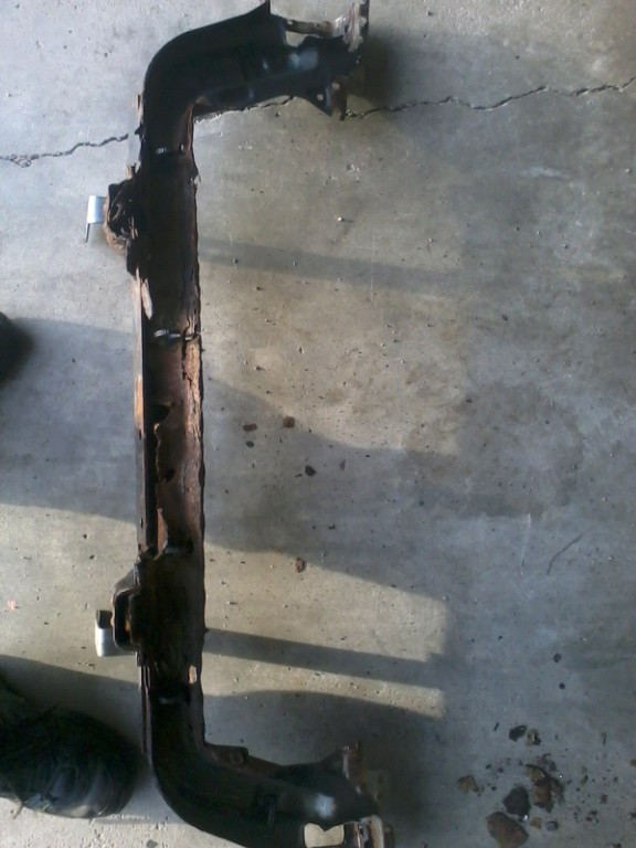

Today I had a few hours to do work on the car so I removed the rusty lower core support. So I can replace it with a tubular one. I removed the bumper cover, FMIC radiator, and head lights. Then I drilled out about 20 spot welds that hold the lower support on. after some pounding with my BFH and a chisle it came right off.

Damn, Cut the whole front end!
SO weight reduction is gonna be your special upgrade!!!
GOod luck
Part of me really wants to cut it off in front of the strut towers, but I dont really want to mess with the headlight mounting, hood latch, ect.
I think a tubular one might actually weigh more unless I go with lighter tubeing. But it will be worth it to have it solid again plus I plan on making mounts for the FMIC and mabey some tow-hooks.

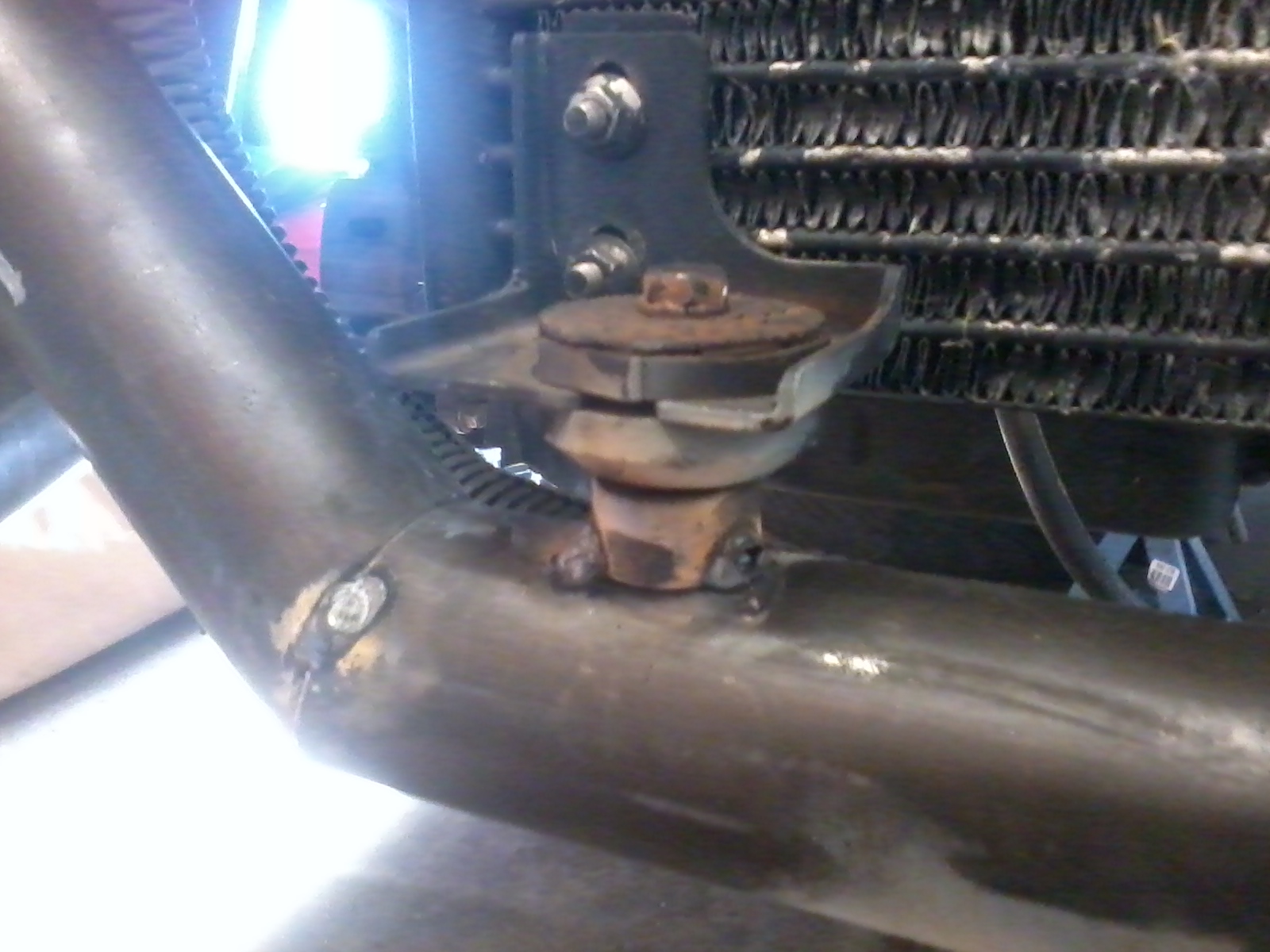

Old 11-29-2012   #119
carltalon
carltalon's Avatar
Location: Big Lake MN
Drives: 98 Eclipse GSX Auto
Posts: 1,516
Re: Carl's 98 auto AWD project Black Magic

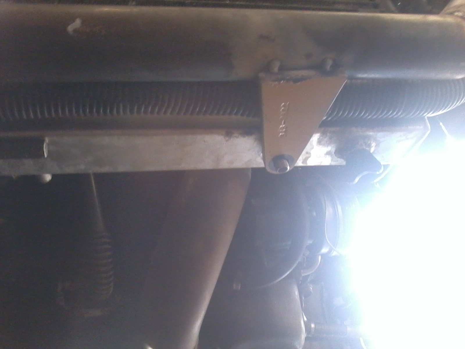

I tacked up the tubular core suport today. I made the lower radiator mounts from some lifting hooks we take off of engines at work and made some mounts for the a/c condensor. I am going to bring it to my Dads to weld it up with his MIG and drill the holes that will mount the North/South crossmember that runs under the motor/trans. Im not sure what I am going to do for FMIC mounts since I plan on upgradeing my Intercooler before spring.

Old 11-29-2012   #120
Picture 6 explains to me why you tackled this project!
